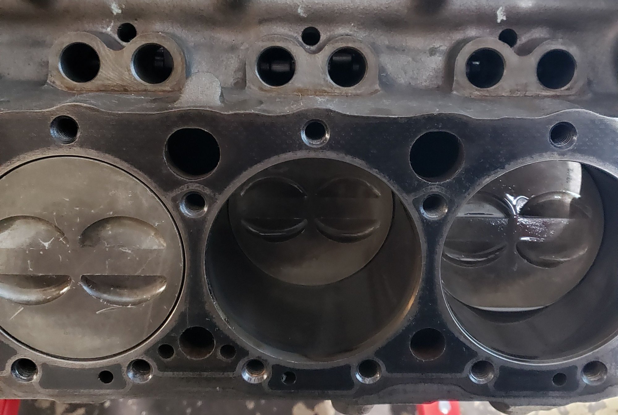

Budget L31 350s in 2023.
So I just want to say that a budget L31 is probably still the best HP per $$$ you can swap into one of these vehicles. I just built one on a small budget using a LT1 rotating assembly and upgraded the cam, valvetrain and to a ProFlow4 EFI. It did not go into a 3rd gen but did replace the 6.0L I had swapped in place of the OE 305 TBI. I have all of 2K into the engine from air cleaner to pan and water pump to flexplate. Shopping around, re-using good used parts and the Summit Bargain cave at the Arlington, TX store 20 minutes from the shop all helped the budget. This one is 10.2:1, has aftermarket Vortec castings cleaned up a bit with intake bowl, exhaust porting, chamber cleanup and valve work. LS6 springs and Comp 787 retainers. Jegs 1.6 rockers re-used from another engine I had. GM single roller timing set, Melling M99HVS oil pump and Milodon windage tray cleaned and re-used from the same engine. The cam is a GM 6492 and the LS lifters were torn apart, cleaned, inspected and re-assembled. Should be good for ~380 HP and 430 TQ at the crankshaft with the HP peak under 5,500 rpm. Just a good torquey, fuel efficient daily driver that has a little power. The 6.0L LS was a gutless pig unless you rung its neck with RPM. That was even using Lloyd Elliot ported 862s for more compression and a very mild truck cam with emphasis on low-speed torque.

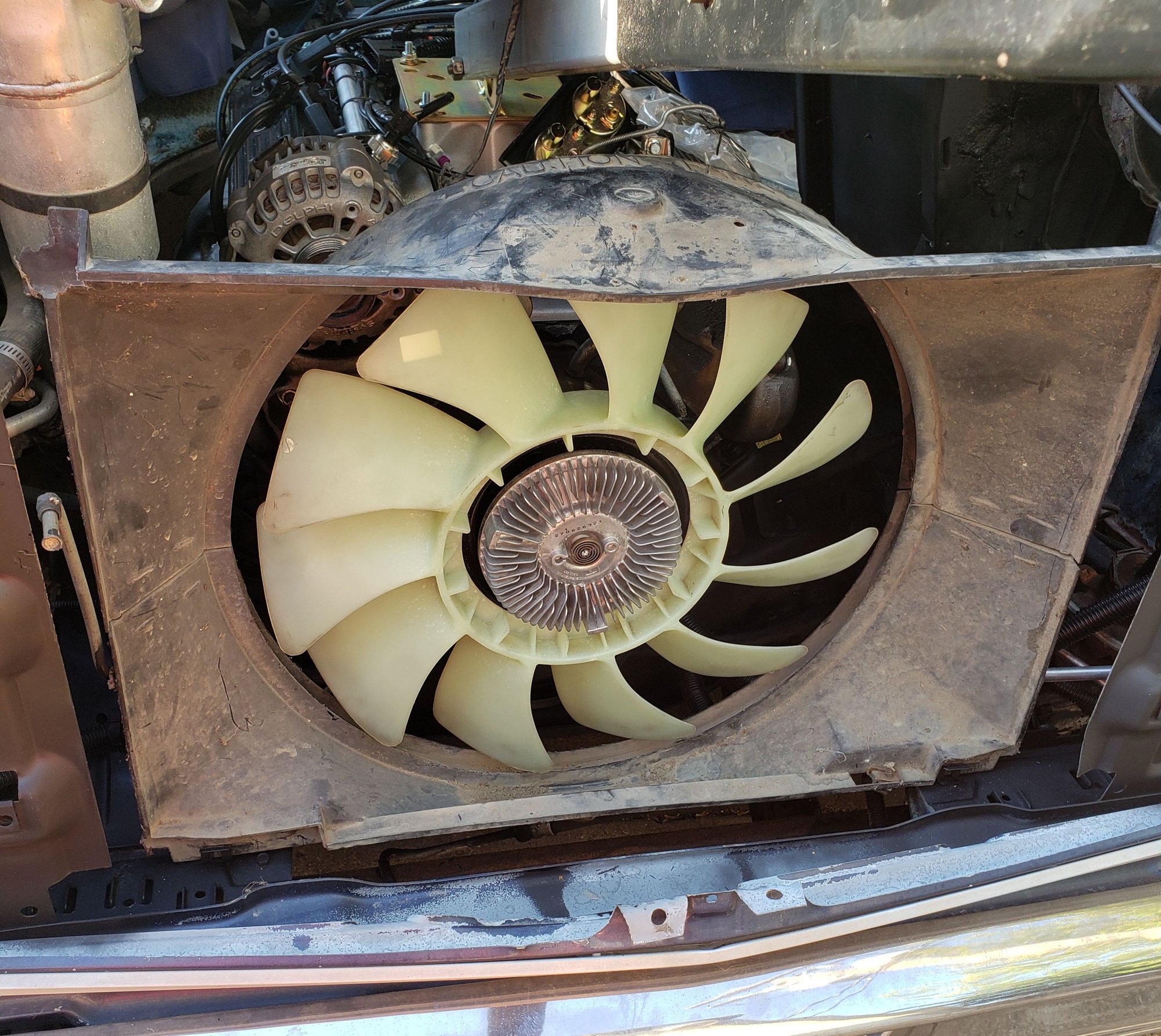

Here is the budget L31 in its new home. Even re-used the L31 accessory setup in this application to get a better, cleaner, more compact layout. The garbage R4 compressor also hit the scrap pile. The Vortec style Sanden or Valeo compressors are smooth, quiet and efficient compared to a R4. I am going to use the later style 105A alternator for now, but I have an AD244 that has a bad rectifier diode and the upgrade kit to make it 200a later down the road. I like the fact that very little has to be re-engineered for this swap as well, which makes it an easier swap for a beginner than a full blown LS swap where nothing fits correctly. I have played with a ProFlow4 on a C10 with a freshly built big block 496, hooked it up, ran through the setup menu, let the fuel pump prime, turned the key and it roared to life. Set the timing, then adjusted the screw on the throttle body to correct the IAC counts. Topped off the fluids, then took it around the block. After a couple of days of self learning off its wideband it ran as well as anything with OEM injection. At that point I played with the pump shot a bit to get a slight hesitation out of a WOT stomp and it was near perfect. On the chassis dyno we played with the timing curve and WOT total advance a bit, made a bit more power and played with the vacuum advance a bit to get the best cruise timing. I have ZERO doubts this 350 will be the same way. The 29 lb/hr injectors are good for way more power than I am making even with the 43.5 psi regulator opposed to the 58 psi regulator they offer for the same unit. The setup menu has configurations for both as well as for boost, if you can read between the lines on what this engine may get someday down the road. A small single turbo at 7-10 psi. I am doing away with the vacuum cruise control setup and have one of the OBS style Vortec electronic cruise control actuators to install.

Like I said this one is for a heavy cruiser though. It is even getting a clutch fan on it. In addition to cast iron manifolds and cats.
