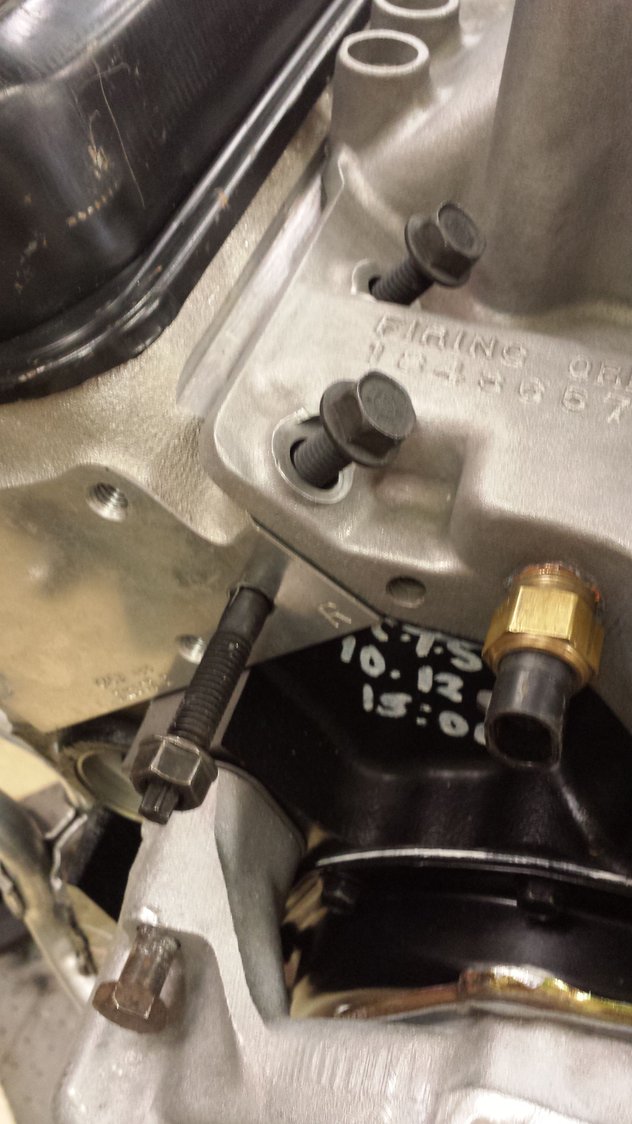

Btw, oil pan swap and new oil pump and pickup.
use the Vette intake and f body rails and accessories.
drill a hole and tap of passenger side serpentine bracket.

The hole you'll have to drill and tap on the pass head is the one closest to the stamped "R" on my head.
on the early 113 heads like yours, the bolt boss isn't very deep or even non existent so becareful
