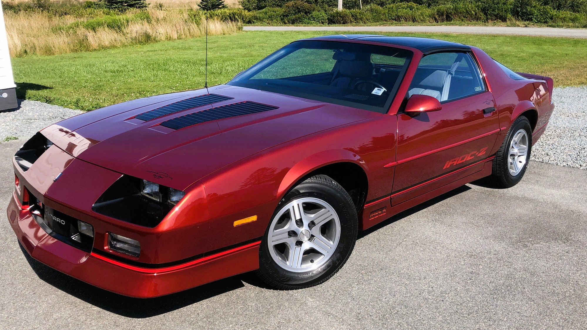

Please post a pic of your Trans Am
Thanks

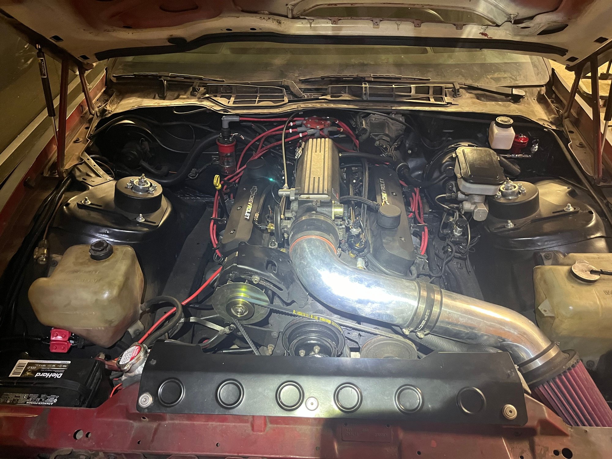

Old Jul 16, 2024 | 06:47 PM
SbFormula's Avatar
Joined: Jun 2012
Posts: 1,371
Likes: 196
From: Canada
Car: '18 Chev Camaro SS 1LE
Engine: LT1 6.2L
Axle/Gears: 3.91
Re: 383 TPI Swap Into 1986 Trans Am
Old Jul 18, 2024 | 07:32 PM

As far as pictures of the car, what are you looking for? The engine bay I assume, maybe the underside/trans tunnel?

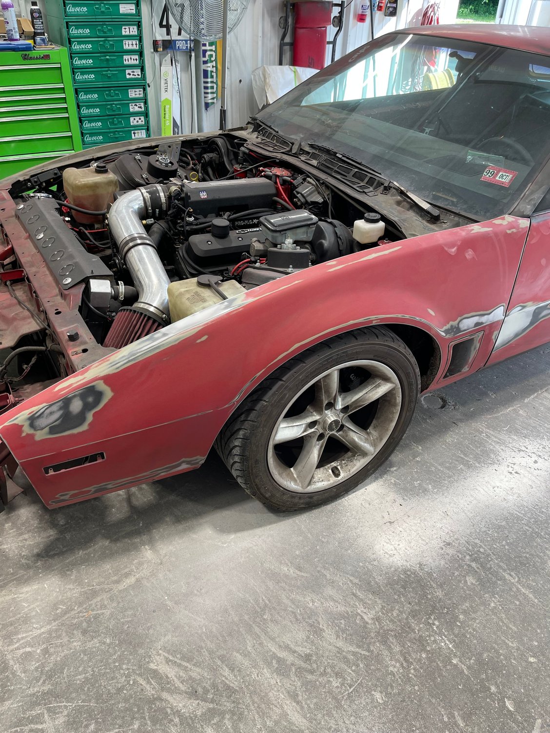

This is a 450hp/tq 350. It fits under the stock 82 TA hood. It's a pro flow xt. It rips and was pretty easy to install. The pics are while it's in paint. The hood closed fine. There's even room for a torque storm blower!
I agree w all the comments about the drivetrain and most intakes. I needed a hood scoop for the old 4 barrel style pro flo. This set up is tight but fit.
