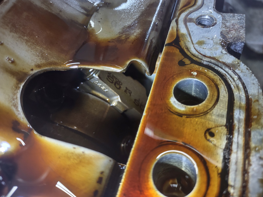

Thats a stock rod in an L33 I picked up. Full floating forged from the factory with a Gen3 411 harness which support 200lb/hr injector, flex, 3-bar, torque management, MLS headgasket, coil over plug

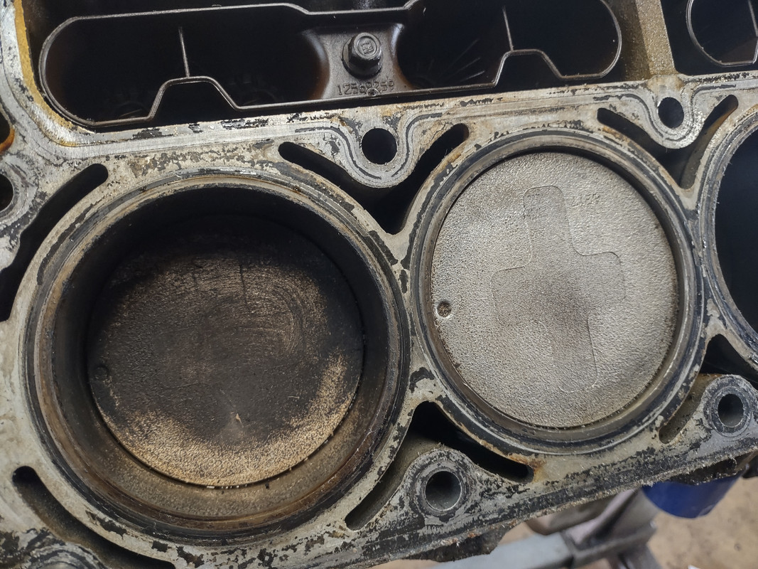

This is the stock 130k miles engine I just wiped pistons with a paper towel, no solvents
