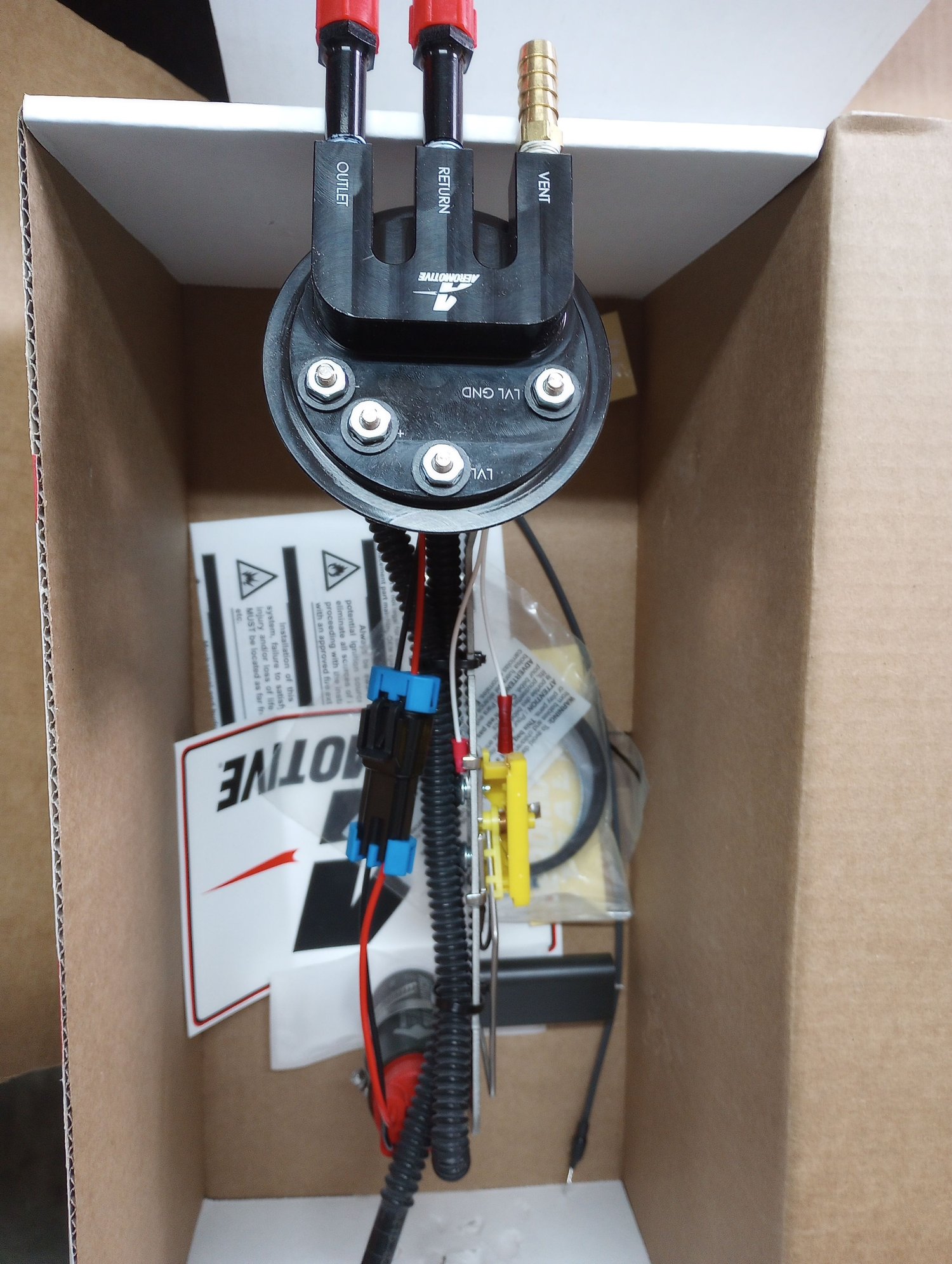

Aeromotive has a drop in unit. It works awesome in have the full stealth system in my TA. The bigger pump will supply at least 600hp. It works w a stock fuel gauge. You'll need to wire in a 30 amp solenoid and use 10ga wire.
IN-TANK FUEL PUMP & HANGER, 82-92 CAMARO
Part Number: 18071
Part Number: 18071
https://aeromotiveinc.com/products/8...47675268170028
I've got the bigger 340 lph pump going in my car eventually. It's a very nice piece if you don't mind spending the $$$.
Probably pretty overkill for a carb application though.
