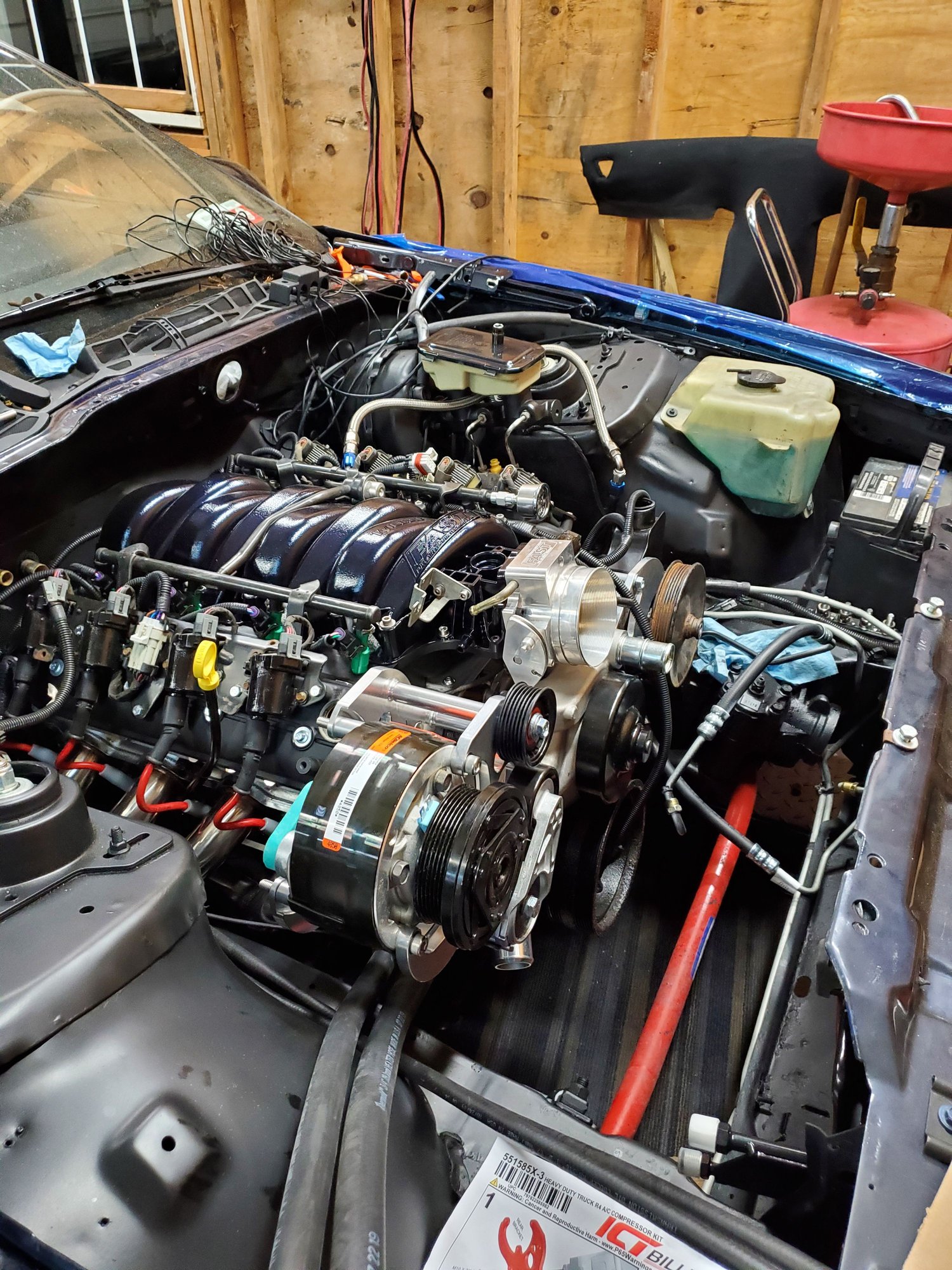

Depending on your plans for the build you can use the truck water pump, balancer, power steering and alt. You just need to buy the correct brackets from ict billet or the vender of your choice to rearrange the PS and ALT.
LS3 water pump is the same as truck spacing, Or you can run a water pump spacer with the cheaper fbody pump in truck spacing. This engine has the R4 ac compressor bracket in truck offset
Thanks punkmaster98 for your input! I guess costwise this would be the same, as the cheaper pump + spacer kit would be around the same price (or more) as the truck pump. However, the angle of the inlet/outlet neck seems better on the f-body pump. The fbody one sticks out 90 degrees (towards the radiator) while the truck one goes up (towards the hood) and into a 45 ish degree angle.
Maybe it doesn't matter at all?
Are either of the pics from your own build?
Yes these are vehicles I have worked on. Sometimes the owners will opt against my suggestion and go with a different option to stay within a budget. Will it work yes but for peace of mind sometimes the other option is better.
