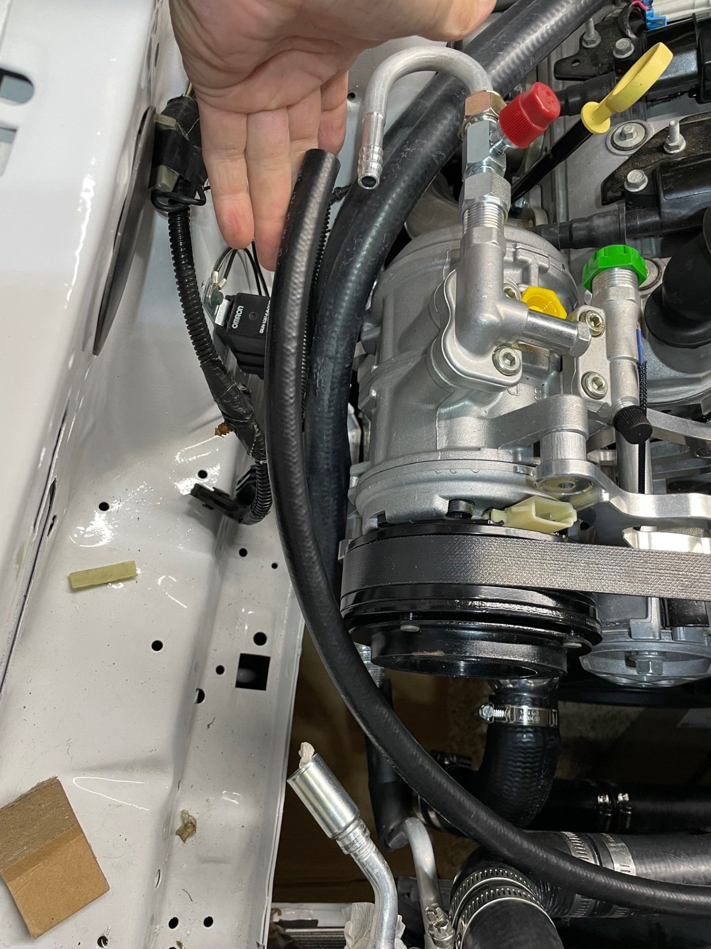

Re: LS1 A/C Yes or No
Originally Posted by upstateRich
My car has an A/C setup in it now from the factory I just am not sure on what will work with a new compressor. I already installed a new ATI damper and it has the inside pully for the lower A/C so I am committed to this location. Would I need to change the condenser and other parts if I went with the new refrigerant?
My Mustang's damper also has the inside pulley but I did't use it. My AC compressor is high mounted. You are not committed to that lower location, either.
