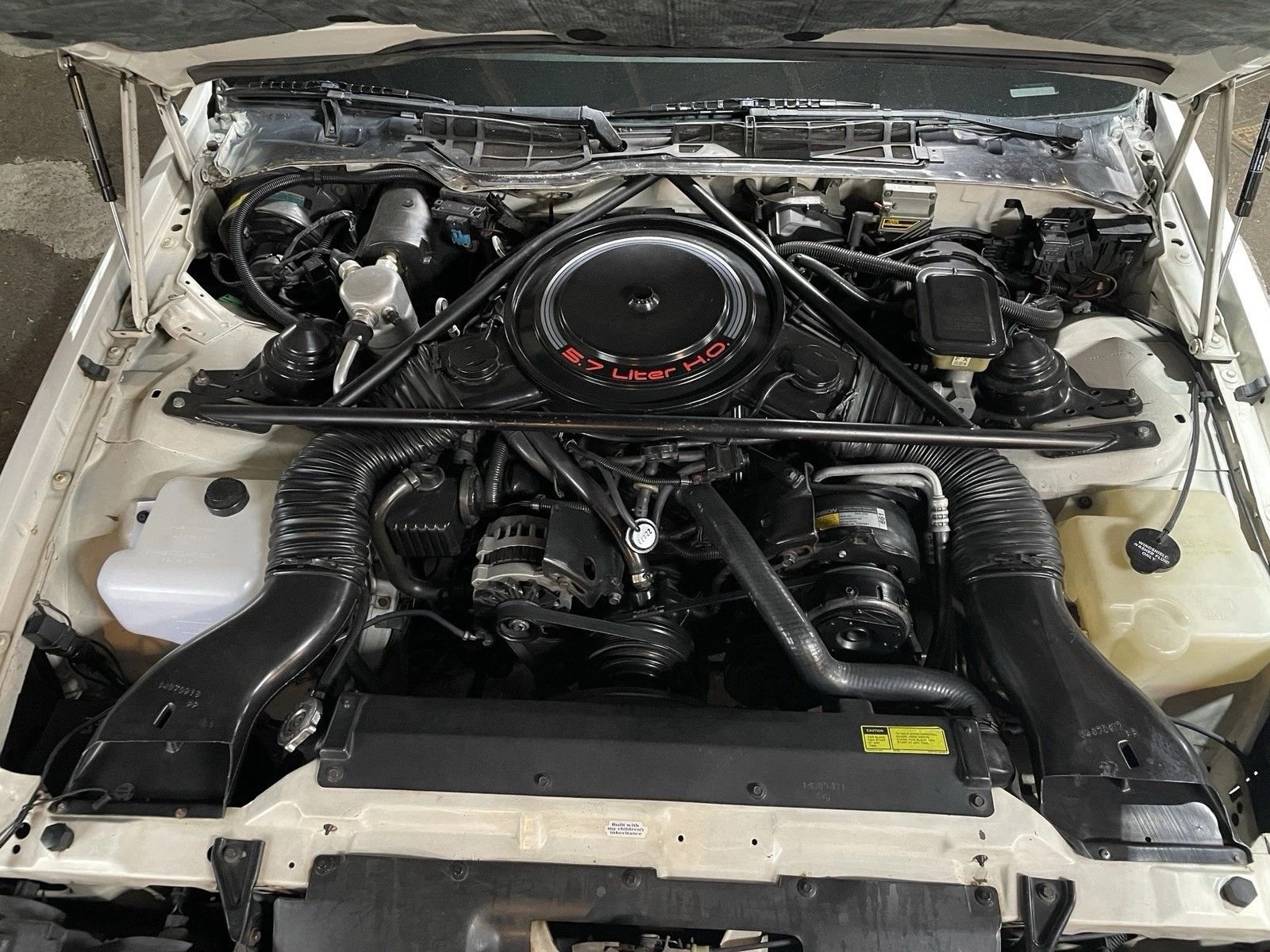

If you are wanting to do something that is mostly stock appearing and is period correct appearing, I'd try to build something in the spirt of the Chevy Race Shop ZZ3/ZZ4 350 H.0. Camaro engine conversion kit for 1982 to 1987 LG4 automatic and 1984 L69 automatic Camaros.
A much better intake manifold can be used than your factory GM intake while still being stock appearing.
None of your stock LG4 exhaust system can be retained. It sucks so bad there would be no reason at all to do anything else if it had to be retained.

This is what it would look like under the hood.
As installed in a 1987 Camaro
