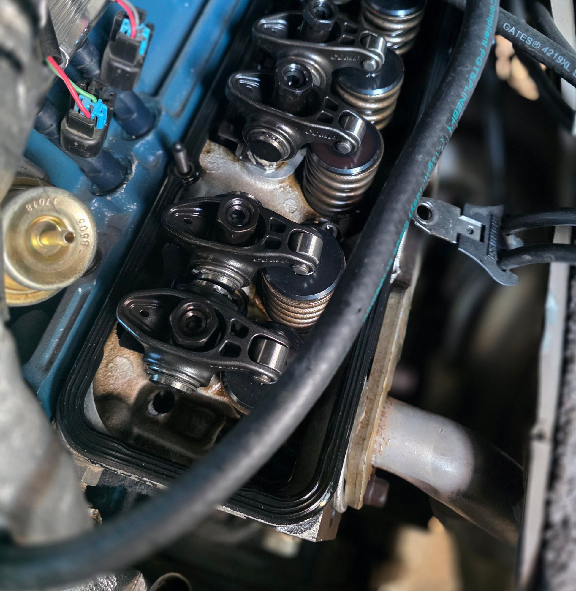

Not to hijack the thread, but do roller rockers fit under stock valve covers?...

Originally Posted by Firechicken82
I couldn't tell you about any power/drivability feel because I did them w a full top end and efi system.
When Engine Masters did their rocker test, the gained essentially zero, going from stamped rockers to rollers.
I have ran aluminum body roller rockers under stock 'Vette valve covers, with the "oil tabs" broken off for clearance.

My RRs just barely fit under my aluminum proform valve covers. I had to do a little clearancing. My proforms are larger than stock covers.
I wonder if there is any measurable difference w RRs. Oil temps/measurable friction? I doubt it. Obviously ratio changes aside. Between my blue beehive springs and machined RRs my valvetrain looks very fancy. So at least I have that going for me!
