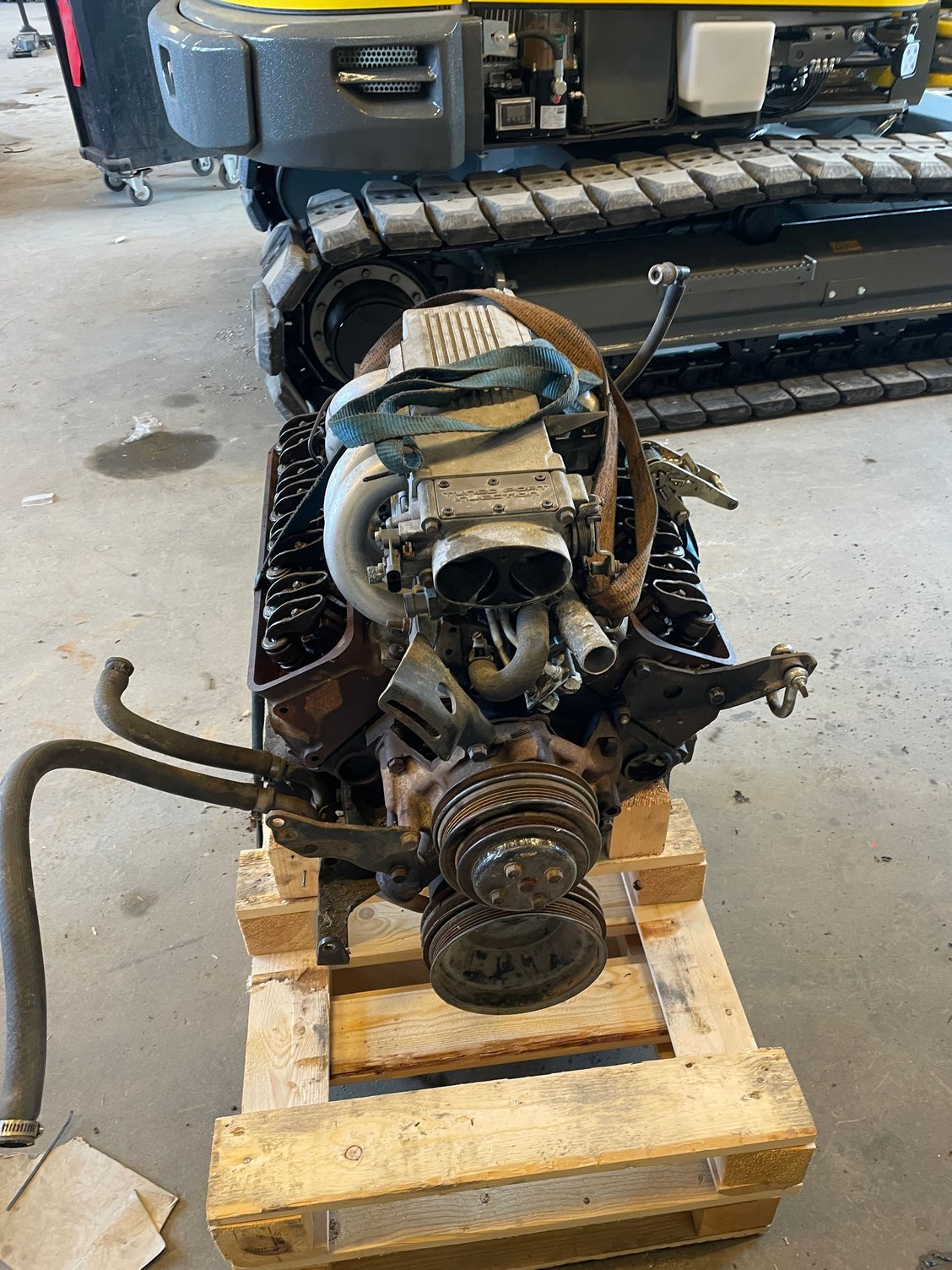

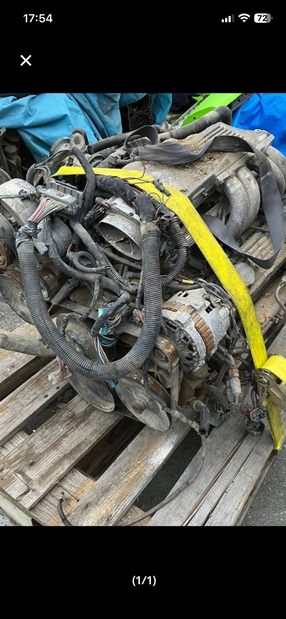

Old May 20, 2026 | 02:04 PM
Swedish_iroc's Avatar
Joined: May 2026
Posts: 4
Re: 87 305 tpi to 91 350 tpi
The old rusted engine
Also the old engine
Also the old engine
The replacement motor problably going to open it up and check the condition atleast its not had water up to the pistons..
Old May 20, 2026 | 02:37 PM
Tuned Performance's Avatar
Community Influencer
iTrader: (95)
Posts: 16,888
Likes: 1,013
From: Mile High Country !!!
Car: 1967 Camaro, 91 z28
Engine: Lb9
Transmission: M20
Pull the spark plugs, use a scope and look at cylinders. Can also prime the oil pump and lube down the cylinders and do a compression test.
