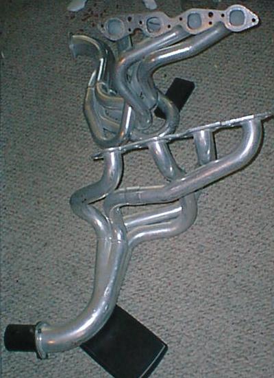

IIRC, the 396 wasn't available in a Nova until about 68. That only means anything if it's the original engine. The problem that you incur when putting a BBC in a third gen is exhaust, it becomes a major pain to route it in any conventional manner and the Hooker headers make it all but impossible to route it in any fashion that remotely resembles normal.
If you want to get an idea of what I'm talking about I can get a pic of my headers while their out of the car so you can see.

yea that would be great if ya could get a picture of ur headers. also is there really anything that would get in the way or be a problem besides maybe the distributor which i already know about. but like is there any thing else i should really know?

As you can see in these pics clearances are tight and the dent in the 5 primary is there from the factory to clear the steering shaft.

There's a pic on my page looking under the car from the front. You can see how the headers fit. These are the Hooker SuperComp headers. Depending on what sub frame connecters you use, they may not fit. The headers come out at the rockers right where the SFC attach. My SFC are mounted a lot more on the inside so I don't have a clearance problem.
