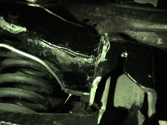

Does anybody have a Spohn T56 tranny x member and y pipe pic? Most of the pics are autos and the others dont come up.I had to make my own Y and dont like it.Tooo low to the ground for me.Nobody seems to have a nice 3" Y for this setup w/ 2210's. PLEASE help?????????
Attached Thumbnails Notes on Installation of Hooker Long Tube Headers (2210)-pass-side-y-pipe.jpg

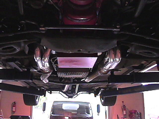

Old Jan 23, 2006 | 01:58 AM
  #279
Joseph Andres's Avatar
iTrader: (6)
Joined: Oct 2000
Posts: 663
From: NJ, USA
Car: 1991 GTA Convertible
I just got done installing the 2210's and Mufflex Y-pipe today, and I must admit, no real problems at all. Setup is angle plug AFR 190's milled to 58cc, new stock rubber engine mounts
Driver's side:
Remove motor mount bolt, jack up engine about 2-3", slips right in from bottom. Removed spark plugs, oil filter, pressure switch, oil cooler delete. Relocated knock sensor. No grinding necessary. Bent brake line to clear #1 primary.
Passenger's side:
No jacking up at all. Removed spark plugs. Slips in EASILY from bottom (I guided the header flange behind the automatic transmission's bellhousing to get it up there). Already had CSR Mini Starter which cleared perfectly. Fire sleeve protected starter wires. Bent brake line out of the way. Only grinded top corner of K-member to clear #8 primary slip tube as shown in Traxion's pic.
On a lift it took about 6 hours to complete header install (THANKS TRAX!!) including removing SLP shorty headers and y-pipe.......PITA!!!!!
Mufflex Y-pipe #TPIY-O2:
I installed the y-pipe without having to cut or weld anything. I used their supplied band clamps and no leaks. Ground clearance is good. I'll have pics of the y-pipe installed soon. Now just waiting for the 4" Mufflex.

Originally posted by drex
ok i just read all 4 pages...great thread here.. i have 87 firebird with retro 350 carbed non computer control engine mild cam ..and t-10 4 speed with manual clutch linkage from a 82-83 camaro/bird... 3 questions that didnt get addressed......
1 .. do they fit around manual clutch linkage (z-bar on pivot ball on engine?
2. will they work with a 168 tooth flywheel and mini started (hitachi style starter)
3. i have moroso solid mounts...will they fit easier or harder?
i have cheap hedman shorties and 2 1/2" y pipe now and i think there killing me, y pipe runs into 3" hi flow cat and 3" flowmaster single cat back system..
should i just buy this mufflex y pipe with the 2210's and hook it into my flowmaster cat back. does the mufflex y pipe dump out in the stock location
1. I'm not sure about your app. but here's a pic of how it fit around my 700R4
2. I don't see why they wouldn't fit with a mini starter.
3. With solid mounts you may have to do some clearancing around the K members on both sides like in Traxions pics (if the solid mounts sit higher than the stock mounts)
The Mufflex Y-pipe routes to the stock location but you may need an adapter that is available at www.mufflex-performance.com
Attached Thumbnails Notes on Installation of Hooker Long Tube Headers (2210)-exhaust-011.jpg

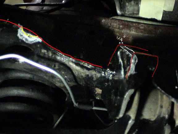

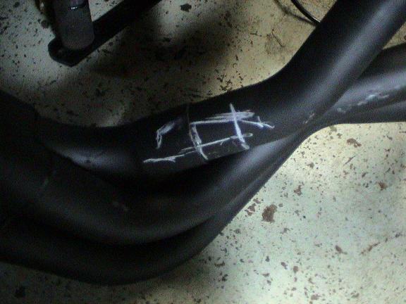

Has anyone seen this before?
I attempted to switch from the Hedman shorties to the Hooker 2210's and the # 8 pipe contacts the A arm at a different location than expected from all of the reading I have done(Including this thread). I took some pics to try to show what is involved.
I'm at a loss on what to do. It looks like I either cut 1/4" out of the corner of the A arm mount which would probably cause it to fail. Or dent in the #8 pipe at the slip tube location which would not work very well either. The tube has to be removed to install the header so I'm kind of in a bind.
Has anyone run into this and do they have any ideas?
Most of the pics are self explanatory, but it was a little difficult getting good images. Sorry about the quality.
Attached Thumbnails Notes on Installation of Hooker Long Tube Headers (2210)-sm-5-14-06   Notes on Installation of Hooker Long Tube Headers (2210)-sm-flat-front-surface   Notes on Installation of Hooker Long Tube Headers (2210)-sm-clearance-issues-bottom
Old May 14, 2006 | 08:16 PM
  #296
Scorpner's Avatar
Joined: Sep 2004
Posts: 2,069
From: MN
Car: 85 SC, 86 Berlinetta
Engine: V6, V8
Transmission: 700r4, 700r4

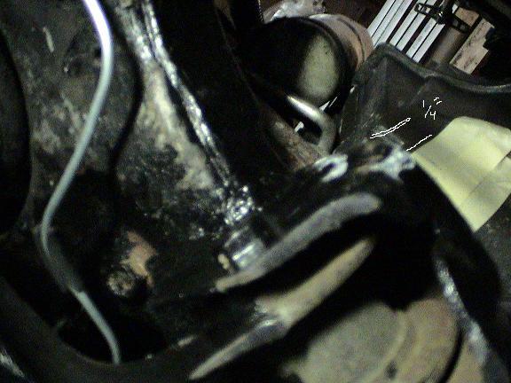

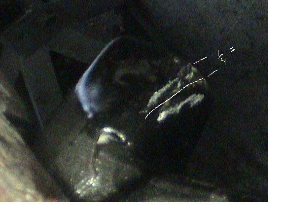

Here's some more including from the top and the slip joint. . .
Am I the only one that's seen this?
Attached Thumbnails Notes on Installation of Hooker Long Tube Headers (2210)-sm-top-view-arm   Notes on Installation of Hooker Long Tube Headers (2210)-sm-hooker-contact-point   Notes on Installation of Hooker Long Tube Headers (2210)-sm-side-veiw-slip

Old May 16, 2006 | 10:21 PM
  #297
88 350 tpi formula's Avatar
Joined: Dec 1999
Posts: 3,544
Likes: 19
From: WI,USA
Car: 89 FORMULA 350, 91 Z28 Convertible
Engine: ls1, LB9
Transmission: t56, Auto
Axle/Gears: S60/ 3.73
what heads and motor mounts are you using? original v8 car? was it ever in a crash? like 90% of thirdgens mine is close but it does clear. I belive the whole member can be moved some? but I can't say for sure anyway let us know what you find
Old May 16, 2006 | 11:20 PM
  #298
Scorpner's Avatar
Joined: Sep 2004
Posts: 2,069
From: MN
Engine: V6, V8
I'm using the poly inserts and I have Dart heads but the engine builder never gave me a build sheet. I haven't heard back fron Dart yet, but Hooker basically washed their hands of it once I told them about the heads and inserts. The inserts are actually helping in that the headers would be farther down into the A-arm mount and the back of the K member crossover section. I would think they would try to save the sale, especially at $400, and I've never seen any disclaimers saying they only back it if everything is completely stock. So now I'm stuck with the shipping charges just to find that out.
Here's their response:
These headers are designed for factory port location and factory rubber
mounts. The heads could have raised ports and the poly mounts are not
settling enough.
At least they replied. If I had the stock inserts, they wouldn't fit in there at all. So they basically just blew me off.
Both parts that interfere are within the K member, and I don't think it's ever been in an accident.
I did hear from someone with something similar, but not as bad. They said I could try loosening the motor mounts and try to shift it over but after Hookers lame response I'll be returning them and letting Summit know why.
