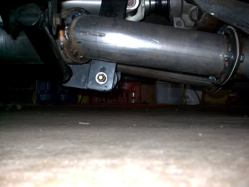

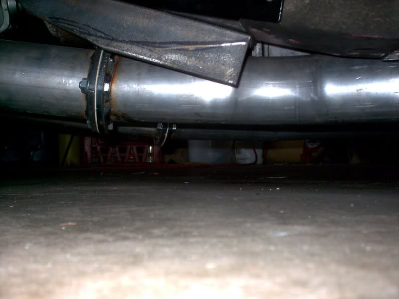

I finally have my true duals finished on my formula, I used Heddman S-bends, going into a a h-pipe, then 35" back, the 2.5" bullet mufflers, then some dumps, right before the sway bar, check it out.
Then I painted the rear axle, right now I'm still working on installing the rear Spohn Lower control arm relocators, then the Lakewood control arms. I'll put ina Lakewood panhard bar later.
The cars making so much torque right now, with the car up on the jackstands; while I am idling, with the brakes all the way to the floor, the rear tires are still spinning. I have to turn the service/parking brake on, then it barely stops them from spinning.
my site: www.cardomain.com/ride/471099
Check it out, I'll take a video of the sound of the exhaust soon too.

Why do u want 1 7/8"? What motor are you gonna build exactly? The ground clearance with 2210's is great, they never touch anything, close to the brake line on the front passenger side, I just put some flameproof shielding on it. I don't even scrub/bump my h pipe anymore, I mean that would rarely happen. I've driven my car a lot lately in this 32-50*f or weather, theres no salt on the roads, and I wanted to drive it; with this cam & Ed Wright tune, my cars streetable as hell, gets decent mileage, and I have my propane heater lol.
As far as ground clearance, this isn't your beater or economy shitbox, its our pride, joy, and for some, our passion. U should already drive around pot holes, go slow over big bumps, etc...
Oh yeah, I was in aurora il, and I wasted a brand new 2010 SS camaro, that was great. I blew him away from the start, then like a bitch, he just turned off into a sub devision, like wtf man? What a bitch, lol.
