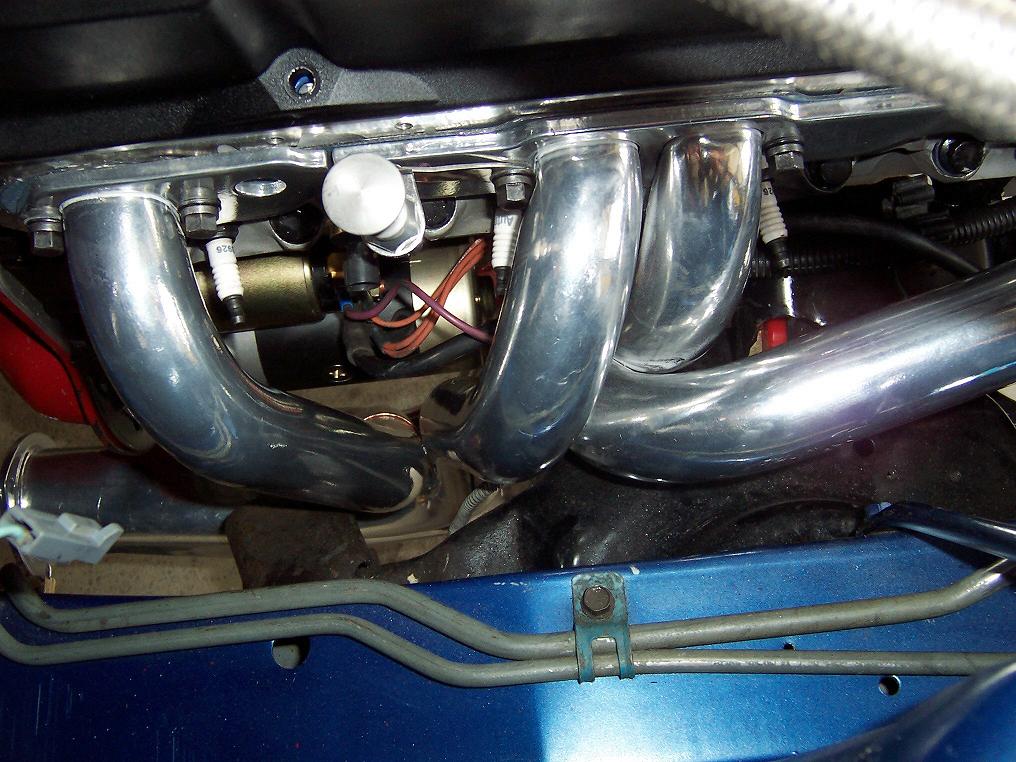

i remember that..good stuff... so what if i installed the long tubes and went to mufflex had them put on the y-pipe and the same 4" back...what would it cost with install at mufflex?
Old Apr 16, 2007 | 09:17 AM
  #325
Joseph Andres's Avatar
iTrader: (6)
Joined: Oct 2000
Posts: 663
From: NJ, USA
Car: 1991 GTA Convertible
Re: Notes on Installation of Hooker Long Tube Headers (2210)
Personally I would try and save some money and do it all myself.....The Mufflex Y bolts right in and the rest of the exhaust (if you order from mufflex) is also straight forward. The only reason I drove to Trenton was to have them custom fit the muffler I provided.
https://www.thirdgen.org/forums/atta...xhaust-007.jpg
https://www.thirdgen.org/forums/atta...xhaust-003.jpg

I put my 2210's on today and I was quite disappointed. To start with, the first set I got was packaged like crap and were dented. So I sent them back and these were fine. So during the install, I had to clearance the driver's side where Traxion did, which was fine. I also had to clearance the passenger side where it was hitting the slip sube. No big deal, since I was expecting that. But I also had to clearance the passenger side where another primary was hitting the crossmember. And after all that, I even had to file some of the bolt holes in order to get them to properly line up.
I used a ministarter, new motor mounts and I did not have to move the motor at all. They both went in pretty easily from the bottom after removing the oil filter, oil pressure sending unit and the starter. I cannot comment on plugs and wires yet since they are on order.
Attached Thumbnails Notes on Installation of Hooker Long Tube Headers (2210)-clearance.jpg

Hooker's quality has gone down. They are made cheaper, more smashes in the mandrel bent tubing, cheaper packaging, more dented headers that you get shipped, it is disappointing. I have my fourth set in my car now, imagine how angry I was. I had to clearance my control arms, by cutting two triangles out of each one, and my first set, they didn't even finish drilling the holes in the flanges, for the bolts that go into the head. I wound up using my factory starter, they do fit, but a mini starter is easier to put in or an Lt1 starter.
I wish I would have used solid motor mounts, for more clearance, but mine are ok. Raising the motor did help put in the passenger side, but the oil filter, pressure sender had to come out, and the bolts for the oil filter holder, that's attached to the block, what did you do with yours?
I have plenty of clearance for the plugs, but my heads are angle plugged heads, I will probably start my car thursday or friday, I have pics on my cardomain site of the plugs, check 'em out
