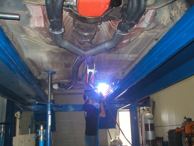

The y-pipe has not been started yet. I plan on getting started on building a custom crossmember later this week that will make as much room as possible for the Y-pipe and then taking it to a local guy that has been well recommended for the Y-pipe construction.
I will try to get some pics before the week is over and for sure after the Y-pipe is done.

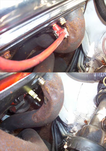

Passenger side hits LCA
As Traxion and others mentioned before, my Hooker LT hits in the exact spot as photographed by Traxion. (passenger side)
Well, my question is.. how much clearancing is TOO much clearancing - that you start to affect structural rigidity ???
I clearanced the exact spot that was photographed..but by clearancing, I first cut 1 inch rectangle, then 2 inches, now it is almost 4 inches of a rectangle that I have clearanced out of the LCA area (like the photo shows) It seriously won't fit otherwise... motor mounts have like only 8k miles on them... (It is just the standalone #8 cylinder pipe thing that hits)
I'm wonderng how that will affect strength and such??

Before you get to carried away on grinding the K-member down to nothing for clearance, dont forget how effective a hammer is.
I did quite a bit of grinding and then called it quits and lightly dimpled the #8.
Just mark the spot that doesnt clear with a felt pen and then slightly dimple it with a hammer, it is helpfull to put a thin rag on the #8 as to not ruin the ceramic coating.
Dont foget to get some Ultra Copper RTV around that #8 before you slip it in permanently.

OK, got a digital camera for Christmas (yeah!
) so I shot a few of my Y-pipe and how low my collectors ended being (very
, but then again, so is the SFC X-member as you can see). You can see a little bit of my custom fabbed T56 crossmember too. Check em out:
It's 3" and it has the rear collector flanges for facilitating pulling the trans and not having to take the entire exhaust system off the car to do so.

I have to say, mine hangs pretty low, but since the addition of new shocks, i never hit on anything anymore... altho, granted, my car is not lowered...

Yeah, that's the Pro Kit... I took a little off the front springs though so it is maybe 1/8" lower in the front than a stock Pro Kit.
I can't get a decent side shot of the car right now because it is in the garage but there are a quite a few different pics on my site of the car (see link in sig).

Heres a shot of how horrible my #7 spark plug interference is with Vortec heads. I'm running a shorty plug and have a huge dent in the header tube and the boot still touches it. I put like 5 layers of heat shield tape on it ...boot hasn't burned yet but I still check it every time I pop open the hood.

wow thats tight spot there, i got stock straight angled plugs and i made my own shorty plug out of an ACdelco plugs and i have great clearence around my number 7 tube.

where, i cant see it
just put on my driver side, with the oil filter, pressure su, and slave cylinder outta the way, motor jacked up, it slipped in easier then my hedman shorty did. with my stock heads, accel header plug, accel wires, ive got about 1/4 of clearance. ill take a pic later
just put on my driver side, with the oil filter, pressure su, and slave cylinder outta the way, motor jacked up, it slipped in easier then my hedman shorty did. with my stock heads, accel header plug, accel wires, ive got about 1/4 of clearance. ill take a pic later Junior Member
