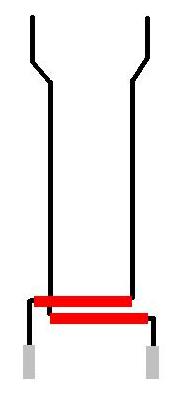

well i decided that if i cant buy dual exhaust for my 84 z/28 then i will make my own design and have the muffler shop bend the pipes for me, this is just a ruff sketch so dont laff, but i think its a really good idea, leave some feed back for me thanks

why not just have the exhaust shop run side-by-side duals in the stock location?? it will cut down on clearance issues. if they say they can't do it, find another exhaust shop. mine has done it for me four times over the years.
u guys, i know that the pipes are straight but yes the shop will do all the correct bends and twists, so dont think that i would do it EXACTLY like the picture that i drew in like 1min, its just an idea for the muffler situation, since ground clearance is a big issue, i would have the glass packs in the stock muffler location but have them like that with dual 2½" pipe
Unless you like replacing things, go with a tubular muffler like the hooker elite stainless, hooker header mufflers (you can easily modify them for your application), stainless specialties (hot rod exhaust company, www.stainless-specialties.com) 4" diameter muffler, borla XR-1 race bullets, dynomax bullets, etc. I have never seen SLP resonators, but it from what I have heard (unless I'm just thinking of something else entirely), they would fit the description.

hey guys i was thinking about this, what would happen if you could somehow get steel bent, made, etc, etc whatever, that would be square, square intermediate pipes to the rear that would hug your underside because then you wouldnt be scraping, just an idea i had before...

That drawing looks just like a true dual setup for a 1st gen. They have kits with those single glasspacks. Good luck getting them around the panhard bar!
