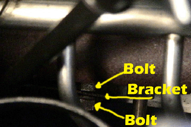

I've used about half a can of blaster on that nut, no luck. I think if i can bust the bracket i can get the whole thing out of the head like that. Im dumpin AIR, and i just took that big silver AC thing out today. here is a pic of that bolt, if anyone has any ideas how to get that bracket busted or how do you take the dipstick tube out? will it just pull up and out?
-chuck

Old Mar 1, 2004 | 09:32 PM

The metal tabs that are wraped around the bolt...bend them over somehow. also that metal heat shield just try and bend it out of the way or rip it out of the way, you wont be using it anyways. The last bolt I got from underneath and also from the top...I used one of those angled open end wrench. Just keep at it, Its a pain but you'll get it...

pb blaster is the best for gettting out rusted bolts. i use it everyday and it gets my job done quicker

It just takes patience.
Try taking a cheap wrench the same size as the bolt...should be 9/16 on stock exhaust manifold bolts...
Cut the wrench down , and grind the end smooth so it won't slice your finger.
For stuck bolts that you have a little more access too, if soaking it with Blaster hasn't worked...
Get a small pipe wrench....if there's room enough to turn it, it will grip it.

I got the last bolt on the passenger side from under the car. After I had pryed the metal tabs off of it I could reach up with an ipen wrench and get it a quarter turn at a time. When that was the last bolt left I just yanked on the exahust manifiold and moved it up and down and srpayed that bolt and it eventually started to work itself out. Not the best way to do ti but it worked. As for that metal shield that gets in your way. I yust yanked and yeanked on it util a chuck of it ripped off. I was getting so annoyed at it I got violent and just detroyed it.

Dont forget to get the metal tabs out of the way, Those last bolts are mother ****ers to get out, Use a wrench not a wrachet because it will never work. Use a screwdriver to bend back the plates because that is what is making them not turn. Also, there is extream heat coming from the engine and those things get coked on. Use like WD-40 for 3 days, then do it, they loosen up after while, try all of these things.

Well i WD40d em up days in advance and they came out no probs at all. Now the only prob seems to be how to retighten the pass side rear bolt, and that i hafta take the drivers side header off to drill out the hole for 02 sensor, my mistake
