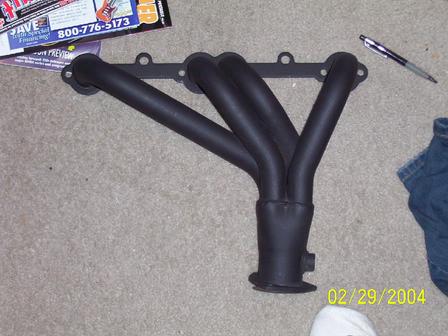

these are my headers...one sanded and painted one not...and dont know what company these are...cant find pics anywhere of them, and need to buy a y pipe for them.

passenger side

i deffinatly think thos earent from the same comp...

Look like the same company to me, based on the flange.
But, not sure what company that is. What is the OD of the primary pipes? If 1-1/2", I'd guess Flowtech. If 1-5/8", then I don't know, because they don't look like Hedmans or Hookers.
I don't recall seeing that #6 pipe routing. Perhaps we can get someone to chime in that recognizes it.
Good luck finding a y-pipe if they aren't Hedmans or Flowtechs.

those are flowtech's headers. i think they are a waist of time and energy though with those little bitty 1.5" primaries.

Those are deffintely not flowtechs. Flowtechs don't have the ball flange collector or the little loops on the flange. My geuss would be hedmans, but I didn't think they had that type of collector. Did you happen to measure the primary size?
I forgot to mention, are you sure that they are for 3rd gens?

3 inches is the outside collector diameter. and 1 3/8 is the smaller tubes...measured at the part where they touch the heads.
What is the inside collector dia? I cannot think of any header with 1.5" primaries that would have a 3" collector and not 2.5". Are they a truck header?
I don't see any ball flange there; headers are like Flowtechs which I've sold before even putting in my car - like five7 said, this #6 pri routing is kinda charakteristic and you'd have trouble finding any other brand with 1 1/2" primaries (ouch...)
Well your right in that it's not a true ball flange but it is a tapered flange with the floating collector plate design. The flowtechs that I have just have the generic old flat collector with no tapering at all. It is a leaky situation. Also my Flowtechs do not have that type of flange. It has reliefes cut into it and does not have those loops on it. The only other 3rd gen headers that I can think of that have a 1.5" primary would be the dynomax, or summit headers. However, the summit ones are flowtechs that are just renamed. I am wondering if they are not 3rd gen headers to begine with. If they are flowtechs, they are not ones for a 3rd gen.

inside diameter is a hair off of 2.5 inches....i do not know anything about these headers, as they came on the car....the guy didnt tell me, and hes in the army now, so i cannot contact him. I doubt they are 3rd gens...cuz he put a carbed 350 in it in place of the 305 tpi....anyone else know???? I am desperate to find out

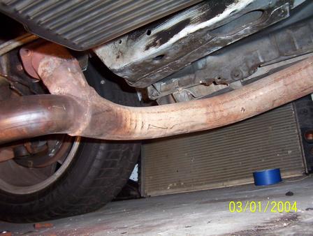

Was there a y-pipe that came with them or did the guy just run open headers. Or were they not installed and he just gave them to you? They do follow the same primary routing as my flowtecs but there are too many things different on those than mine. That is unless flowtech had a previous design that they replaced in favor of the ones I run. My only other geuss would be dynomax. There are better pics of flowtec headsr out there. A quick search should give you some results.

no, they are on my engine...or will be when i finish the sanding...yea, it has a full exhaust system on it, but the y pipe is crushed...is it supposed to be like that? right under the oil pan it is crimped tremendously
No it should not be like that. Do you have any pics of that. That may help solve the mystery.

here are a few pics of the ypipe...u see how it is crimped under the pan, in the first pic, the the pic does not do it justice to what it really is.....

nother

another

last
That is a custom pipe. It looks like it has part of the factory piping with the crinkles in it. My y-pipe with my flowtecs does not have the crinkles but does have a similar t flange like that. Also, the collector on the driver side there is deffinately a hack job at best and not something an aftermarket header maker would let out the door.

definitly not flowtech because the part where it bolts onto the block does not look like that AT ALL.

Upon further review...
Looks like the Blackjack/Dynomax flange.
I agree that it appears the factory y-pipe was modified to fit the headers. They probably flattened the pipe under the pan for ground clearance. Most likely won't be a severe penalty to performance, although a proper round one would flow better. Getting rid of the pipe from the "Y" to the cat, replacing with 3" mandrel and then 3" all the way back would probably make more difference.

Yep, Dynomax headers.... Just about as useless as flowtechs. Hell, the flanges on those aren't even as good as the flowtechs, and mine were warped when I took them off the motor.

Just have an exhaust shop make you a pipe, that way it doesn't matter what they are.

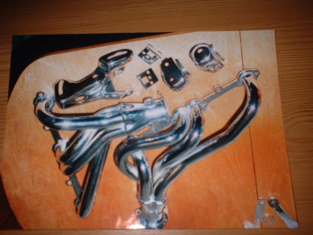

speaking of flowtech headers do you guys think these are ok headers? by flowtech they are 1 1/2 primary tubes and 2 1/2 collectors. is there really that much of a difference from 1/2 to 5/8?

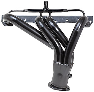

shoot i forgot the picture

thoes deff. look like flowtecs. The flange might not match up, but I am 99% sure that thoes are flows. That one header where the primary runs above the rest of them, thats what tipped me off as soon as I saw them. Look on ebay, they sell them all the time. as a matter a fact...
these are flowtecs. Only thing I see different is the mounting flange and that one's y pipe flange.
That pic is of Hedman # 69470 (the ones with this quote)]

I think those are these:
Excuse the digital photo of a photo! In a hurry!
According to my instructions, they are DYNOMAX headers. The code should be on the collector just above the flange. It should say 098.

Yep. I think they are! Here is a dig. photo of the instruction sheet. Ironically, I needed a Y pipe for these, but made my own (and then had it chrome plated!). Not because I couldn't find one though (I didn't look). Quicker to make my own than wait for them to come from the states to the UK.
Hope this helps.
Andy.
I was talking about the pic below this quote. They are Hedman # 68470, You can see the tag on the header on the left hand side on the #1 tube.
THE PIC ON THE NEXT REPLY DOWN ARE DEFINITLY FLOWTECH.
THE CERAMIC COATED ONES BELOW THAT ARE DYNOMAX.
