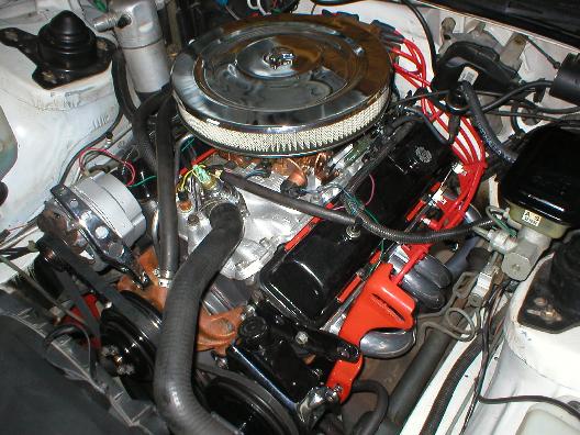

I did the dual snorkel thing a few years back and gained nothing!... On the Trans Am, I think the air ducts are nearly covered once the hood is closed.. I have thought about getting another and trying to route the air from near the air dam... Would even like to try the factory cold air set-up on the 83-84 models, but I'd have to locate several parts including the hood...Anyways, I went to the local Advance Auto and picked up a Mr Gasket low profile open air cleaner. Once installed, noticed my revs come up a little faster... induction noise is cool too Hood closes fine too ...No drop bases needed!
