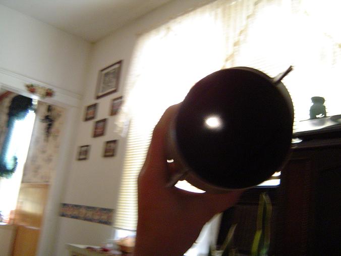

inside of the carsound magnaflow 3 inch high flow cat
Attached Thumbnails Need Help With Diff. Hi Flow Cat Brands!-aaaaaaaaaaaaaaa.jpg

Sweet pics man. Just what I needed. Looks like all of the cats are basically the same. Just a matter of preference and price. Thanks for the help and pics.
