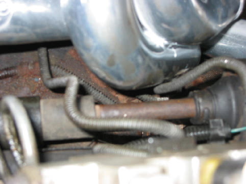

Well, I have posted this picture before, but here it is again. These are SLP 1 3/4 headers with new polyurethane motor mounts. They went in fine and have plenty of clearance.
P.S. The brake line has been relocated since the photo.
