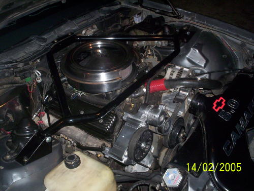

well my friend,instead of people giving you the DO A SEARCH phrase i`ll be cool and give you a complete run through of what you`re going to need.First off don`t worry about throwing any codes you won`t so here we go.
The things you`re going to need.
1.a new serpentine belt.i believe it`s a kb967 belt it`s been awhile.
2. 8 1/4 inch brass pipe plugs,any home depot or true value should have them.
3.ALOT of patience(sp?)time isn`t a problem ,maybe any hour at most.
i don`t have to tell you how to take off the smog pump ,we have a tech article on that.it`s easy so no worries.
i`ll try to get some pics of people with everything connected to give you a bit of a run thru as to how to do it step by step.her`s what it will look like when it1s finished.
Attached Thumbnails emmisions-c-documents-settings-owner

that looks pretty good, but will removing all this make the ses light come on all the time and also for the a.c all i would need is an a.c delete pulley and then i can pull it out?

no your light will not come on.and yes all you need is the delete pulley and you`ll be set.
