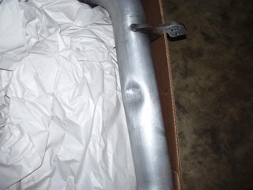

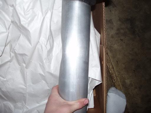

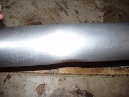

So I got my Hooker Cat-back a couple weeks ago, opened it up, and there was a nice 1/4" dent on the I-pipe. I consulted Summit, they said to return it and they'd reimburse me for shipping, and send me a new one. So I did.
I got the new Cat-back today, and the SAME dent, in the SAME place! WTF? Is this a mounting point and intentionally supposed to be there? Or is there a quality control problem w/ Hooker?
Has anyone bought a hooker cat-back from summit lately? Has it had this dent in it too? Or is this SUPPOSED to be there for some odd reason?
Thanks in advanced....

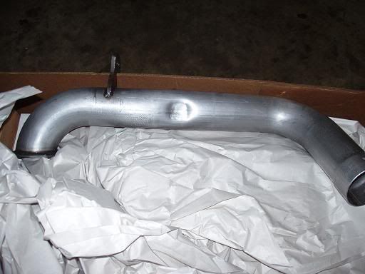

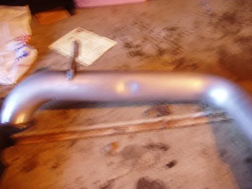

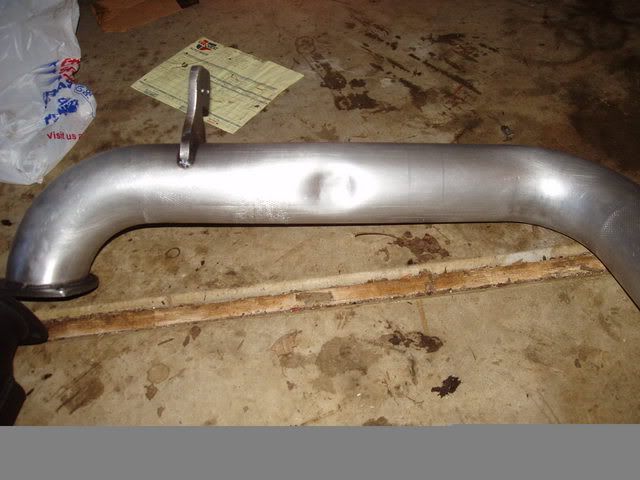

That was the first one, these are the one that I just got.

My cat-back had the same dent. I am pretty sure it is put there on purpose so that you have adequate axle clearance. It looks like a formed dent rather than a mistake upon closer inspection. I thought the same thing when I opened mine up.

thats for clearance on the panhard support brace i think

mine had the same dent in it to...i notice that dent is right where it would sit on the axle if not hung.....so im guessing its for clearance

First of all...the impression is there for clearance on the panhard bar support.
Second...that far back in the stream the exhaust volume is a lot less ....so that little impression will not hurt a thing.
They're are bigger fish to fry out there than worrying about that little spot.

send it back if your so bent out of shape about it, no pun intended. that dent is supposed to be there so the rearend doesnt hit the int pipe.
