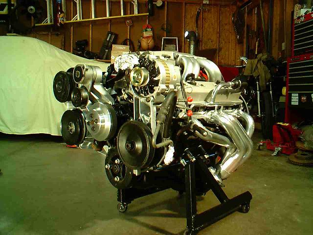

Heres another comparison pic and also the one special tool needed above all the others.
I had to get every tool I had out and layying on the ground near me..every drive ,every socket, every wrench, 3 adjustable wrenchs..the only tool I didn't bring out was the crowbar..I didn't think having that lying around would of helped..would of been to tempting to just dent the heater core box..

Picture of my engine with the Edel. TES and you can see the pipes come straight out of the port then curve down, roughly an inch or more clearance from the end of the plugs, not close to them on the sides.
I am still wondering how to bolt up the a/c bracket, the dipstick, and the alt. bracket. (???) what did you guys use?
I have the hedman headers and was wondering if the manufacturer is supposed to send new bolts? The standard header bolts will not allow these brackets to be conected.
help me out, I'm confused.

TOM3 thats a beauty.
bowtie driver
I didn't go the AC route myself so I'm can't help to much but didn't your set come with a bunch of different sized bolts? I have a bunch of bolts left over from my install. I choose the ones that gave me best access.
I left the dipstick just free standing but theres going to be some metal type cable tie/clamp for it in home depot for like $2.
Can you post a pic of where your up to now with the AC bracket?
bowtie driver

The Edelbrocks come with an fairly complete install kit with different bolts, and a clamp for the dipstick. There is a rod type support for the AC that has to be bent on the ends, the instructions call this out, hard to bend though.
Joined: Jan 2005
Posts: 220
From: Eastern Georgia
Car: 1986 Iroc-Z
Engine: 305 TPI (used to be Carb)
I used the old AC bolt on the front bolt on the drivers side. I used the starburst looking black bolt in the second bolt hole on the drivers side to mount the AC with no problems at all. The pass side I used the starburst head long bolt with spacer to hold up the black canister AIR thingy on the front bolt on pass side. As for the oil dip stick, me too - Free Willing it. It was really tight on space getting it in there and once I got it in, I realized it wasn't coming out without a fight. Hope this helps. If needed I will post a pic of both sides if it will help you out a little better.
Tony

I just got mine on last week and they werent much fun either. I got the coated ones so I was trying my best not to shove them into place and mess the coating up so that made it a little worse than if I just got painted ones and rammed them home. I also smashed my fan switch but kind of did it on purpose because Im replacing it when I install my stealthram with a lower temp one. I love how my exhaust sounds now although Im still getting use to that header sound under the hood which you can actualy hear the pulses through the thinner walled pipes.

the fan switch is on the passenger side.
Somewhere in the middle just beneath the headers.
If anyone can post a pic of it's location it'll be great other wise I'll do it this weekend when I'm doing my rotors.
along with my newly welded exhaust.
"My1986IROC-Z" could you post the pics of how you did your AC bracket?
My fan is hard wired and just runs all the time. I like the noise more than any cooling benefit's.
Thank you for everyones input on this thread as well.

I guess I will have to call hedman. I bought these used and was just wondering if they sent bolts to do a proper "bolt on" swap.
dog, thanks for the links. if you could post some pics it would be appreciated. I have the motor out right now and am putting on the 416 heads but I also have to rewire my fan. the moron that had it before me jacked up alot of things. he hardwired the fan but on a toggle switch. so you gotta remember to turn it on all the time. I'd rather have it automatic.

I'll get you pic's up of my fan switch and the wiring if I can figure how it was done...and what bolts I have and all that stuff this weekend..I've no time before saturday.
If someone else can post pic's of any brackets they made that would be great as well.
