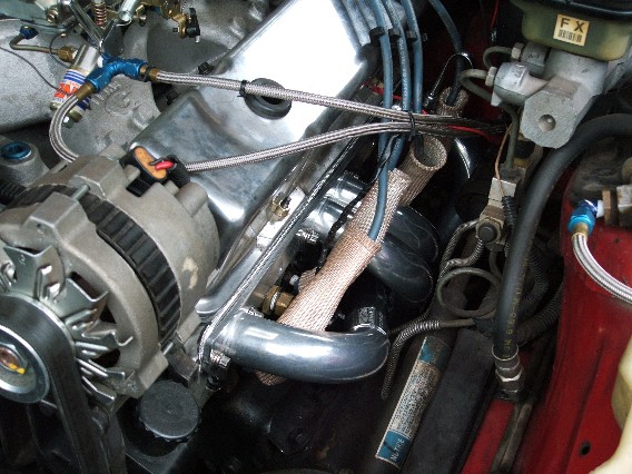

Re-routing it would be fine but you could go get a fiberglass heat boot that slips on the header so the plugs wouldnt get burnt, click on my sig and look at mine for an example.
Old Aug 15, 2005 | 11:17 PM
  #160
DanTheMan_smlk's Avatar
Joined: Oct 2004
Posts: 84
yeah, i saw those in summit catalogue; im getting them. I need to get some heat shield too....is it bad that the headers are touching the coolant line that goes to the firewall? (it is black metal line next to the strut tower) Can i use exhaust tape from walmart as a heat shield?

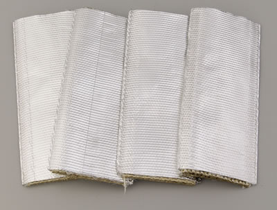

i need heat shields for the wires. Wire seperators wont work for this because of the Edelcrap design. I need heat shield for the wires, not necessarily the boots.
i was thinking of getting THE-14250
more info and pics here!! https://www.thirdgen.org/techbb2/sho...hreadid=315832
Old Aug 17, 2005 | 08:26 PM
  #180
BT283's Avatar
Joined: Apr 2005
Posts: 890
From: Hickory, NC
Car: 1991 Camaro RS, 1993 Camaro Z-28
Engine: what engine, LT1
Transmission: did it come with one, 4l60
Axle/Gears: They spin (most of the time)
those should work if you can keep them from sliding around

HEHE got my headers on today, I did it in like 1 and 1/2 hours because i jacked the motor up, but i dont have any AC or Emissions crap to deal with either here is a pic

and here is the right side, this one just fell in

the way your headers are designed makes them fit easier and lets you route the plug wires easier. I was cheap so i got Edelcraps. I dont care if they arent the best performance wise, i just wanted to do my exhaust all the way because i was taking most of the pipe off.

My headers where made to clear angled spark plugs. That is why they are easier to route the wires...i think BTW...Flowtechs suck compared to these Hedmans

BT283, your headers are easier to route the plug wires because you don't have AIR tubes. FWIW, I ran my wires over the top like yours with a set of SLP headers with AIR. The only way it worked was with old style perimeter bolt valve covers, moroso plug wire looms that bolt to the outer valve cover bolts by the headers, and a big f*n prybar to persuade the AIR tubes out of the way enough to run the wires down without hitting. Since I just recently cut the AIR tubes off and had them jet-hot coated, it's one less headache, and looks much cleaner. I have never done a set of edelbrocks and run the wires from the top...they just don't fit without touching a tube.
