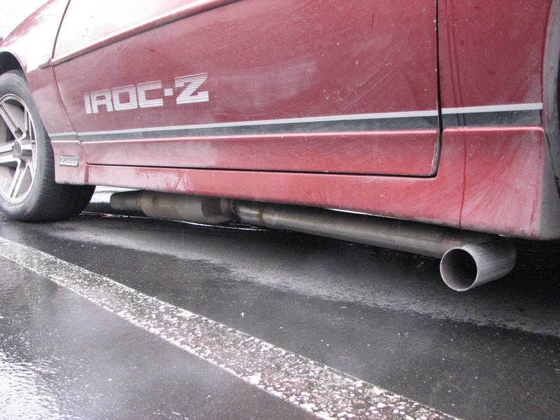

well today i decided to get rid of the stock setup, even though it was flowmaster.
Now i have true dual 40s exiting right in front of the rear tires. here she is
yes my ground clearance kinda sucks, but it is well worth it! this car is going to be mostly track, and the drive there anyways.
The nice thing about the install was all the guy had to do was cut just beneath the flanges on my shorties, and rotate the pipe. Soon i will add an h pipe through the channel where the driver side pipe originally went. i will also post a vid tomorrow.

That looks cool, but ya...the clearance issue sucks! You can forget about ever lowering your car! I would love to one day run dual exhaust on my ride, but have to figure out some way to really tuck in the pipes, since my car is slammed.

I wanted to do the same thing but I have a pretty high curb into my driveway which has already bent up my mufflers a tad. My ground clearance is like maybe 3-4 inches and I know for sure any pipe under the ground fx would definetly hit the curb and probably crush the pipe shut or something. I have the same flowmaster mufflers and it's damn loud but sounds oh so freakin' good ("love that sound!"). I got some spring spacers to actually raise my car a half inch or inch or so just so I have some clearance, but I was thinking about just continuing to run the pipes straight back, both pipes over the axle on their own side and exit them right behind the rear bumper at a downward angle but hidden much like the first gens' systems. If I ever get it done I'll post some pics...

we tried hard to conceal them, there are channels on each side we tried to get into, and there are bulges under the front seat area which the mufflers were in. I will get a clip here shortly, i have to walk the dogs.
the other thing that made me realize i dont have clearance, is i couldnt even get off the lift. They had to lift up the front of the car.

i am going to get it redone with oval tubing, then it will be decent

just did mine but i dont have the ground clearance like badass's, thats a nice setup but ur undercarage looks diff than mine...prob suz mines a firebird. its also easier for u bc u have a manual trans and ur crossmemeber gives u adaquate room. my dual 3" mandrel exhaust with xpipe post is a few lower and i had to notch the stock subframes and my mufflers are the lowest point. got a few inches ground clearance with the sportlines on, if i get rid of the mufflers i can get an extra 1.5".
love the sound of it especially with the xpipe, and instead of the Hpipe go wit an xpipe they make more power and have a better tone
