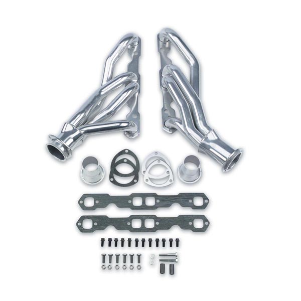

Hooker shorty headers are a very popular item on
this forum. Having just spent a couple of hours
on the Holley web-site, comparing the technical
differences, I thought I would summarize the info
for public dispersal, including the catalog images
(which are reasonably informative, when viewed
comparatively). Quotation enclosure is taken from
the tech data sheets, dashes indicate my comments.
2055 series, 86-90 F-bodies
2055HKR -> painted
2055-1HKR -> ceramic
-> both include y-pipe adapter, w/ 3" outlet
-- Differing opinions exist on the board, of the
ball-socket connection, from restrictive (which
can be opened up), to structural strength.
"Accomodates all emission devices"
-- Air tubes attached, and drilled O2 bung.
"Will fit angle plug heads"
-- Hooker tech rep assured me they were still
in production, but I couldn't find Jeg's
or Summit listing's.
-- Tech Data sheet dated 10-22-04
2460 series, 82-92 F-bodies
2460HKR -> painted
2460-1HKR -> ceramic
2460-2HKR -> stainless
-> Available w/ AIR tube fittings only,
as part #'s 02460...
16767HKR -> Aluminized Y pipe separate
(no image available)
"Only off-road use legal"
"Raise eng. 1.5 - 3 inches for pass. side installation"
"Modify AC bracket"
-- O2 bung present, but must be drilled.
-- Collectors have flat flange mating surface,
adapter included as part of y-pipe package.
-- Looks to have better spark plug clearance, but
AC box may need protection.
-- Tech Data sheet dated 5-24-05
2466 series, 64-96 universal
2466HKR -> painted
2466-1HKR -> ceramic
"90 deg. spark plug boots are recommended."
"Install dr. side from below, pass. side from above."
-- Easier installation, at expense of spark plug
clearance.
-- No O2 bung visible.
-- Collectors have collar mating surface, adaptors
included.
-- Tech data sheet dated 4-4-02.
Attached Thumbnails hooker headers-large2055hkr.jpg   hooker headers-large2460hkr.jpg   hooker headers-large2466hkr.jpg

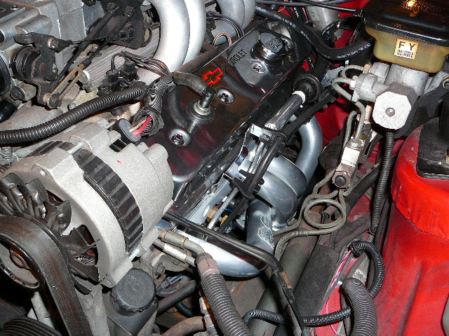

I just put the 2055's on my 88 Iroc. The biggest PIA is gettting the old manifolds off. As for the rest well here it is. I used Taylor Spiro 8mm wires with the 90 degree plug boots. This set you cut to length and make the ends for the distributor, a perfect fit. I used the Delco platinum plugs. Some of the plugs you can get easily with a std. 5/8 plug socket and a 3/4 wrench, for the rest I have a cut down modified plug socket from Hawks that worked perfectly. I used 3/4in stage 8 locker bolts and Felpro manifold gaskets. Finished with Moroso wire looms. The new Ypipe I put into a Magnaflow free flow cat. I cut away the cat a.i.r. tube but retained the tubes for the headers just in case I need xtra H2o to pass emissions. last night though I pulled the air pump and diverter. If I have to I'll reconnect it when it comes time for inspection next yr, Joe
