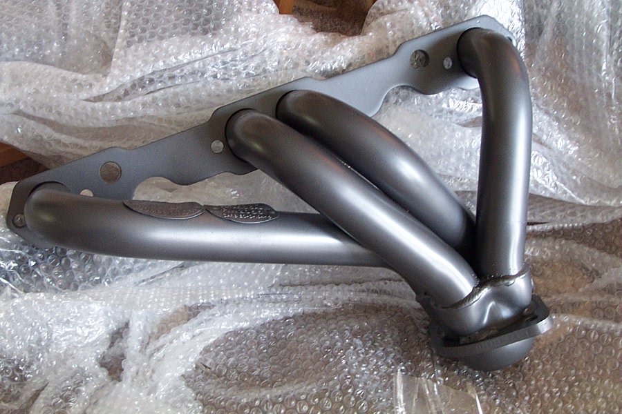

I believe so but now that I think about it the connectors at the headers themselves might be different. I think the ones on the 2460's are a flat connector as to the 2055's have a ball joint.
Old Nov 16, 2010 | 03:12 PM
Thirdgen89GTA's Avatar
Joined: Sep 2004
Posts: 5,906
Likes: 240
From: Chicagoland Suburbs
Car: 1989 Trans Am GTA
Transmission: M28 T56
Re: Found 2055 Hooker Headers, no Y pipe ?
That is correct.
Attached Thumbnails Found 2055 Hooker Headers, no Y pipe ?-headers005.jpg   Found 2055 Hooker Headers, no Y pipe ?-headers-003.jpg   Found 2055 Hooker Headers, no Y pipe ?-headers009.jpg
