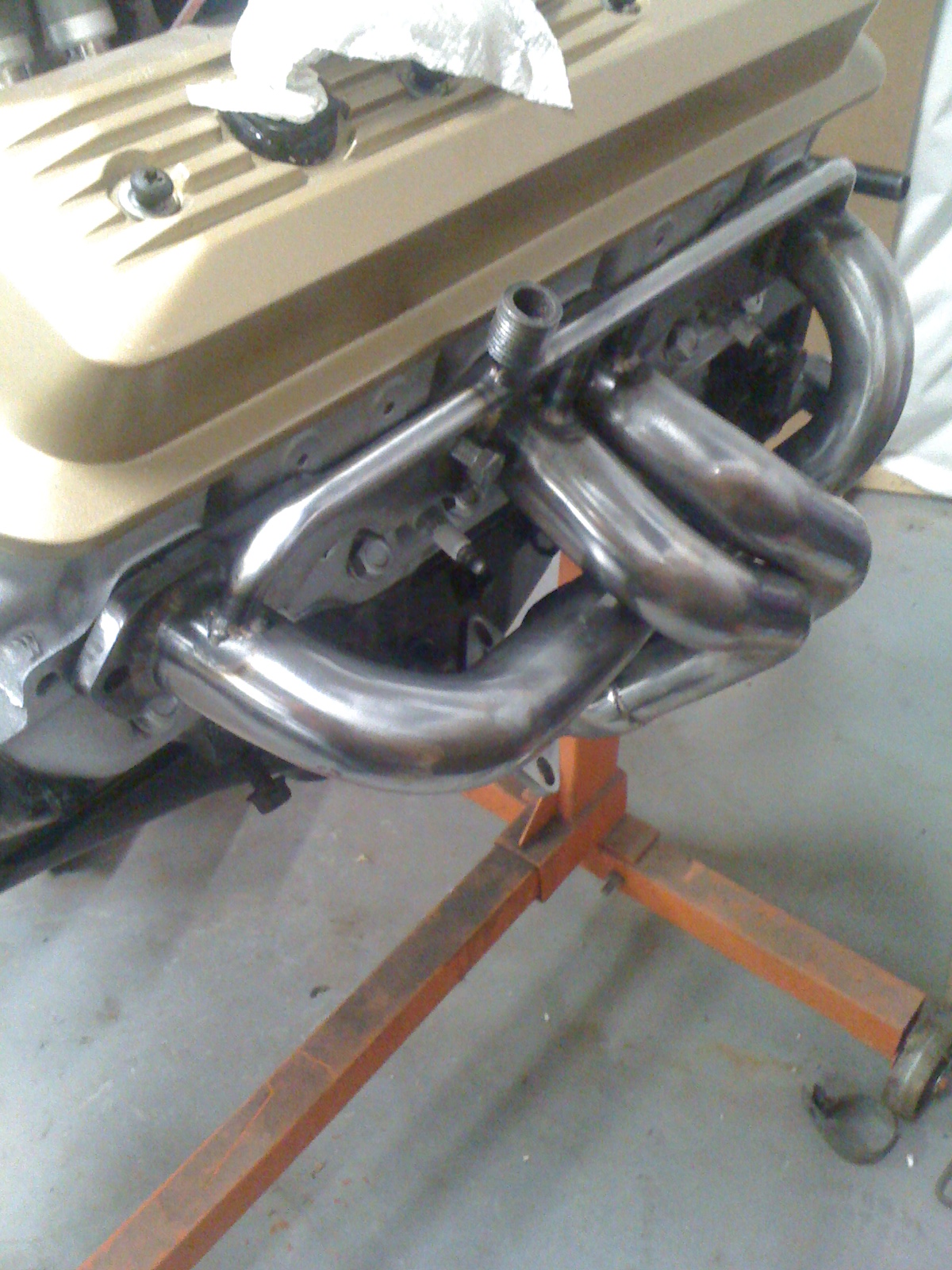

Here are some pics of the headers on the engine. I was doing a test fit and they seem to fit just fine. Not sure about the Y pipe yet but it looks like it should fit just fine. The header flange also seems nice and flat. With a good set of header gaskets it should seal up just fine. If I have to i will double up the header gaskets.

Powder coating will not stand up to the heat!!!
I have 2 buddies that went to 2 different shops stating the powder coating would hold up. Both had miserable luck with it lasting.

The headers are at my firends being powder coated. He said they will hold up if you do it right. When you first start the engine with headers that have been powder coated you have to slow heat them. Only run the engine for a few minutes then let them cool. The the next time run the engine a little longer and let them cool and so on. I have the old engine just about ready to come out of the car. Going to finish that on sunday. I will keep you posted. Once I get the new engine in with the headers I will post a video with sound.

It has the bun for the 02 sensor on the collector of the header.

Originally Posted by isr85-T/A
they were the zomk speed (pacesetter) copy, the shop told me that the tubes stuck out to far they hit the inner fender wall and could not be bolted onto the heads. i know the guy in the shop and he also owns a third gen camaro and he has bolted headers on his car before so i know when he tells me it wont fit i know he is right. you guys go ahead and try them out but i know i got riped off. ebay never again.
Yeah, I took a closer look at PA91Z28's pics of his test fit, and it does seem like they may stick out further than other headers, at least on the passanger side. There seems to be quite a gap between them and the spark plugs (though maybe he's using the shorter plugs?). I think I might wait to see if he puts the motor in before I would be able to install them to see if he has the same problem.
Old Feb 1, 2011 | 11:09 AM
PA91Z28's Avatar
Joined: Mar 2009
Posts: 41
Re: Does any one know about these headers?
Originally Posted by F41eatsFords
Yeah, I took a closer look at PA91Z28's pics of his test fit, and it does seem like they may stick out further than other headers, at least on the passenger side. There seems to be quite a gap between them and the spark plugs (though maybe he's using the shorter plugs?). I think I might wait to see if he puts the motor in before I would be able to install them to see if he has the same problem.
Sorry guys I have not been on here for a while. I do have the old motor out but it might be a while before I get the new one in as I am going to rebuild the entire front end while the motor is out. However I will do some measurements tonight and see if clearance is an issue in the engine bay. And I will try and post more pics. And FYI the ones I bought have 1 1/2 inch primary's. And I have standard plugs in the engine.
PA91Z28, have you happened to have had a chance to take those measurments yet? As far as the ones for the clearance goes, I mean.
