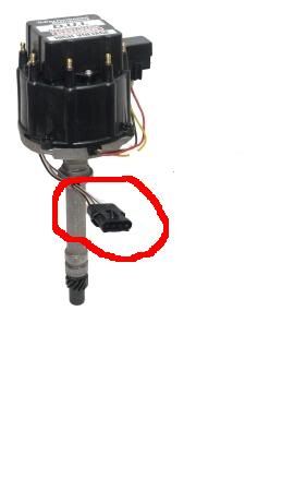

Does your distributor have a 4 wire connector like this?:
you have to disconnect it while setting the timing, then reconnect it.
no ,that isnt right.there is/was a brown wire with a black stripe near the blower motor that you disconnect before you set base timing.and doing so will set a code 42 .just reset the computer after your done

oops my fault I gave out setting the timing for computer controlled carbs instead. rusty vango is right.
