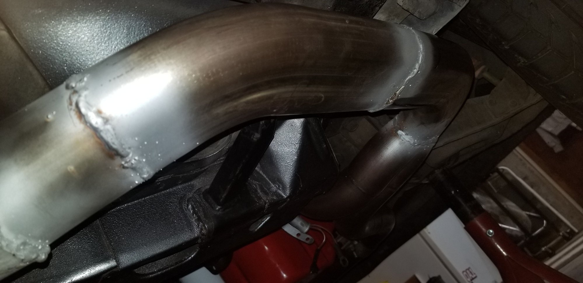

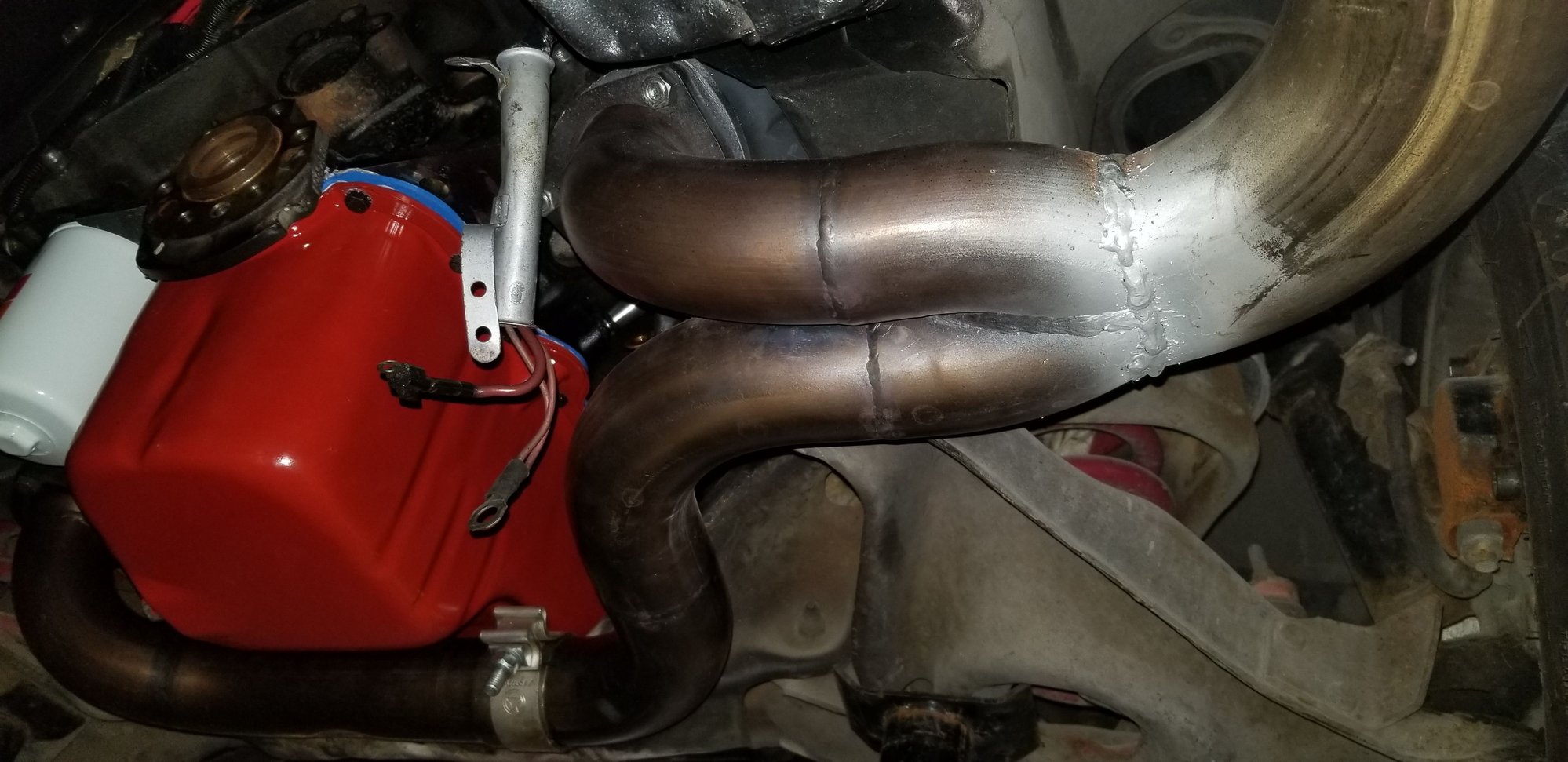

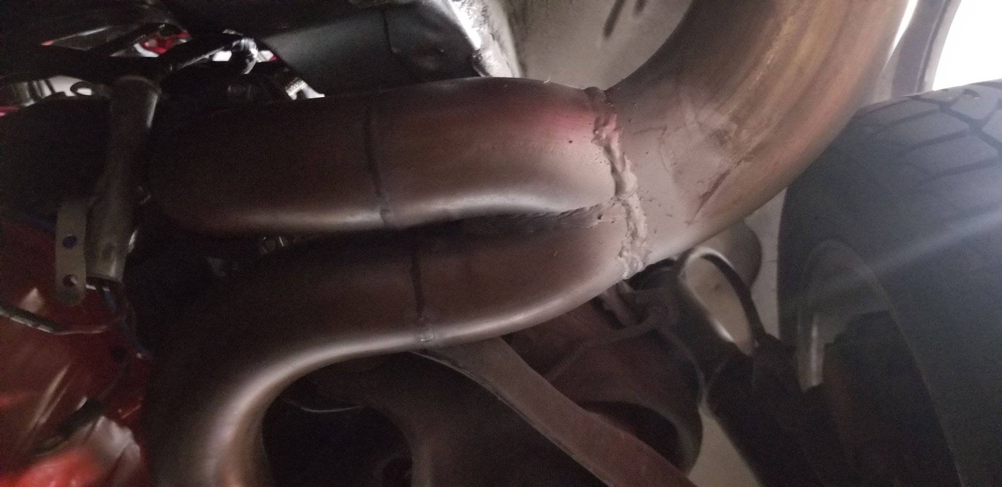

i WISH YOU WERE CLOSER, AND i WOULD MAKE YOU A CLEAN Y-PIPE FOR $100. I built mine, with a custom cross member, and a 4" out the back with a hooker aero-chamber. I have actually had a couple people tell me it sounds like a Ferrari. Don't know about that but, I really like the sound either way. As for the 3" crush bend vs. mandrel 2.5" Unless you have a crazy engine, the 2.5 would be plenty. Mine is really over kill, but I had to prove a point. Before I opened my own exhaust and fab shop I had guys laugh at me when I told them what I wanted under my car. One guy even call me an idiot. So to prove him wrong I built it. I will post up some pics soon. I plan on making some changes to the car and having the whole exhaust system ceramic coated.

I could do one about any afternoon. Where are you at now? Just saw Ft. Knox? If so your only about 2 hrs from me..

Those of you who cut off the bottleneck of the y-pipes, and welding in a 3 inch piece, did you cut before the y, and find a 3 inch "y" section, or did you just cut after the y, before it gets down to 2.5 inches?
I'm curious about this too. I have the 2460's with the hooker 2.5" y pipe and need to join it to my existing 3" exhaust without restricting it down to 2.5.

Originally Posted by potterc32
I have a mini starter on my car with the y pipe pretty close, and haven't had any problems yet. it's been over 2 years now. and I just cut the y-pipe right at the "y" and welded on a 3"oval pipe. I cut the "y" as far back as I could without making the hole bigger than the Oval. I am very happy with the results!
Any tips for ovalizing 3" exhaust to fit the 2.5" y-pipe collector?

Re: NO 3" y-pipe for Hooker 2460? (custom $?)
I purchased some oval pipe sections from summit. Worked great!

And it looks like it clears your subframe connectors too! Are those the UMI's?
Yes they are! My old exhaust rested right against the small support of the subframe connectors. Always made obnoxious noises. Love my new exhaust!!
Did you do oval all the way back or did you transition to round?
I transitioned back to round right before the electric cut out. The cut out is right where the catalytic converter used to be.

How close is the passenger side tire at full right-lock to the Ypipe bend for you guys?
I'm fabbing up a oval to 3" adapter and have concerns about how close my set up may come to the tire.
