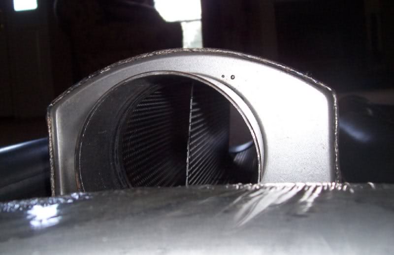

Anyway my car does it a little just because I have a 3.5 inch exhaust with a splitflow muffler (which is a glorified glasspack).
My cam is too small and my exhaust too long to get it really raelly raunchy, but it definitely does it on decel.
Ive been wanting to change it for an aerochamber for a while now, Just way too loud.
