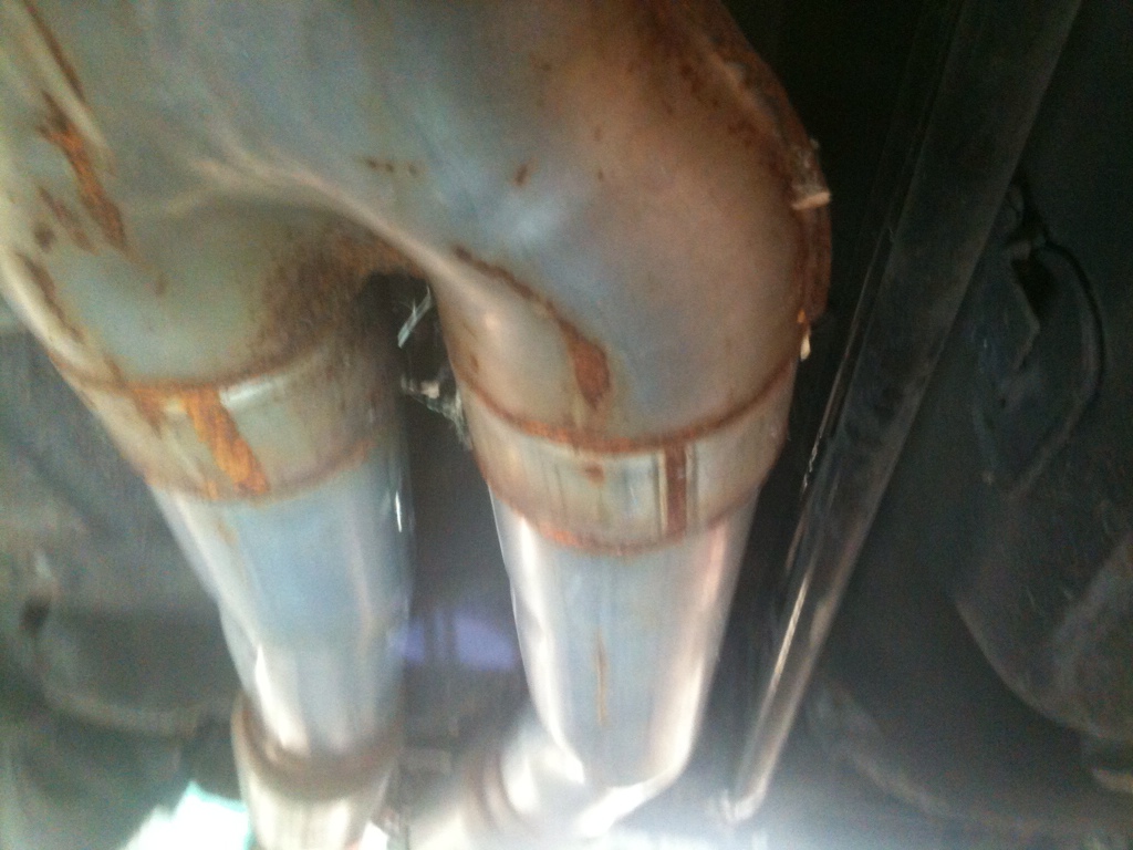

Didn't have to modify any part of the headers. They'll fit perfect with angle plugs too(better than mine).
I'm running 3" duals with magnaflow xpipe and 3" dynomax bullets that run alongside each other on the passenger side of the trans tunnel and turndowns at the rear axle. I love the way it sounds. Kind of a "rolling-raspy sound"
Be aware though that the ceramic coating may flake off after a while.
Also I had to notch my crossmember to get good ground clearance.
Here's some pics...

excellent thank you so so much finally got em in btw that bird looks like it wouldnt want to stay on the ground lol whats she run and whats ur setup as far as powerplant she is a beautiful car ,probably has an attitude problem to lol
