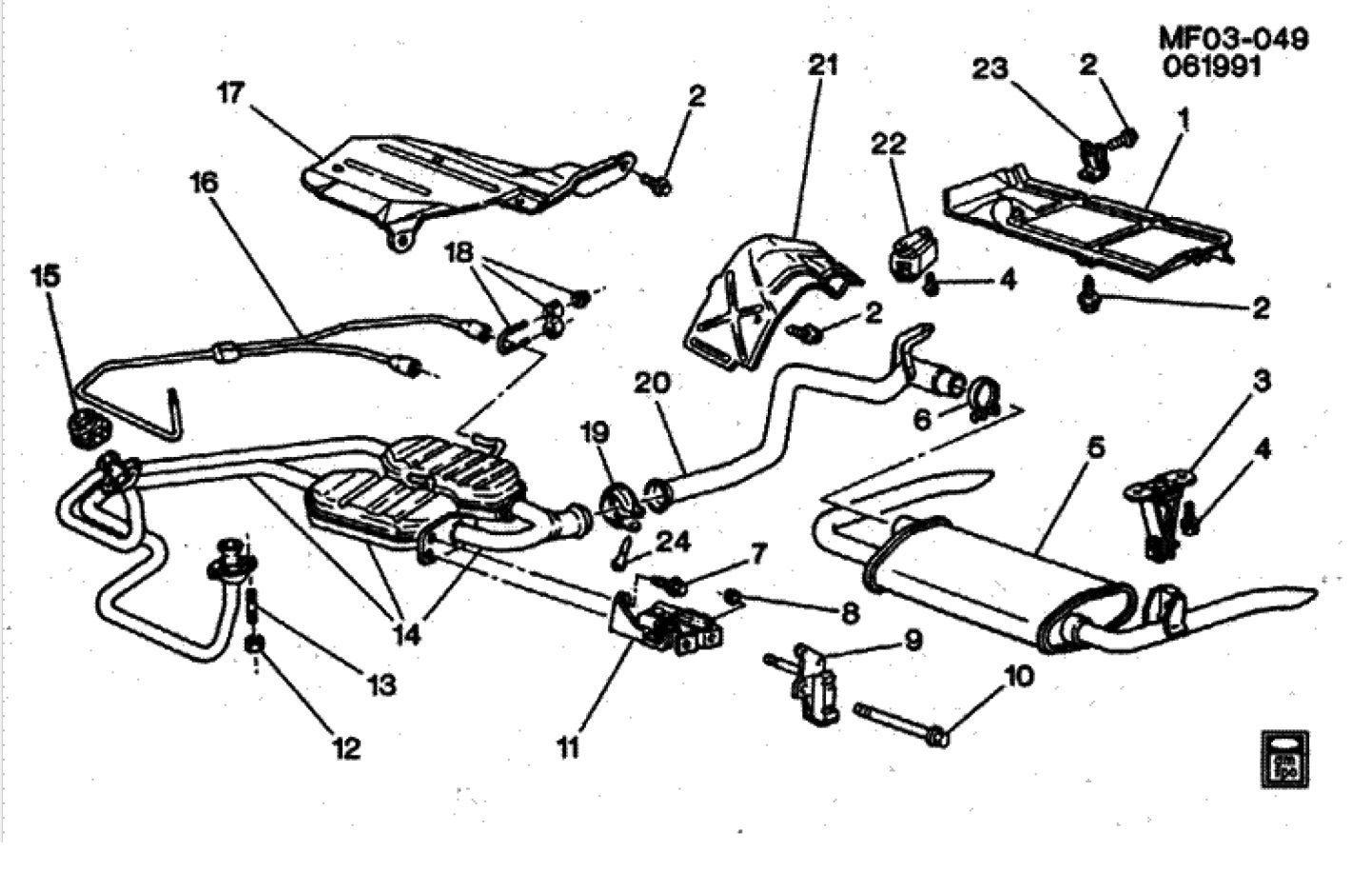

Below is a diagram for a 1989 Firebird Trans Am GTA with 350 cu. in. L98 VIN 8 equipped with the dual cat system (RPO N10).
Source: my 1982-92 Pontiac F-Body Parts & Illustation catalog.
