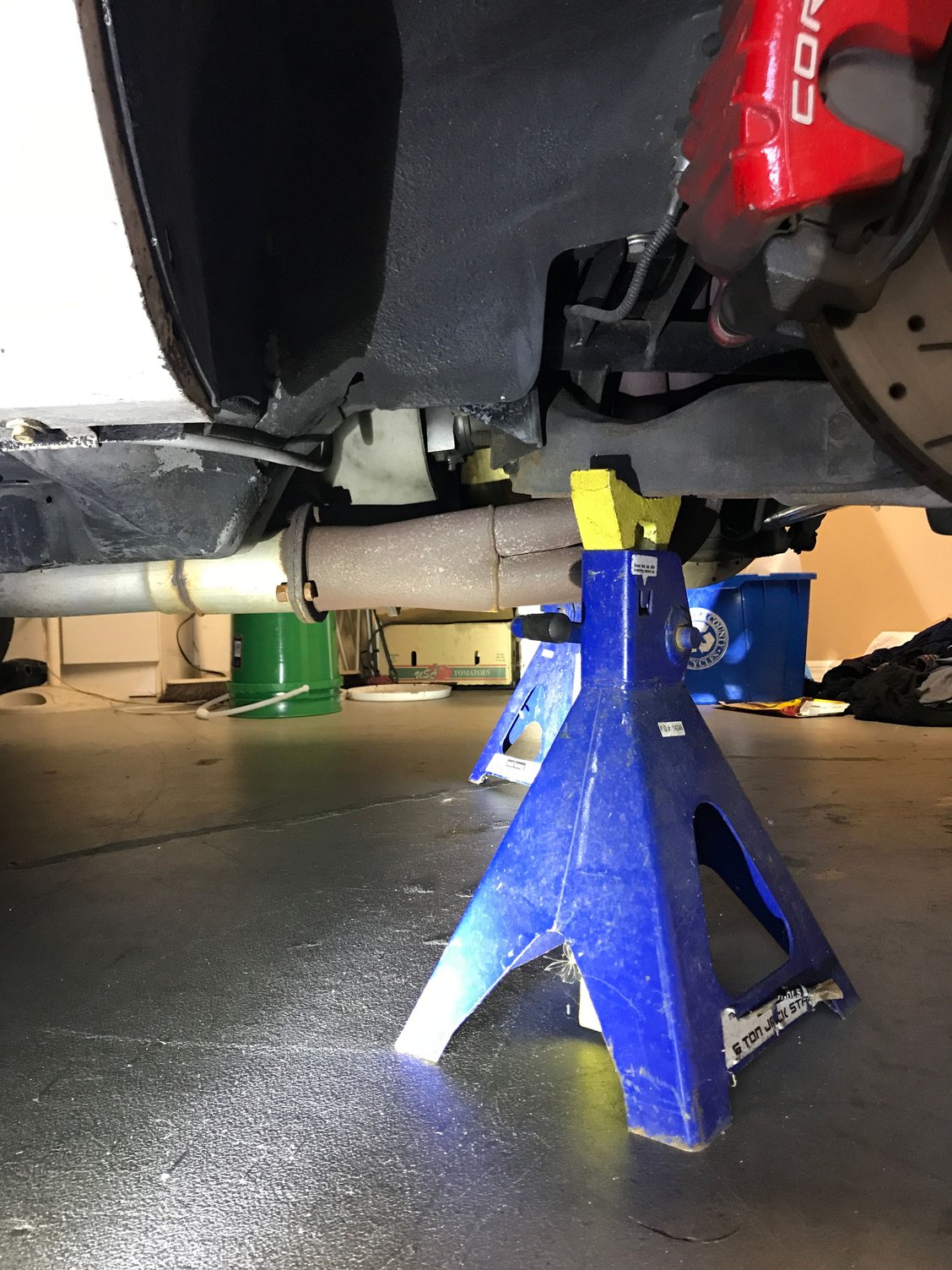

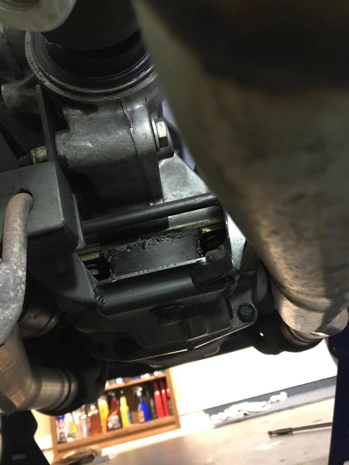

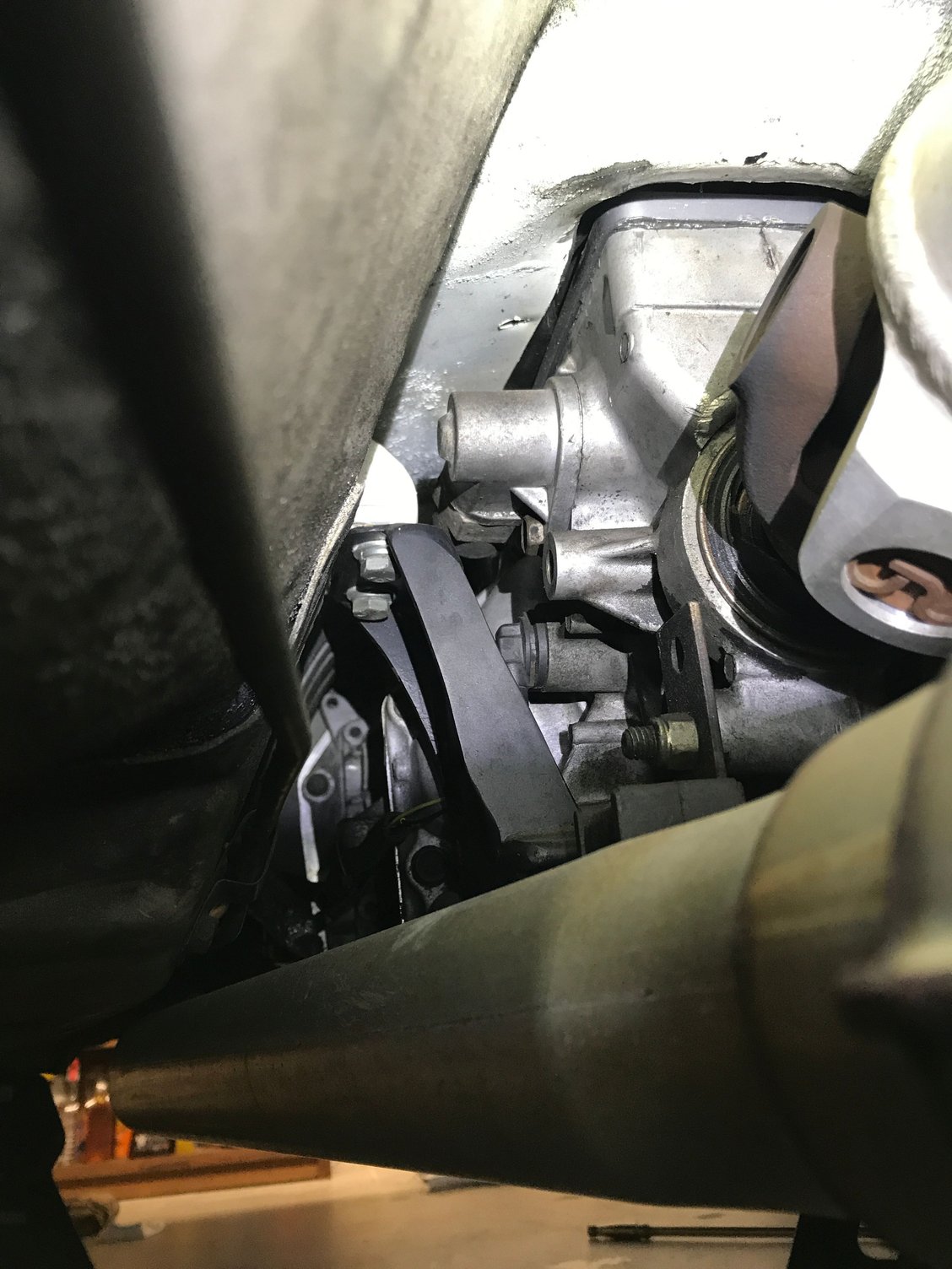

Biledriver's Avatar
Joined: Dec 2016

I have the hookers. I'm only about 1.5 lower than stock, I'd probably go lower but when I drop it I spin way to much. They are definitely the lowest part of the exhaust but I also made my own trans crossmeber and cut and raised the rear seat area for mufflers so it may not be the lowest part if not for that. I would take a pic of the ground clearance but I'm jacked up for new tiers now.

Re: Long tube hooker 2210 or Dyno Don short
Might get a idea of how low looking at the sub frame.
Definitely the lowest part is the headers.

bile thanks for the pics man, doesn't seem to be too too low, i mean everything doesn't look all bashed in! thanks
