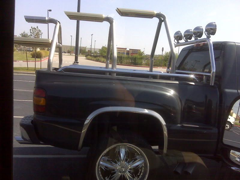

Re: suggestions on what to do with these tailpipes?
yup my feelings exactly look stock carry big stick these Walkers fit the bill
living close to our southern border i see lots of horrendous exhaust systems ,,,
rest are for Drew

As long as people catch the references, I'm satisfied.
Damon Wayans killed it. Back when politically incorrect could be funny.
