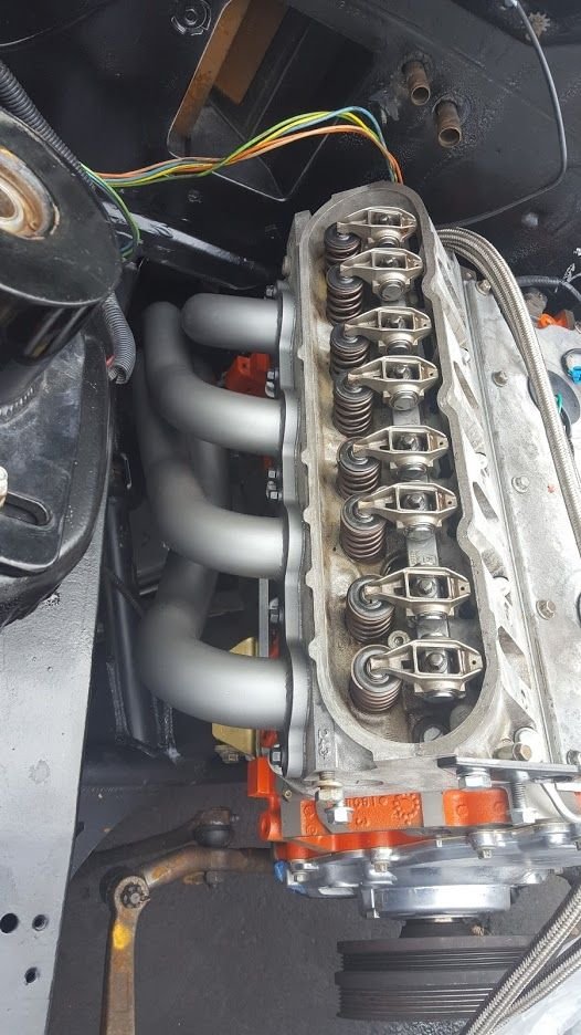

Fitment is great! I had mine coated So far holding up well

Punkmaster98, the headers look great! Thanks for the reply. I like the look of the coating too.
