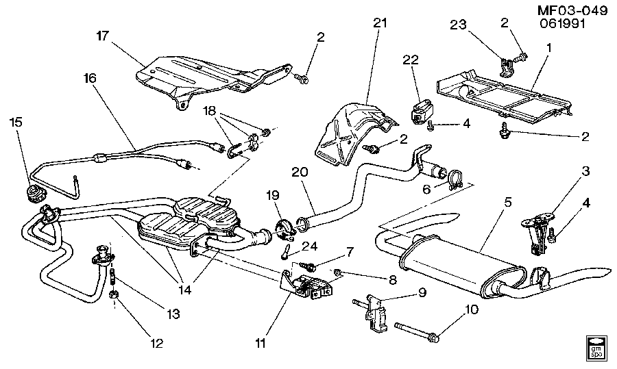

Hey everyone! Just bought a factory style N10 replacement y-pipe and catback.
I am looking for the clamp or whatever is used to connect the two. I have the y-pipe in so far, but the cat back is still on the way so I can't piece them together just yet.
From the looks of the y-pipe it looks to be some sort of V-band, but i could be mistaken.
Thank you for any help!

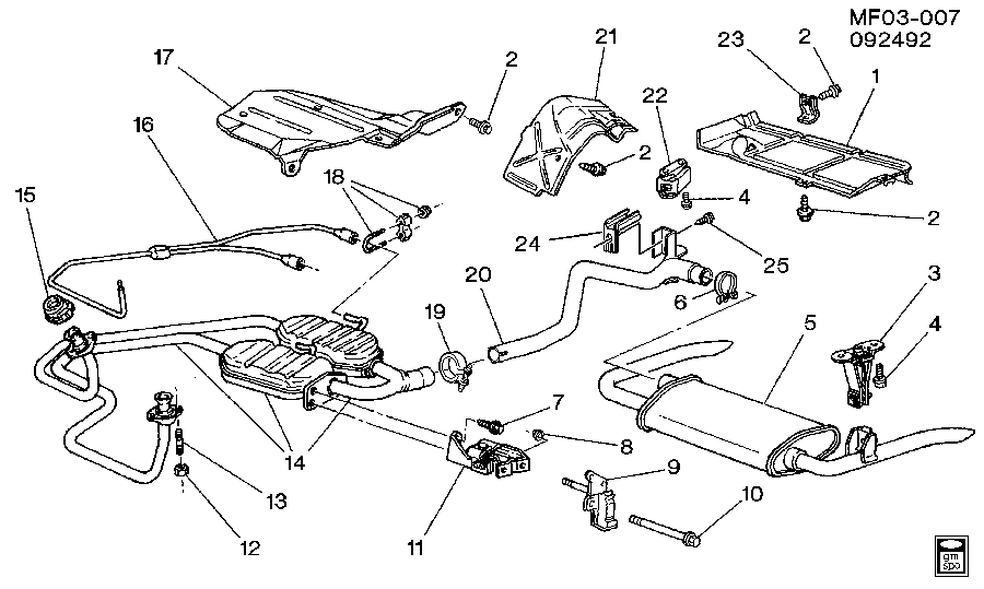

It's an early attempt at a V-band. GM ditched the band clamp somewhere around 91.5 in favor of a slip flange. If you're changing stuff anyway, you might want to cut it off and weld on a typical V-band, or use a slip fit connection, they'd probably seal better and not rust as quickly.
Or you can hit Rock Auto

That is the 2nd version of that clamp. The 1st style had a nut welded to the clamp and a smaller diam bolt that was longer. They would break a lot, guessing that's why the bolt was updated to something stronger/bigger.
If you noticed, there is a bit of a notch in that clamp at the 2'oclock position. That locates it properly on the pipes.

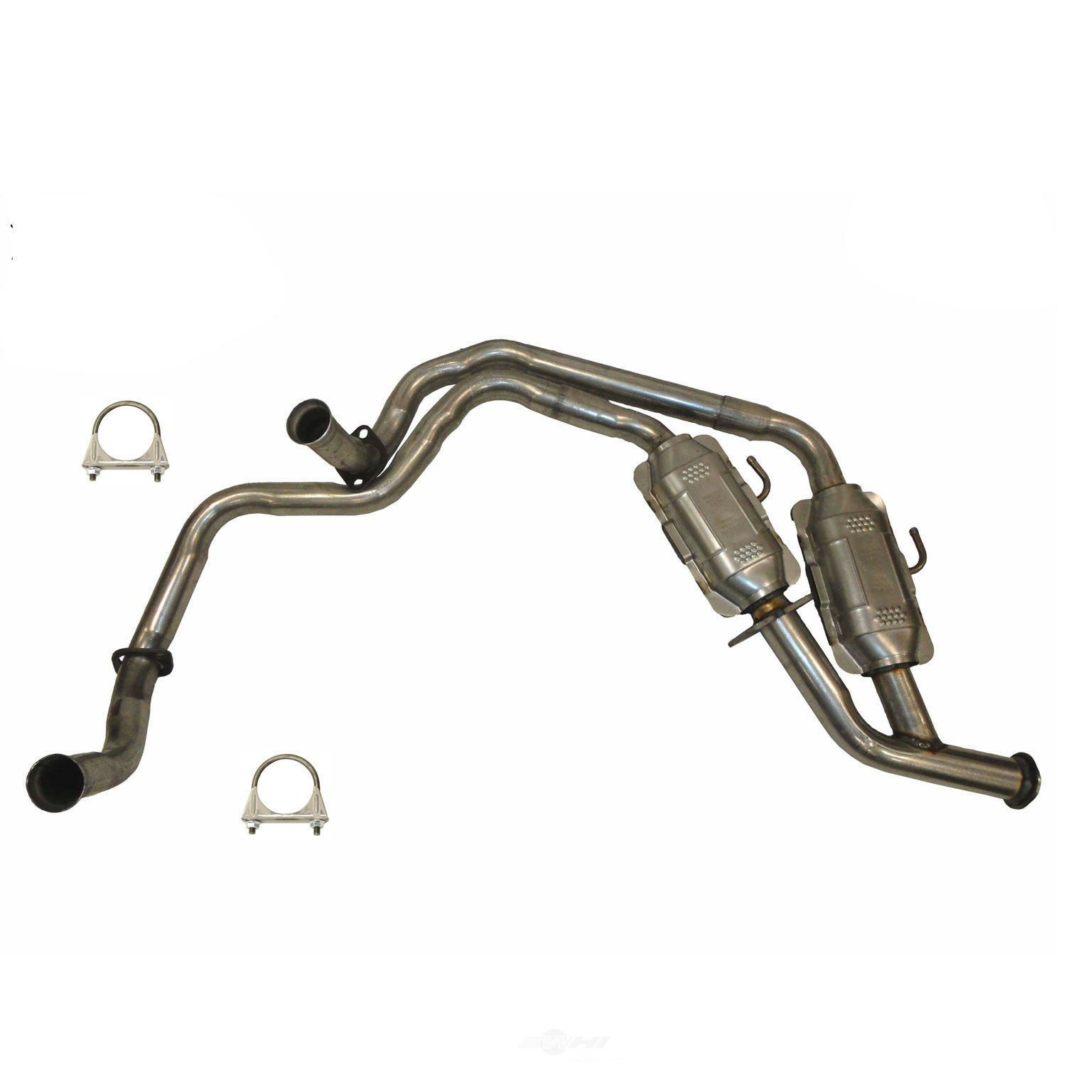

https://www.amazon.com/Mac-Auto-Part...9015836&sr=8-1
I can't relate. I've still got the OE wiper frames, various AIR injection bits, and the L69 aircleaner I had on my 83 Camaro in 1996. People come on here looking for stuff that hasn't been available in decades and they can't find anywhere, then they offer $10.
Interesting... Walker discontinued the N10 intermediate pipe a few years ago. Looks like that kit is using this intermediate pipe that they've cut in the middle.
