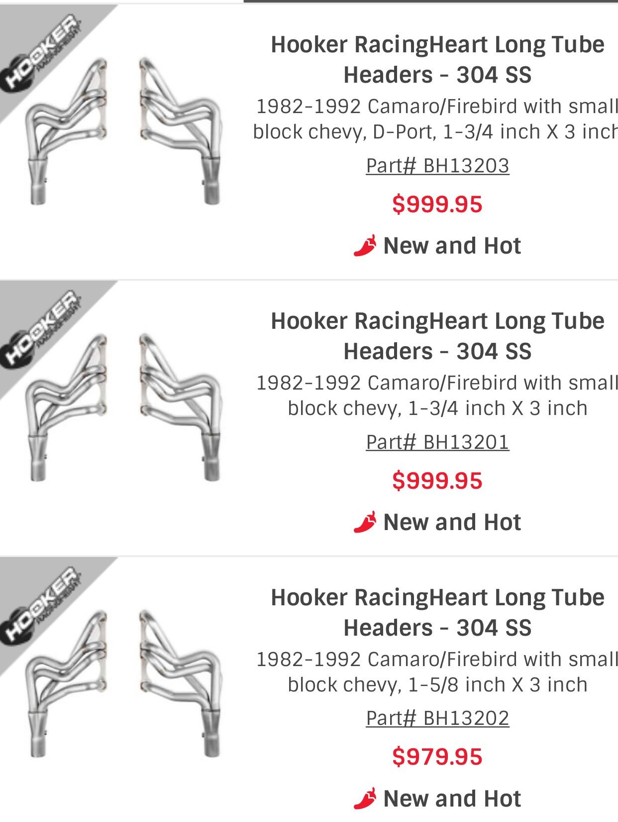

So all I see are Racing Heart headers for the Camaro. I don’t see Blackheart.

Those are them. It says blackheart right under the word Hooker on the left side of those images.

The Hooker Blackheart and Hooker RacingHeart branded products are one in the same and are both made using the same components, materials and build methods.

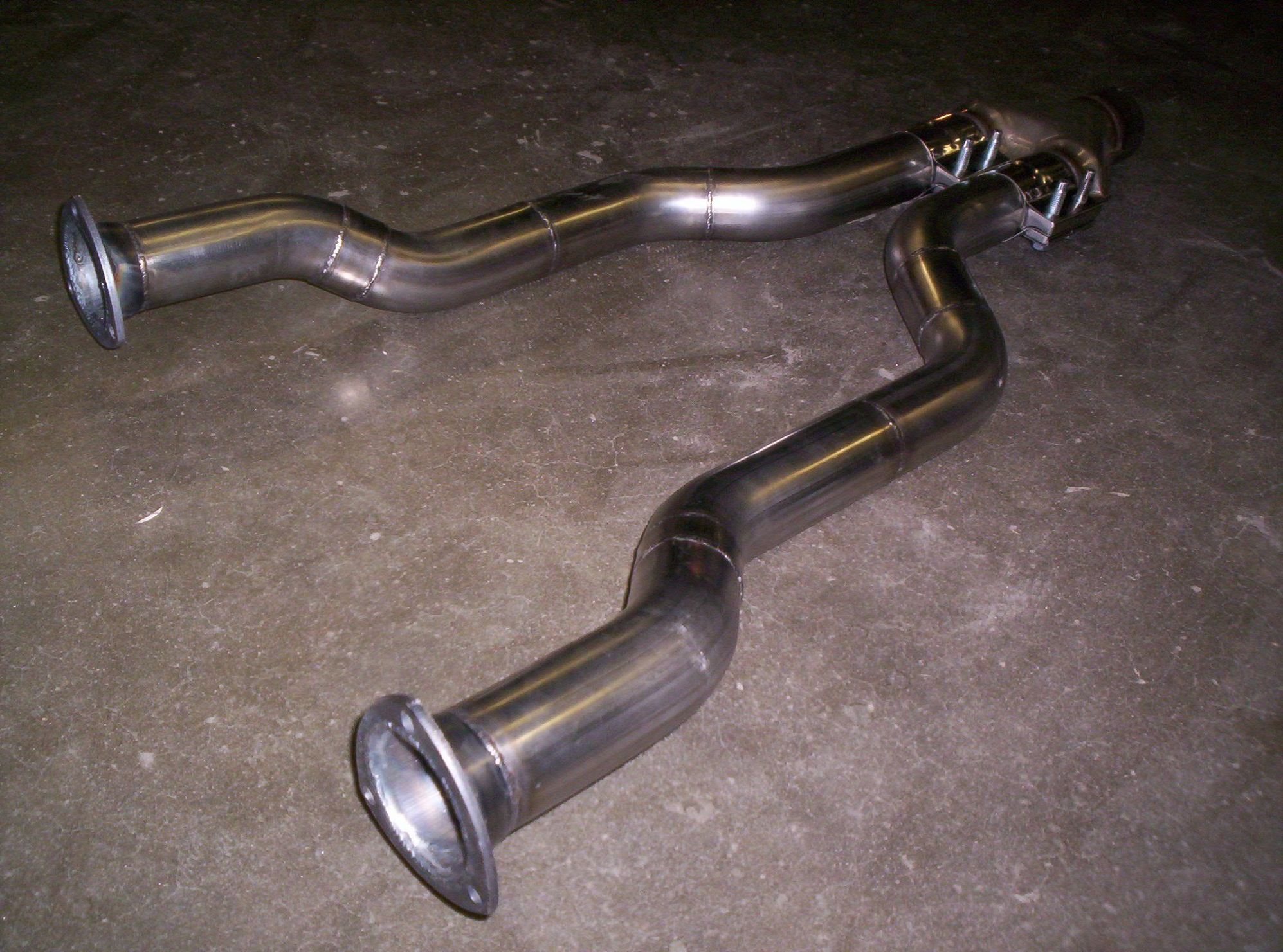

Yeah, my plan is to adapt the speed engineering 4th gen dual 3" kit.
Single 3" will be way to small... Either way I will have to fab up a y-pipe...
377 LSX with Mamo Heads, Mamo intake and cam. Should make 600+ hp at the crank.
If you're buying the Hooker Headers it only makes sense to get their complete exhaust if you haven't already. But if you have headers and are looking for duals and want to adapt the Speed Engineering kit then, yes, a y-pipe will be needed. That said, the y-pipe doesn't need to be stainless steel. Mild steel would work and the cost would considerably less. I'd venture a guess and say less half the cost. MIG vs TIG. Cheaper raw materials. I'll guess further and say that the difference in cost between the Speed Engineering duals and the Hooker is right around the cost of the custom made pipe.
And at 600 HP to the crank, the exhaust is everything. Unless you want the undersized exhaust and single muffler to start limiting performance, you need the duals or a large single with a high capacity (read that as loud) muffler.

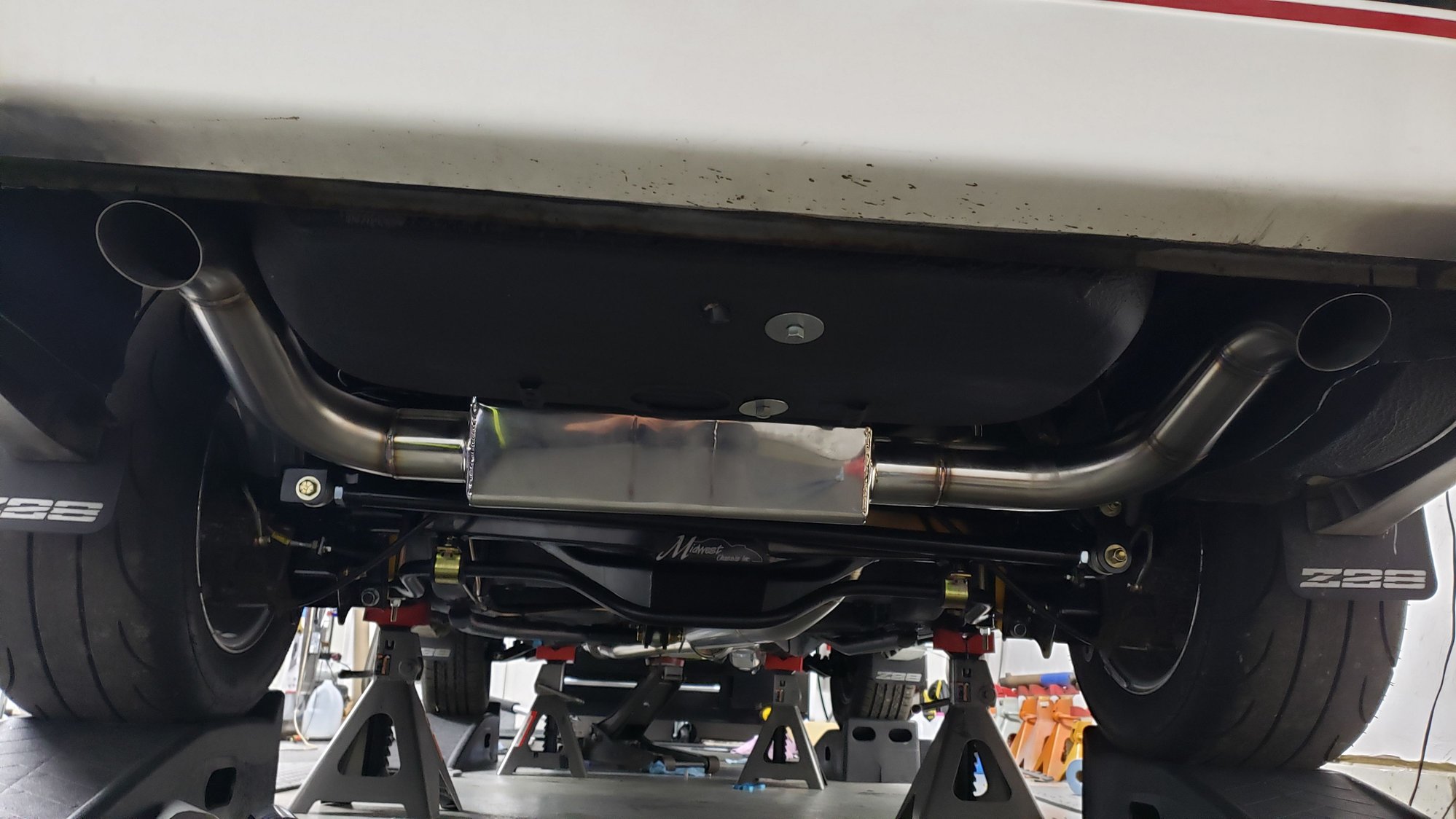

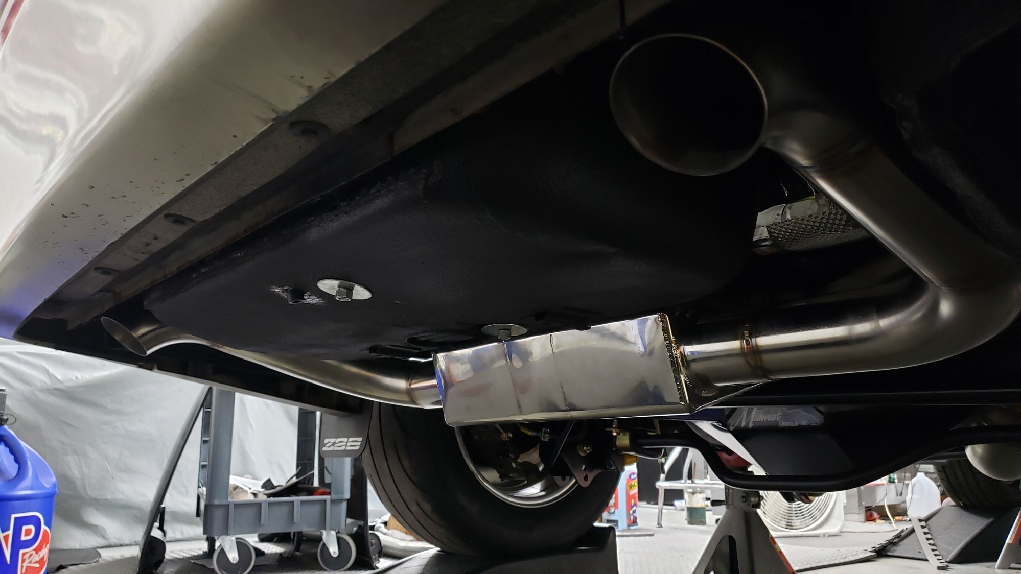

3 inch is good to around 450-500rwhp. But it's not like you are losing hundreds of hp if you are over that. It's a round about generalization number to get people in the ballpark. 4 inch isnt loud. I did it with a Spintech 364sc. 4 inch in. Dual 3 inch out hidden tips.
Short idle video. My mustang with duals is louder than this car. I think the 4 inch with the straight through magnaflow single pipe is obnoxiously loud. Those single pipe 4 inch systems I'd stay away from.

At around 350 rwhp I've shown that a single 3", namely the muffler, is definitely a restriction and the maximum output to the rear wheels in my car was trimmed. At 450 rwhp, the wheezy Flowmaster 40 series with a single 3" in and out, would be a terrible fit. Maybe a Borla or Spintech straight through design would work.
You're right in that the CFM spec is to get people in the ballpark and it's a percentage loss. Greater engine output equals greater losses.
Loud is relative and I can't say I've been beside enough 4" equipped cars to be able to comment on it other than to say, some people point out that their systems are too loud for there tastes.

I have heard the sinister single 4 and I think it's a bit loud l, like obnoxiously loud. Maybe the crossflow design may be where you want to be. Spintech makes so many different ins and out sizes. They are made to order ss. Those straight through singles, yes they are really loud. But hey if you want something simple and easy to install and that works that may be the ticket. Mufflex makes good stuff.
