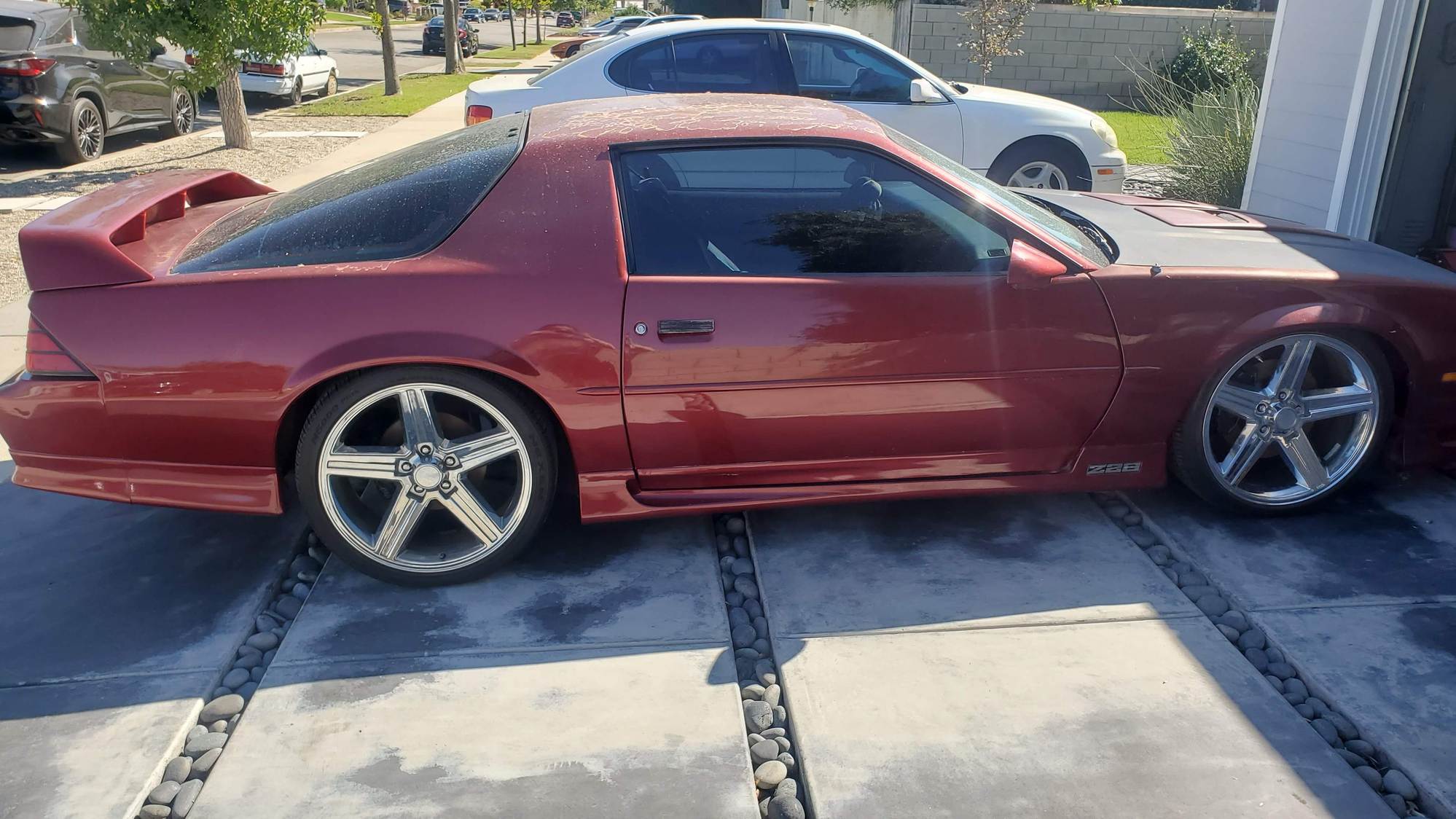

Old Mar 4, 2021 | 10:44 PM
atapia14's Avatar
Joined: Sep 2019
Posts: 42
Re: True Dual orrr
This is the culprit at hand
Old Mar 5, 2021 | 06:52 AM
Orr89RocZ's Avatar
iTrader: (20)
Posts: 25,895
Likes: 429
From: Pittsburgh PA
Car: 89 Iroc-z
Engine: 555 BBC Turbo
Transmission: TH400
Axle/Gears: MWC 9” 3.00
Re: True Dual orrr
If you have shorties you can easily run dual 3” down the stock exhaust route.
long tubes becomes the problem because of the trans subframe but its still possible to have dual 3”. I have dual 3” on my bbc car going down the tunnel to the turbos with plenty of clearance. I have run 3” down the stock location as well.
a big single 3.5-4” is also a nice setup and sounds really good
