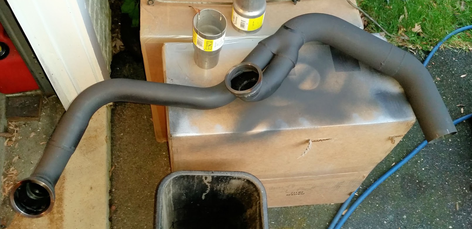

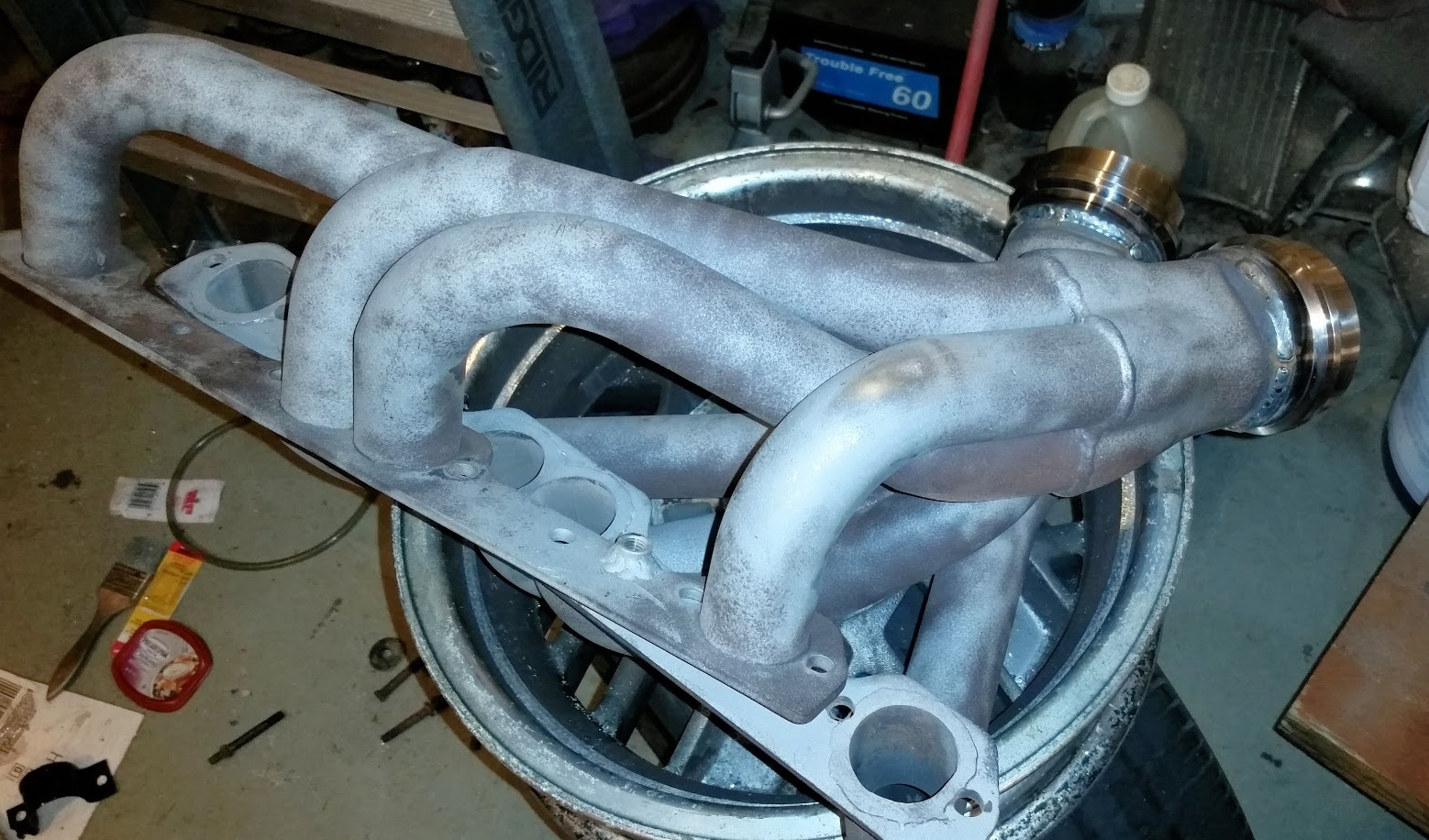

the hooker and headman "shorties" (again, they're longer than most shorties), are both decent designs, the only real difference between the 2 is the collectors exit at slightly different angles so the y-pipe has to be different. Both have fairly thin flanges and to prevent leaks make sure you use a good gasket (give it a coat of copper coat if it makes you feel better), and then snug down all the bolts a little at a time so they are pulled evenly to the flange. On the collector end, well I hate 3 bolt collectors and I cut them off and weld on v-bands.
This was probably the 3rd or 4th time this pair of headman ones were blasted and re-coated, 4th car they've been in.
Adding a v-band flange to this one.
Modified y-pipe I made for this set. It looks kind of rough but that's mostly because the high temp paint is still wet in places giving things all sorts of different textures/colors.
