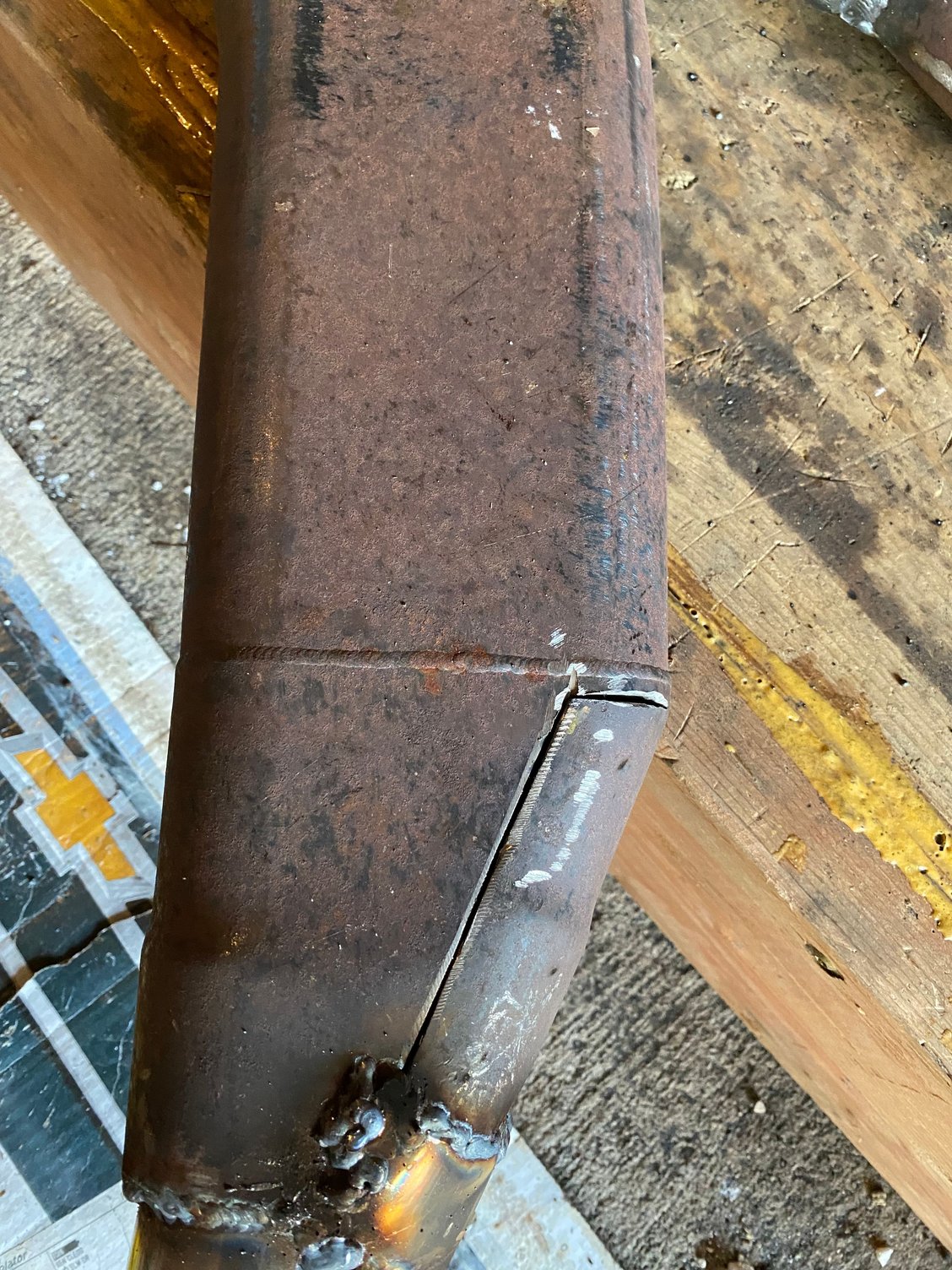

Note where I cut the pipes and put in an angle to fit the collector width
I flattened the tube a bit so it fit in the oval bit
It ain’t going to be pretty. More work is required to get it proper
Made a transition on the oval pipe itself by cutting a wedge out of it

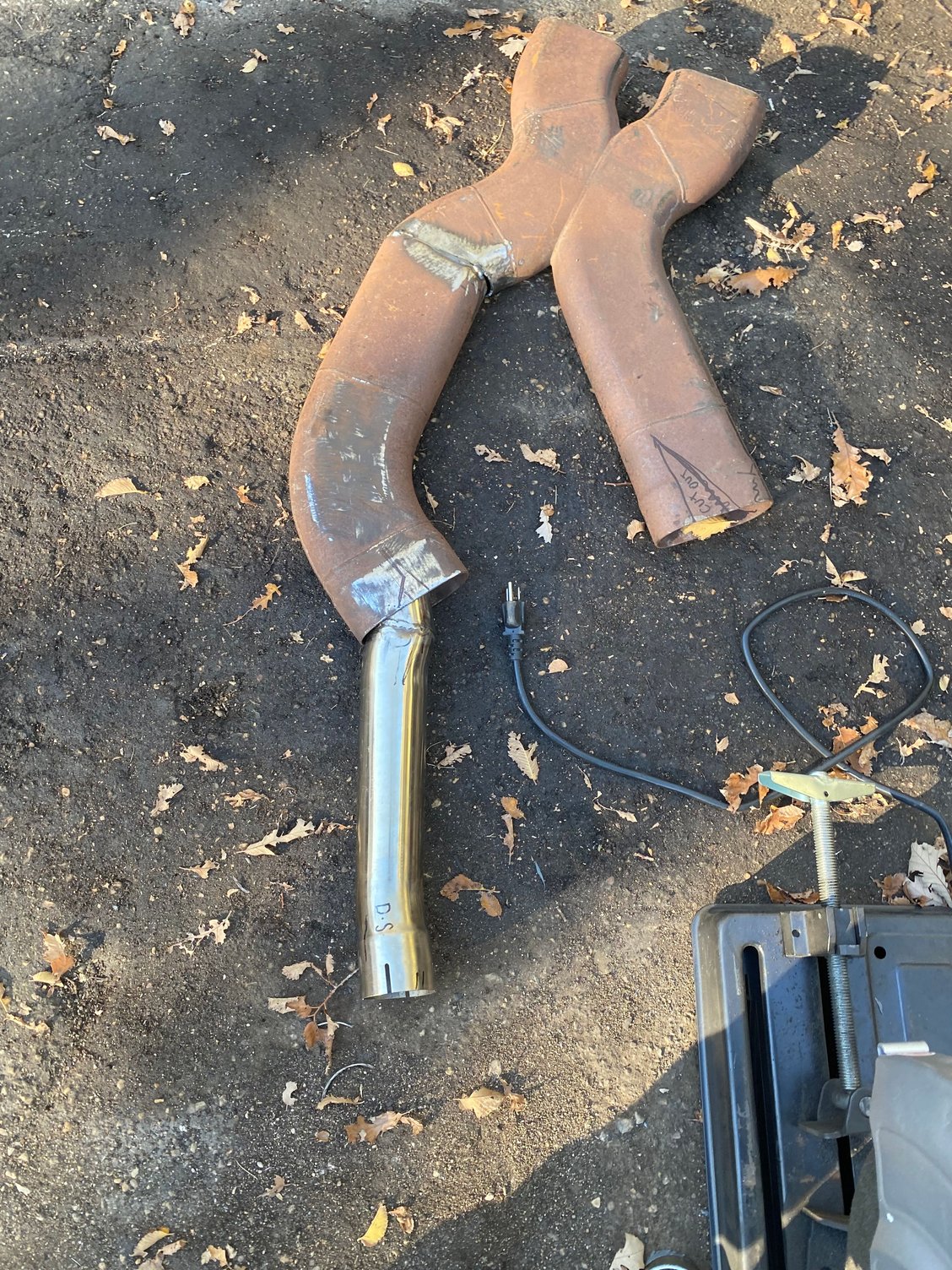

Stage 1, getting the X pipe to fit on the collectors.
Stage 2, fitting the boom tubes to the X pipe/collector assembly.
It’s finally in position! I’m ok with how it worked out. It’s not perfect but it will work as intended
