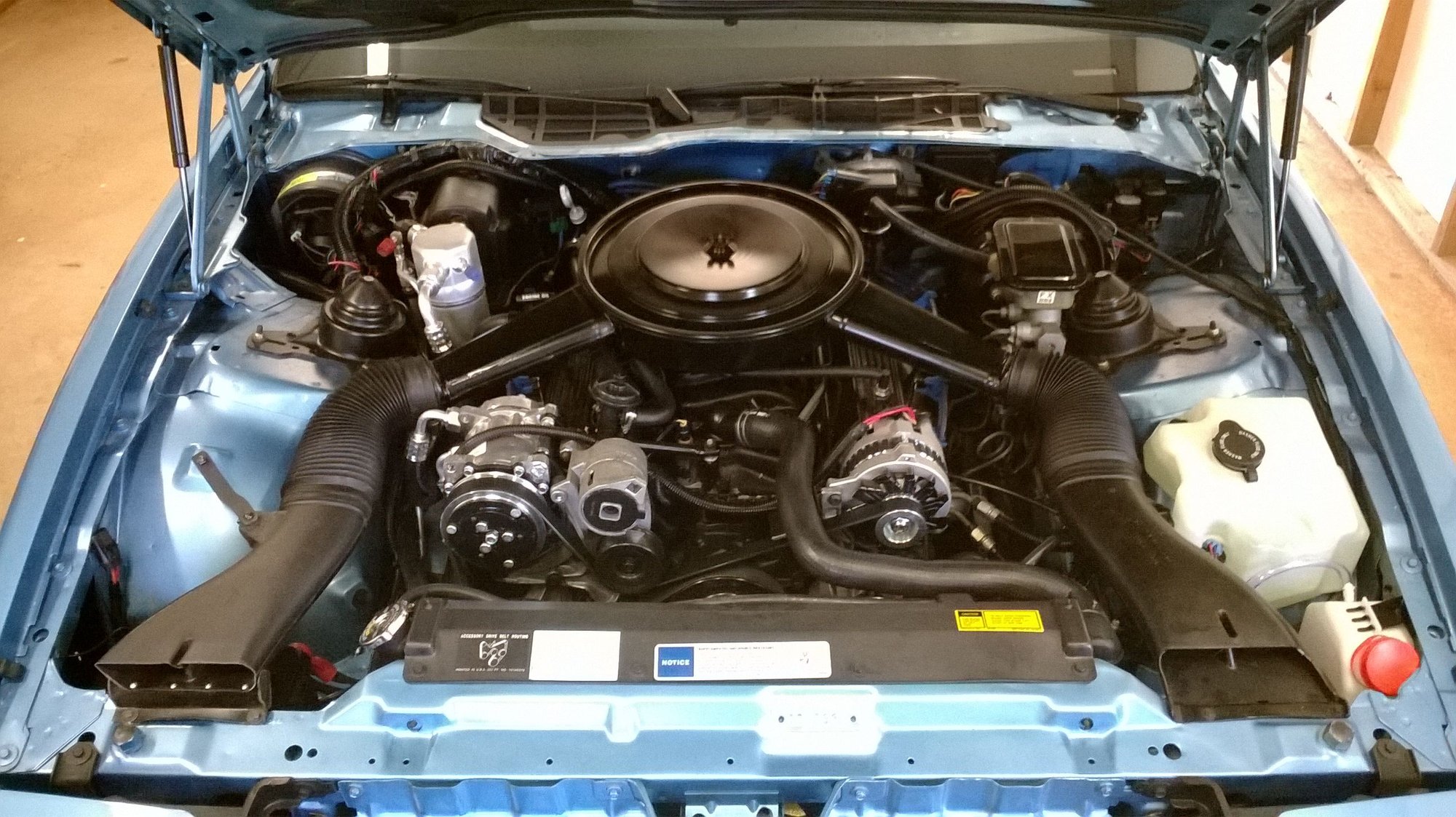

FWIW, before I converted to TPI, this is what I "fabricated" for my TBI Formula:

That's pretty sick looking. Very clean bay. Jealous on this end. I have alot to do before I get there!!! I have a lot of grime and rusty parts to clean and paint. I'll get there.
