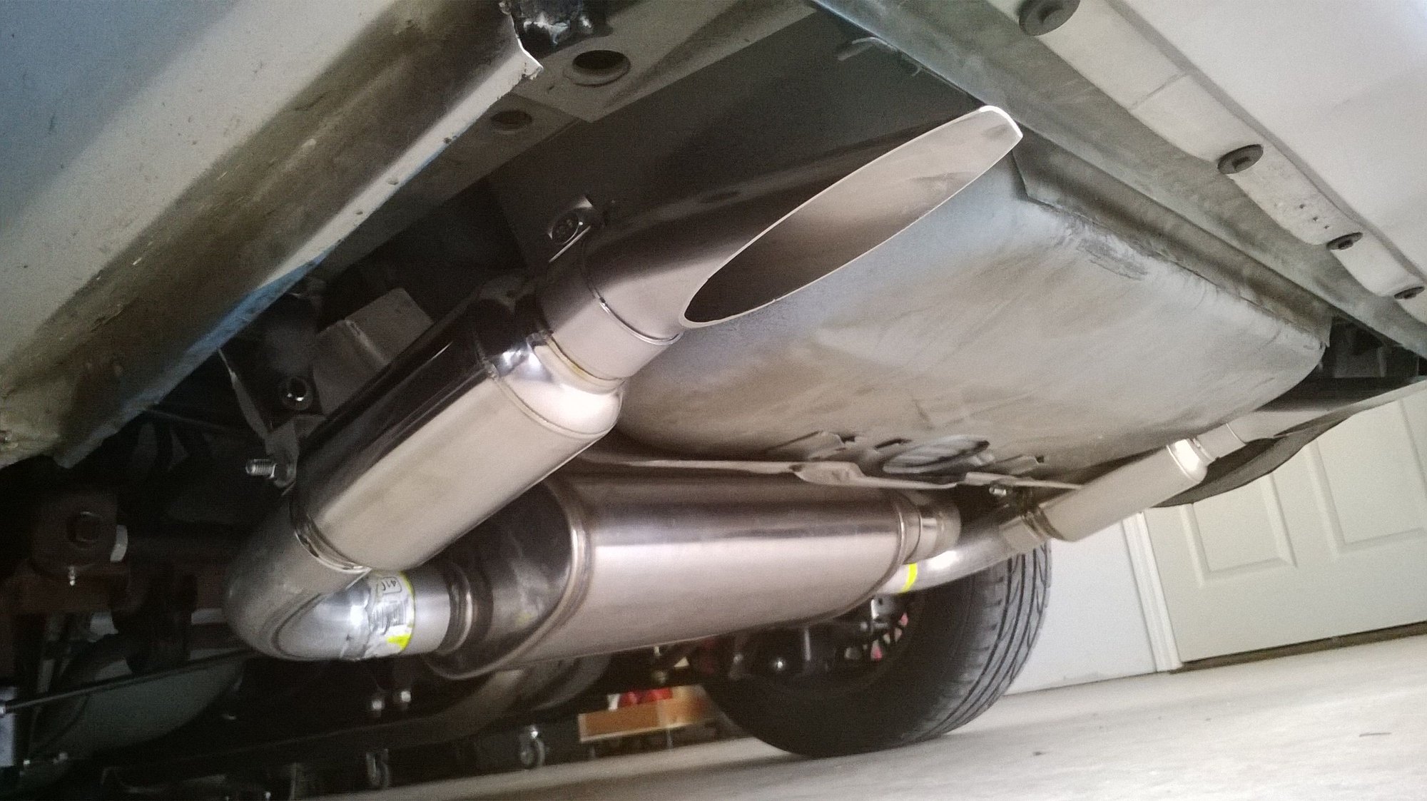

For stock appearance, I just got a couple of 30-degree, 2-1/2-inch stainless and angle cut them. This is a Magnaflow muffler to which I added some small resonators. Swapped the Magnaflow since to a Dynomax Ultraflow. Makes noise when you get into it but no drone on the highway.
