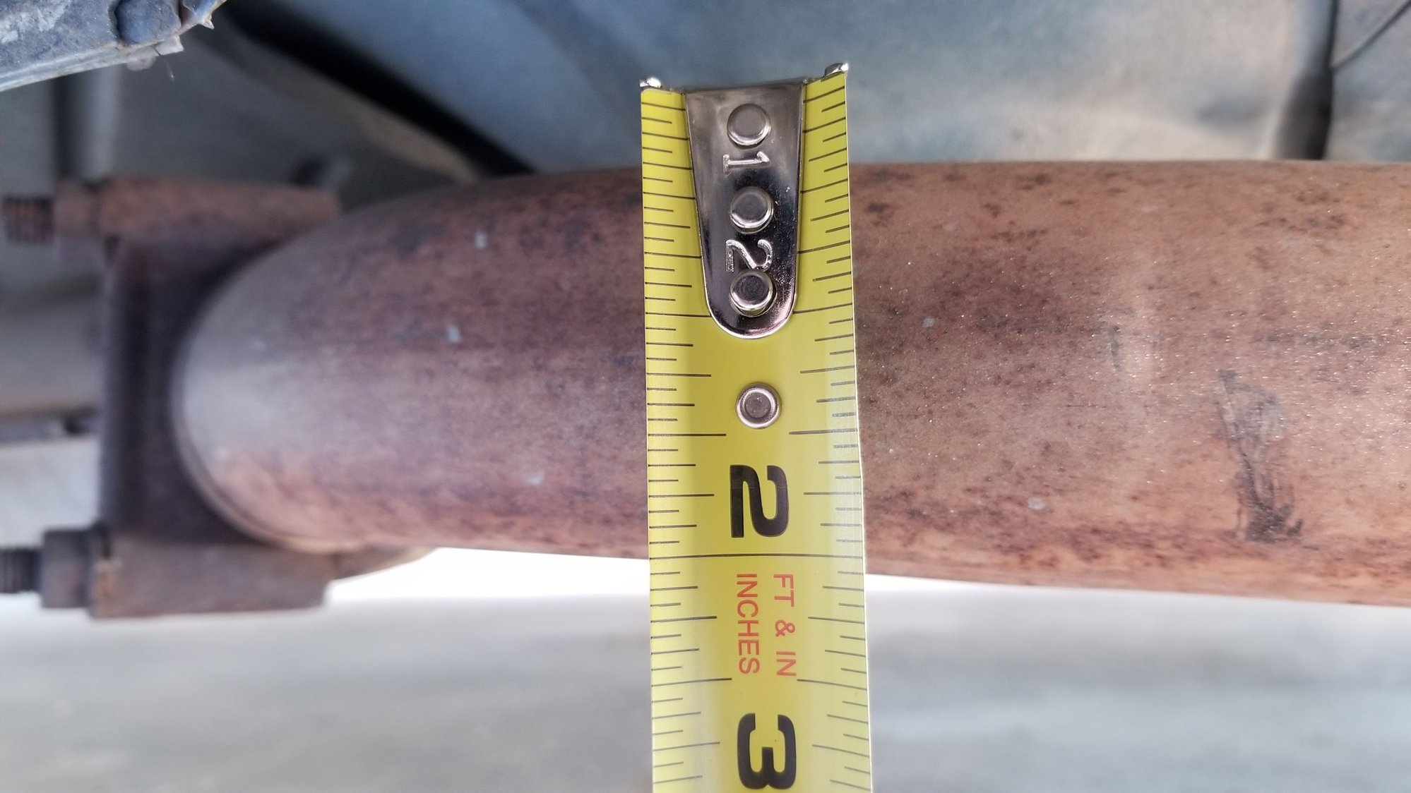

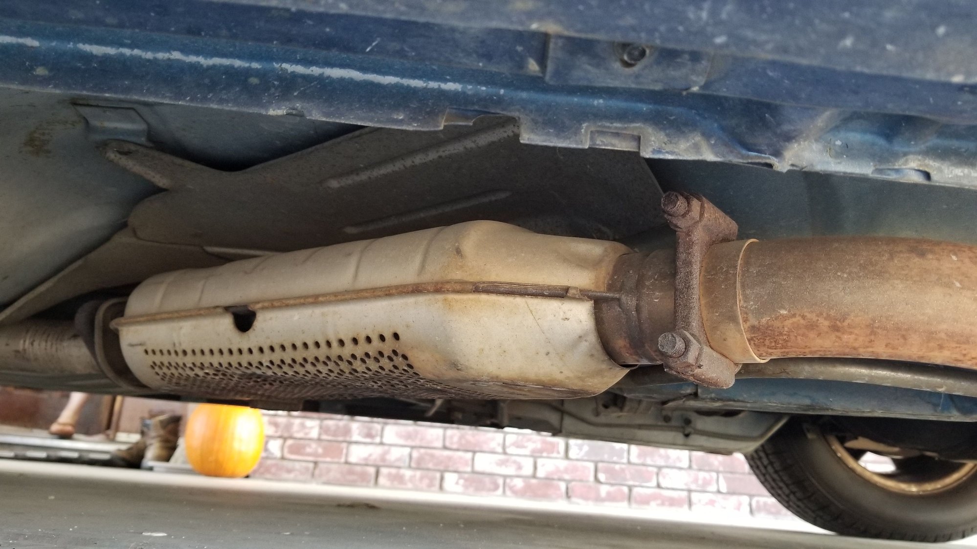

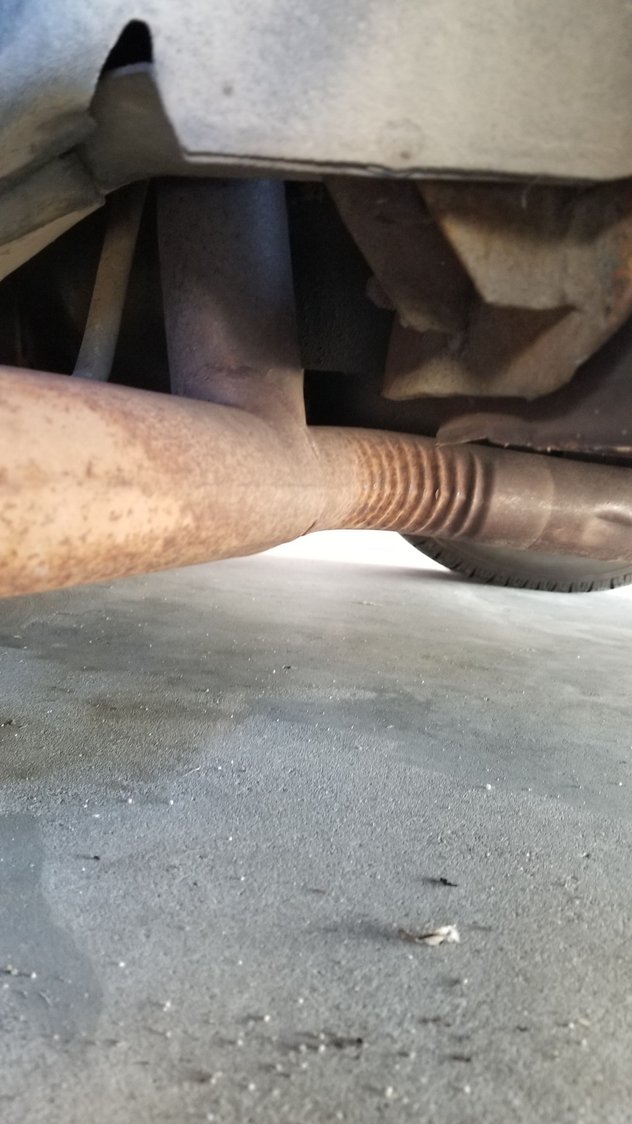

Do I have stock exhaust cat-forward?
I recently bought a manual, 305 TBI RS and am trying to figure out what has been done to my exhaust. It looks like the previous owner has added 2.5" cat-back pipes with a Magnaflow muffler, but I don't know if everything from engine to cat is stock. Can you take a look at my pics and let me know what ya think?

Re: Do I have stock exhaust cat-forward?
Looks to me like it is all stock except for the Magnaflow muffler.
Gotta love GM's "T" pipe posing as a "Y" pipe! You have the stock 2.25" single cat LO3 exhaust from the muffler to the engine. You can see where they welded an adaptor into the muffler for the smaller exhaust pipe.

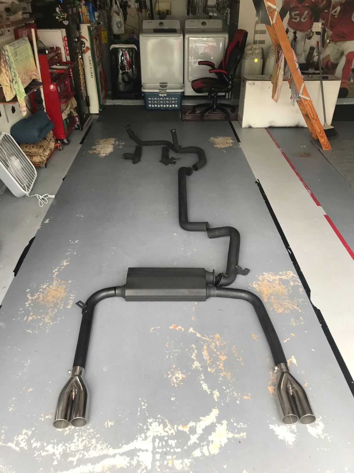

Speaking of making it look nice and on the cost of a complete system below is a picture of my system.
Those are the L69 manifolds, $50 form a member here and they already had the air tube plugs. Magnaflow Y-pipe, $200 at the time I bought it. 3" "test Tube" made by a shop (not pictured) $125. I don't run a Cat. Hooker Super Comp 3" Aero Chamber cat back system, it included the SS quad tips, $425 at the time. 4 cans of VHT Flameproof spray ceramic coat to coat the whole system, $75 at the time. Manifold gaskets $10. After I prepped the system I had a shop do the install. The Hooker system is mostly slip fit and I wanted it all welded. Cost from my shop for removal of the old system and install the new and weld it up was $550.
My Total came to $1435. From the research I did my approx. HP gain is 30. From the same research the estimated gain if I went with headers would have been 5-10 more. That's why I went with finding the manifolds. A good set of coated headers run around $500 (not including y-pipe) which ended up being 10X the cost. I didn't feel 10 HP max gain was worth the cost.
The seat of your pants feel and the sound of a 3" system made doing the whole thing worth every penny IMHO.
