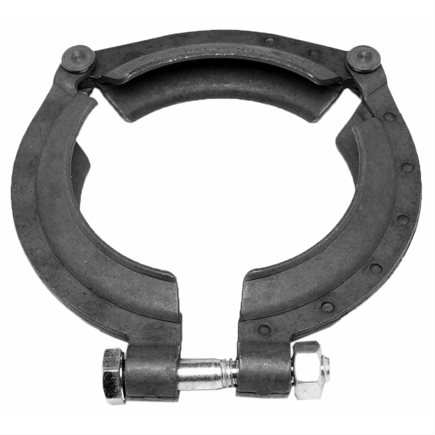

Pictured below is the Walker/DYNOMAX Performance Exhaust Clamp 35430. I ain't seen one of these in years. It connects the N10 dual cat Y pipe to the intermediate pipe. Spray the nut and bolt with rust penetrant good a few times and let it soak in well. If it doesn't want to budge put some heat to it or cut the bolt in two and replace the nut and bolt assembly. Make sure to not mess that clamp up. This is the clamp for the N10 dual cat exhaust that everyone calls the "Hog Clamp". It looks like a V-Band clamp but I don't think it exactly is one. It's also for 2.75 inch pipe. The wider cutout at the top left of the "Hog Clamp" indexes the two mating pipes to each other.
If you carefully measure, mark, and cut everything just right and do a nice job welding everything together the new Magnaflow cats will look like they came factory installed on the OEM GM N10 dual cat exhaust system.
You can carefully remove the flange on the inside convertor that attaches to the N10 specific transmission bracket/hanger assembly and weld it on where it should go.
Don't screw up the N10 transmission bracket/hanger assembly. They are specific to automatic or 5 speed N10 systems. So there are 2 of them for N10 systems and the transmission brackets/hanger assemblies from any of the single cats systems are totally different.
