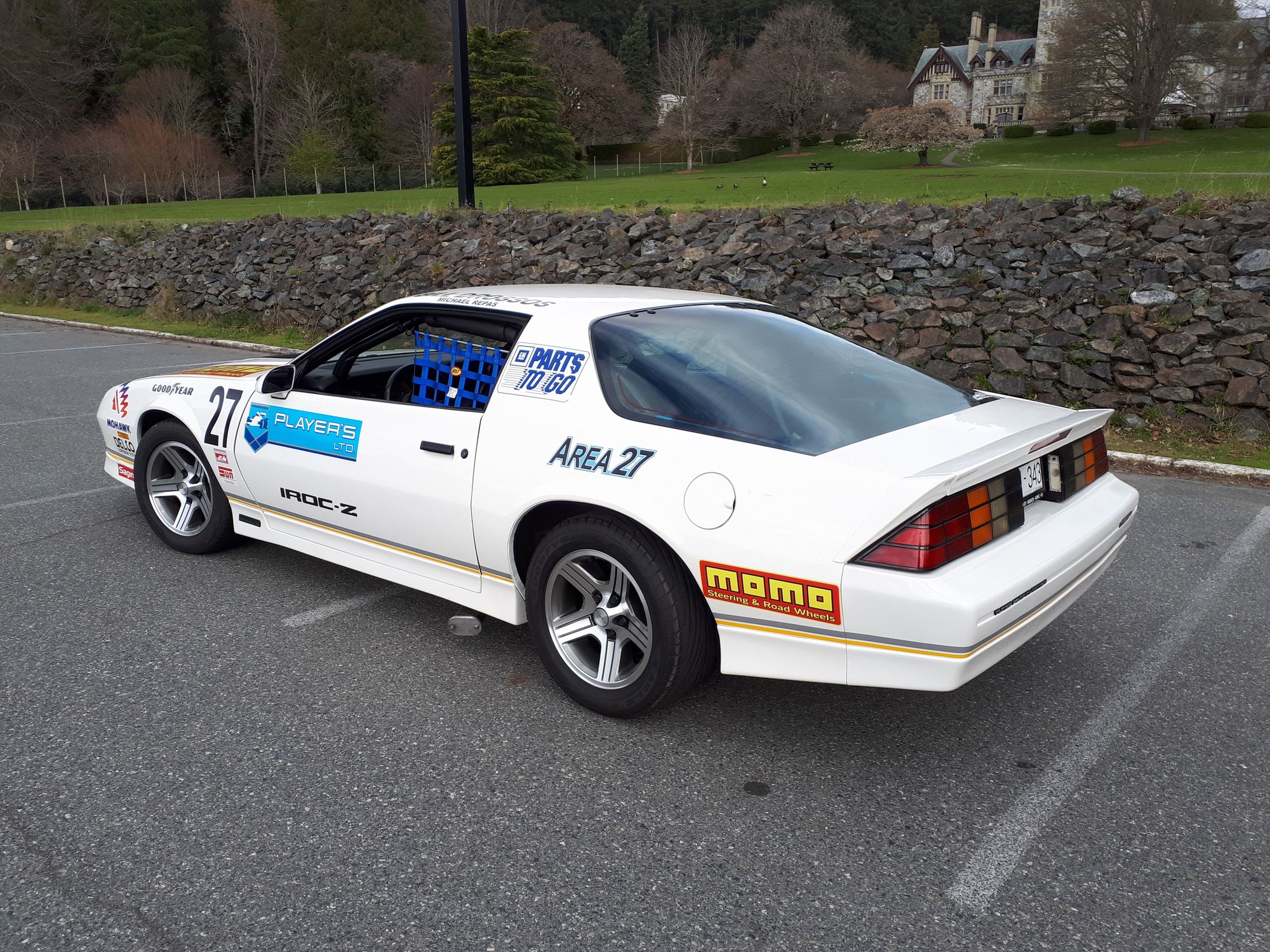

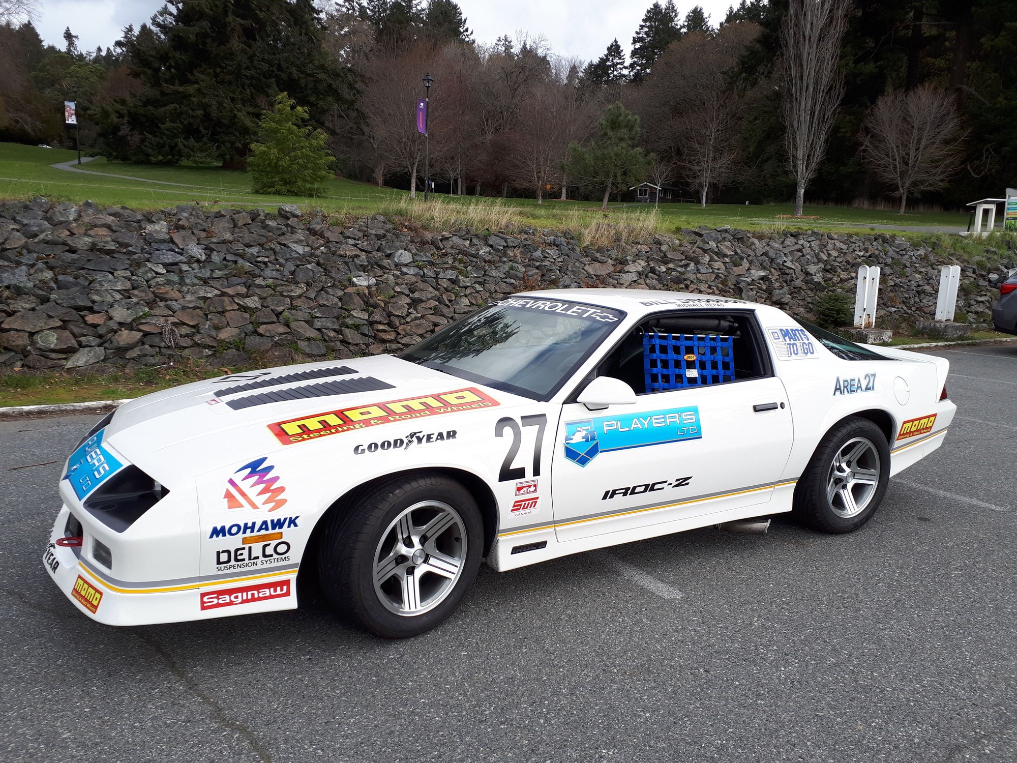

The players cars from the race series had those side exhausts you mentioned. I knew a couple guys that had cars from the series after. Fixed back up for road duty (althought they were fairly road worthy while racing) and still had the exhausts. Side exit in front of the back tire. Sounded good, actually not too loud and did look good on the cars.

I saved this photo from a post on this forum. Supposed to be a Players system.

This is the system in DynoDave43's picture above.
