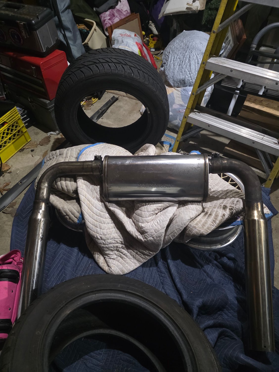

I have been spending all night researching options to choose for my exhaust manifolds and matching y-pipe and wanted to get someone with more experience (this is my first ever project car) to help me decide what makes the most sense for my situation. I have an 88 trans am 305 tbi with full stock everything. The current old manifold on the driver's side is leaking like crazy, so it needs to be changed anyway. I am currently between upgrading to the bigger stock manifolds from the TPIs or finding a header set that would be in a reasonably close price range to that. I know my car won't make crazy power numbers, so I am not concerned with increasing HP a ton. Mainly looking at something that will be fairly straight forward to install and not cost an arm and a leg.
- For a header option the hooker 2460s seemed reasonably easy to install but the y-pipes I have found that go with it seem a little expensive for my price range currently.
- For a more stock option, the Dorman OEM manifolds and walker y-pipe on rockauto seem decent enough just don't know if they will fit or be too restrictive.
The main sound output I am looking for will come from a great deal on a Magna flow muffler with tailpipes I picked up. The guy I bought it from cut off the inlet flange so I can weld on either a 2.5in or 3in connector to fix that. This will depend on what you guys suggest I shoot for for overall exhaust system diameters. Any help would be greatly appreciated let me know if you need more details on my situation. Also, I'd like to remove the smog AIR stuff eventually if that determines anything.

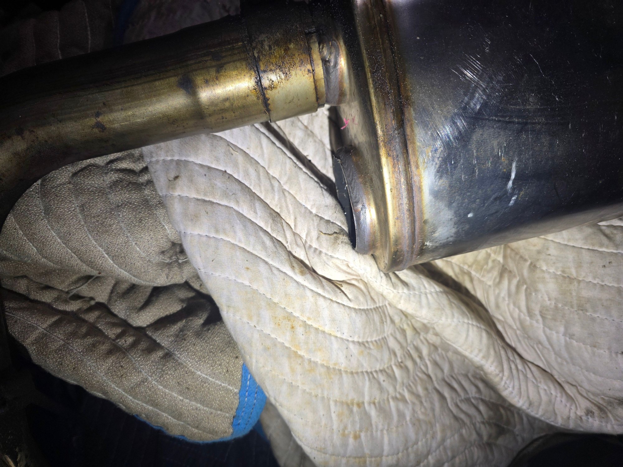

Can you post us up a couple of pictures of the Magnaflow muffler and tailpipes you got so we have an idea what you are working with? Mainly so we can see where and what was cut off.

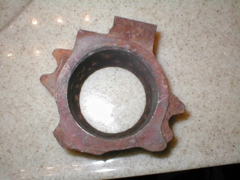

If using Dorman, make sure you locate the correct cast iron spacer that does not come with their right side manifold. I found one on EBAY (lucky) and it fits the Dorman manifold perfectly. They need to reproduce this! Are you listening Dorman?

What is this spacers part number/look like? Also how crucial is it to have?

you can re-use your existing spacer, it will likely just be a bit narrower

The HO manifolds bolt right up to the motor no problem. You'll need the cast iron spacer on the passenger side. Your existing spacer might bolt up (it's been a long time, I don't recall), but the ID will be narrower, kind of defeating the purpose of the larger manifolds. Use the 3" Y-pipe and 3" intermediate pipe and connect to your Magnaflow muffler/tailpipe setup.
