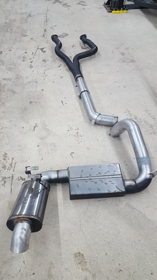

I had brought an iroc with an lsx 454 to mufflex and told them I wanted it quiet. They installed both a spintech and a magnaflow right after it before it dumped at the back bumper.
they installed 2 on it at the same time?
do you know where? cause there's very little space. I have the spin tech on it now and you can't hardly talk to a passenger inside.
huh.. now that's interesting. never thought there would be room for something like that.
and it made a good difference from the spin tech alone?

Idk what the spintech alone would of sounded like alone with the LS. I would assume deafening. This was done back in 2017. 2 years later I had gotten the same setup with the spintech alone installed on a 383 and standing behind the car was crazy loud. This dual muffler setup honestly sounded slightly above stock to me.

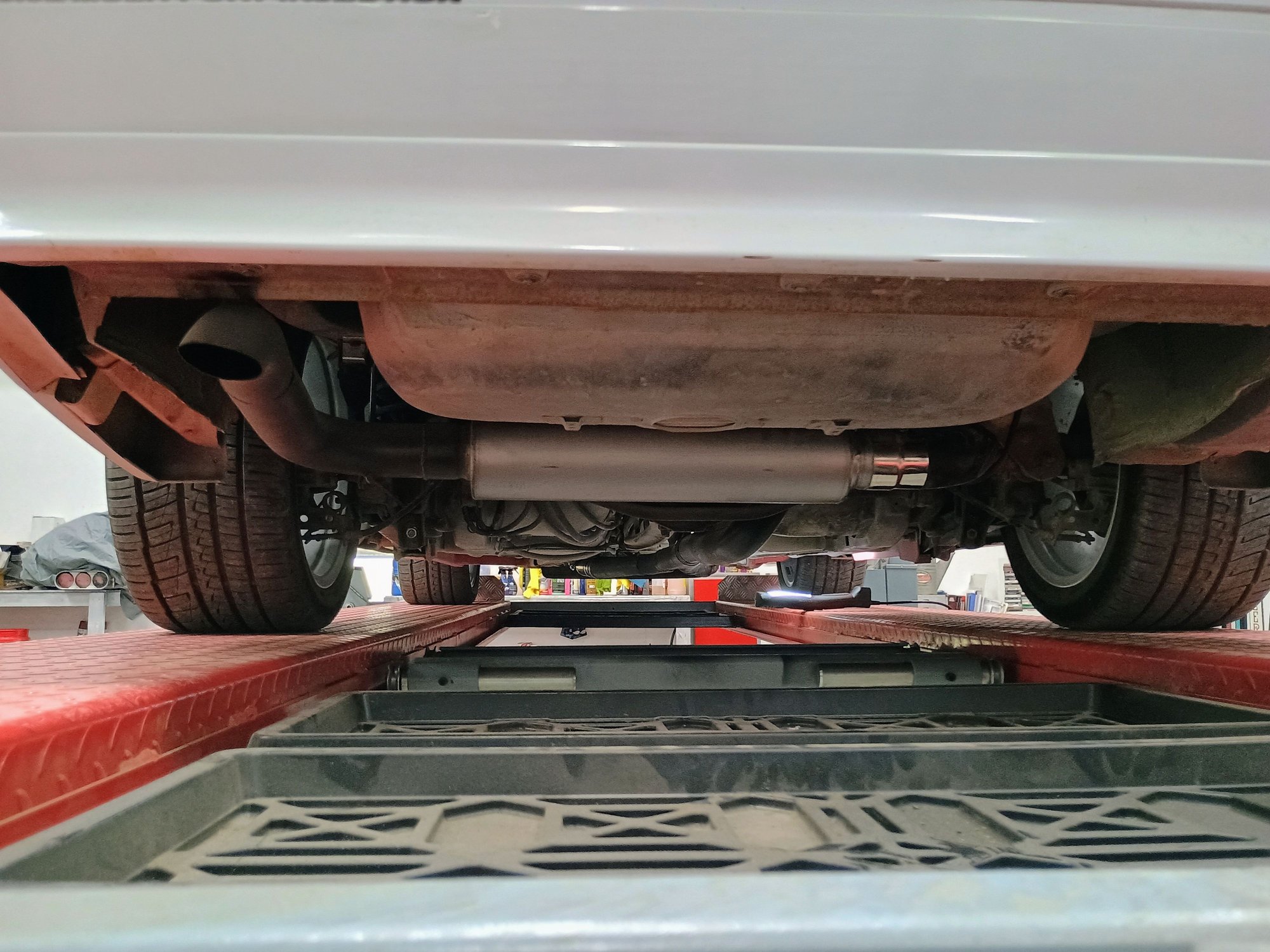

I wonder if you could plumb two C6/7 muff's under the rear bumper? In the location where the oval SS muff is in the pic above...

I just happen to have a set of the base nnp c6, the zo6 nnp and the 8-4-1 valved muffler. I don't really see how any would work in the cross flow muffler place.
They wouldn't . They'd have to go in the locations just inside the rear bumper, like where the muffs are located on a C4 'Vette. IDK if they'd it there, either. They are big.
