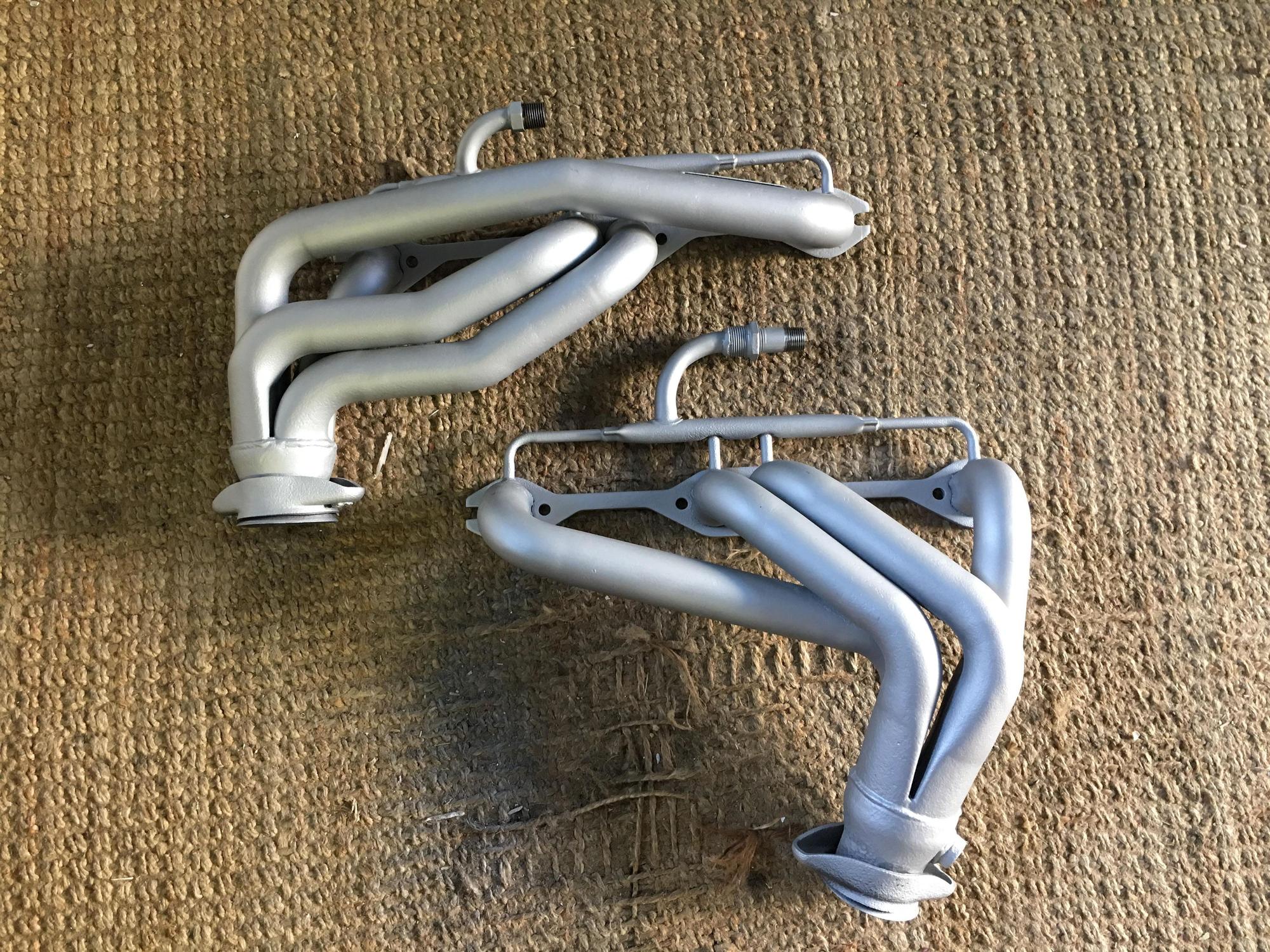

Are you sure about those part numbers?
Are these the Edelbrock headers you have?
Edelbrock 6872 Headers

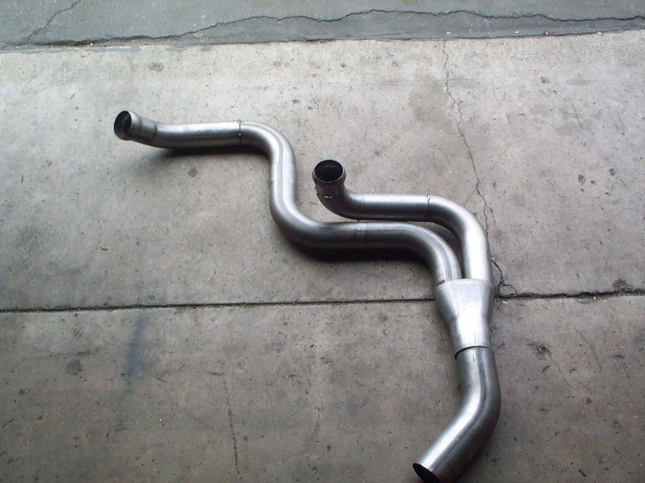

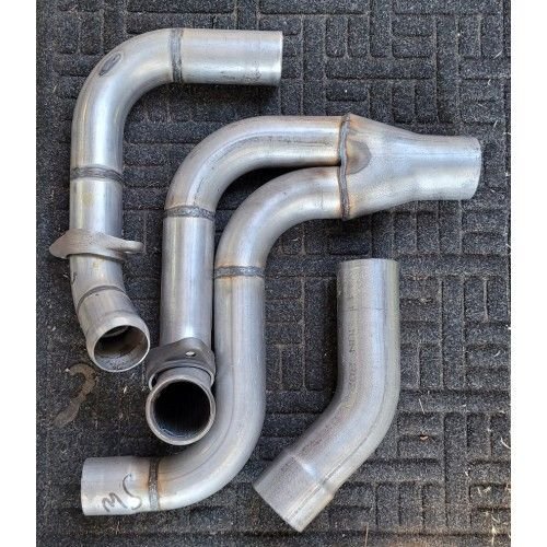

@Dyno Don Makes single cat and dual cat replacement Y-pipes for Edelbrock TES headers.
Dyno Don's - Single-cat Y-pipe for Edelbrock TES Headers
Tack welded mock up without loose exhaust flanges installed of Dyno Dons single cat replacement Y-pipe for Edelbrock TES Headers.
Tack welded mock up without loose exhaust flanges installed of Dyno Don's single cat replacement Y-pipe for Edelbrock TES Headers.
Dyno Don's - Dual-cat Y-pipe for Edelbrock TES Headers
Dyno Don's - Collector for Dual-cat Exhaust

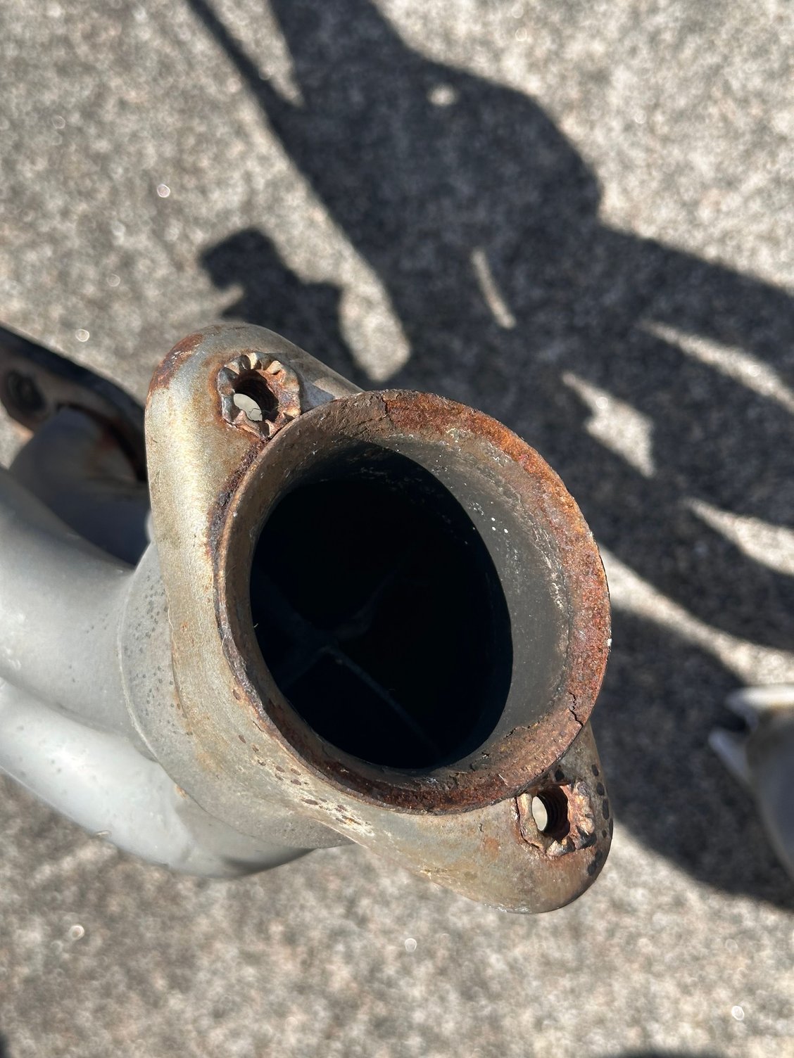

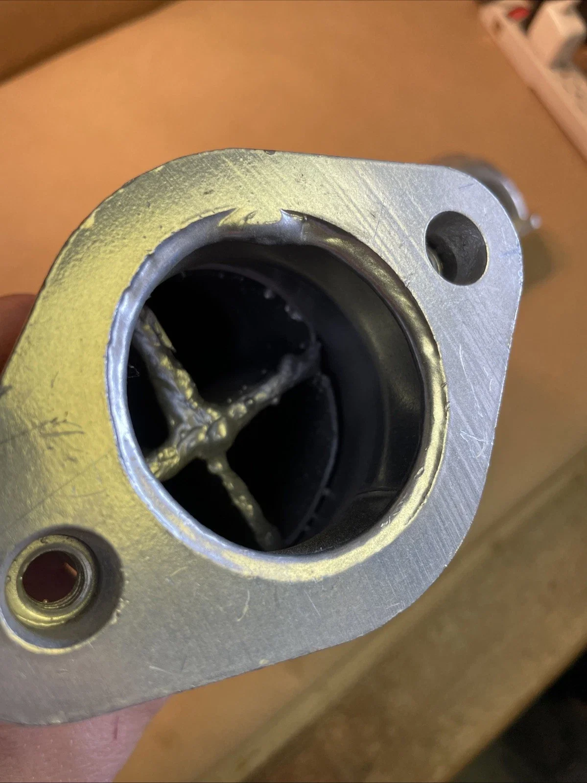

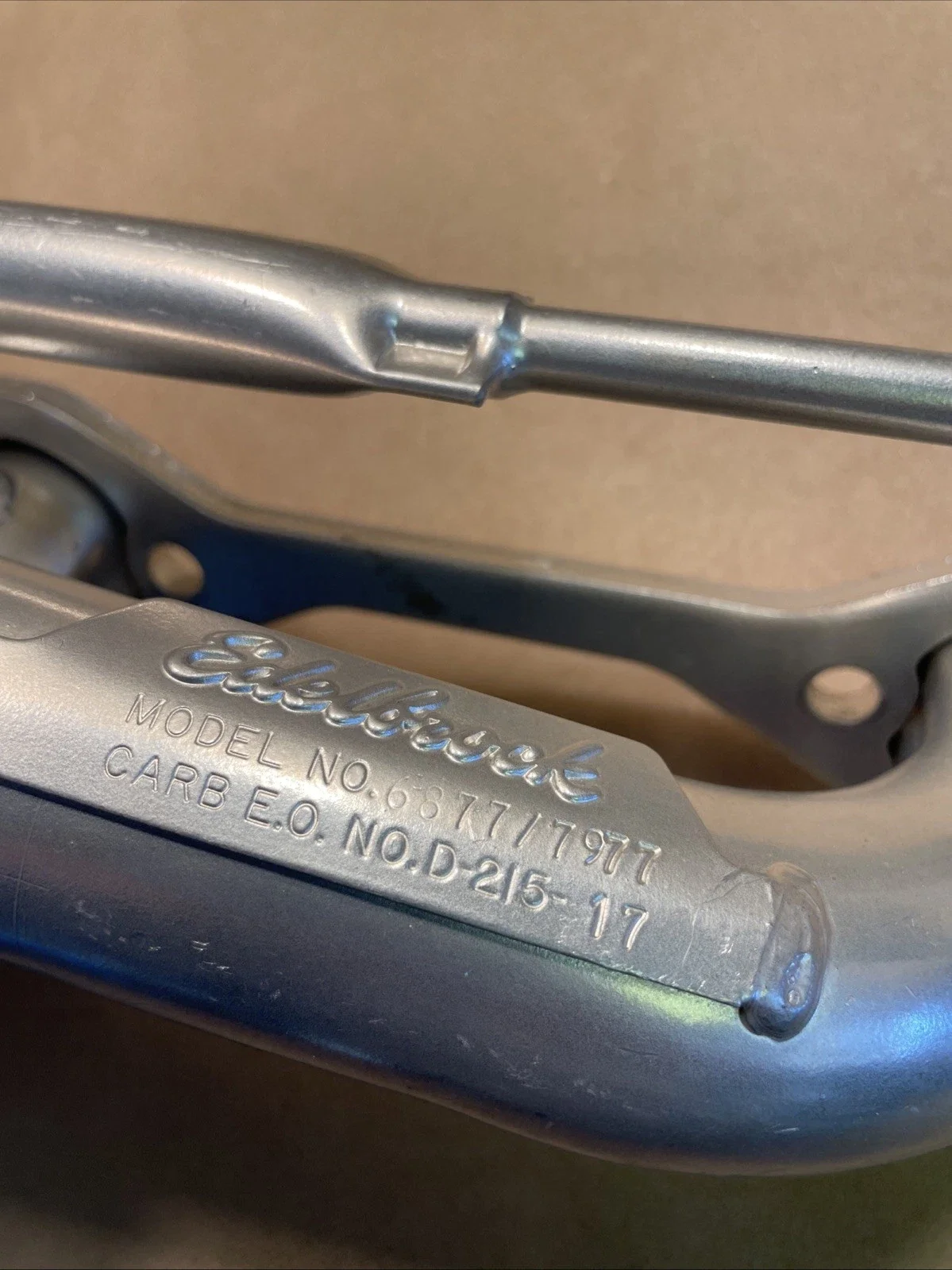

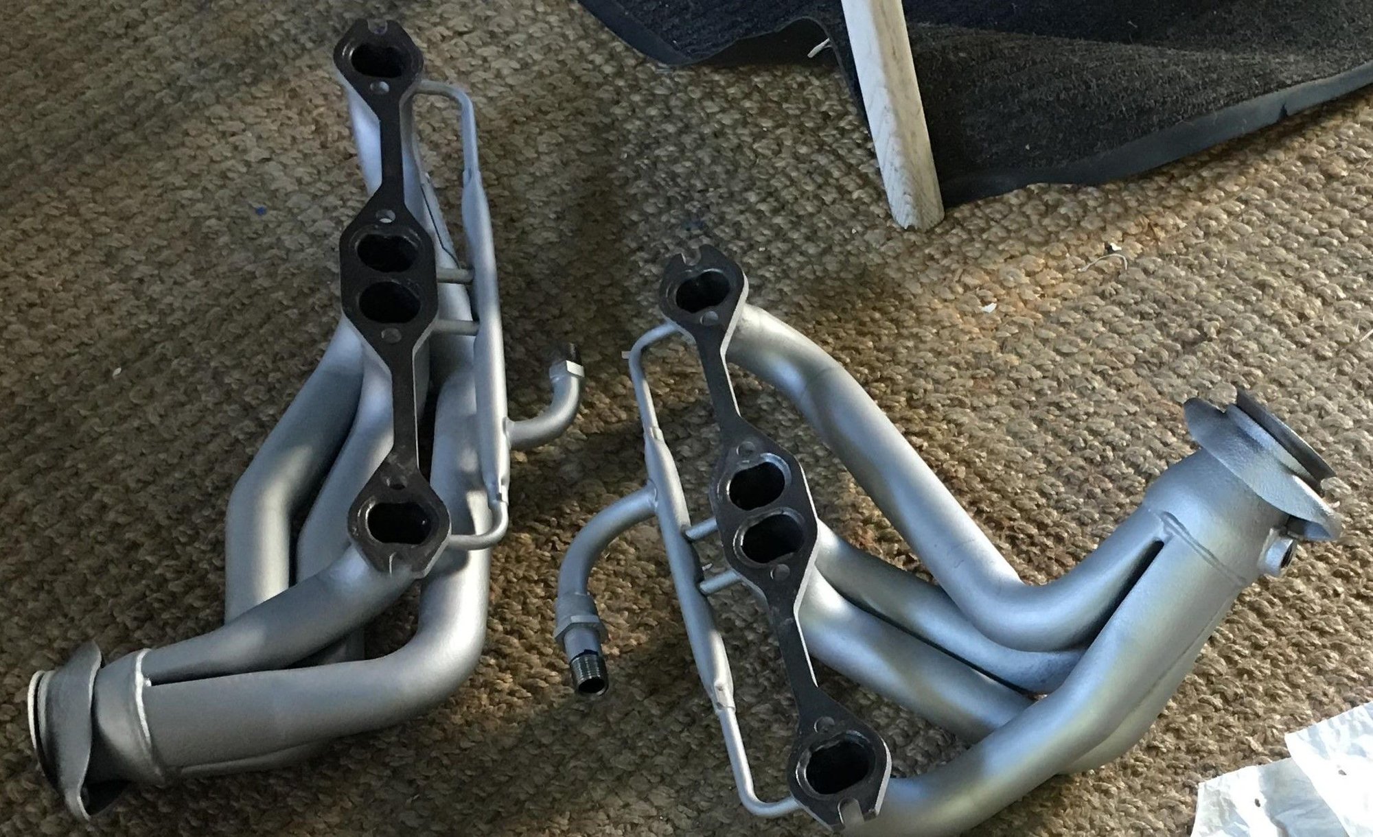

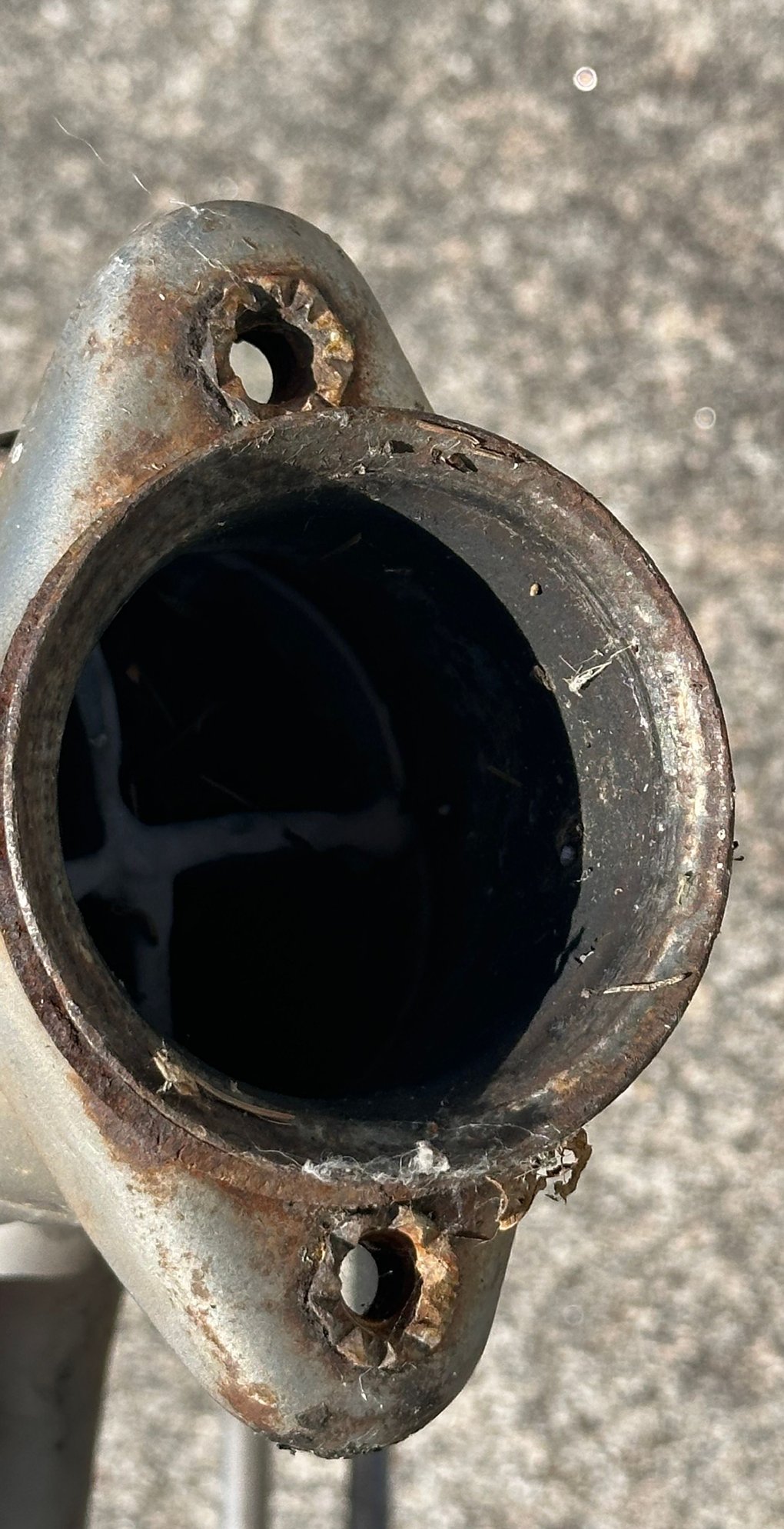

I found the Edelbrock 6877 / 7977 headers you have.
Those Edelbrock 6877 / 7977 headers with that style exhaust flange aren't going to work with @Dyno Don replacement Y-pipes for Edelbrock TES headers. If they exit pretty close to where the Edelbrock TES headers I posted above do then the Dyno Don's replacement Y-pipe for Edelbrock TES headers might could be modified by an exhaust shop to fit them with different exhaust flanges welded in place.
Edelbrock 6877 / 7977 Headers
This style exhaust flange will not work with Dyno Dons replacement Edelbrock Y-pipes.
This style exhaust flange will not work with Dyno Don's replacement Edelbrock Y-pipes.

1. You can't read and you have the Edelbrock TES headers from the Edelbrock TES kit #6872 7972. LoL
I think the 6872 is the header part number and the 7972 is the Y-pipe part number.

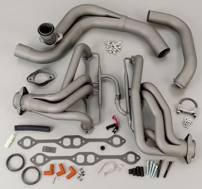

Edelbrock Tubular Exhaust System 6872 7972 Chevrolet Camaro IROC & Z28 and Pontiac Firebird Formula 1986-89 5.0L & 5.7L V8 TPI (Single Cat.)
Spoiler
Below are pictures of what your Edelbrock TES kit would have looked like when new. I also including a picture of the same kit but with a different coating.
2. Your Edelbrock TES headers are compatible with Dyno Don's vastly improved Edelbrock replacement Y-pipe. His redesign of the Edelbrock Y-pipe eliminates the trouble prone donut gasket connection between the headers and the Y-pipe and updates it to a gasket less ball & socket connection. The Y merge on his Y-pipe flows much better than the crimped down Y merge on Edelbrock's original Y-pipe.

The carbed cars, and others that used a "dummy", needed that flat flange to fit to the EFE valve. Without that, no CARB EO #. Not sure what all ones used a "dummy" (valve body w/o the flapper valve) butt I'm pretty sure they were common during the same time frame that carbs were still available, i.e. up to 87 more or less.
The TES for my 83 L69 was made that way. I agree, the headers themselves were pretty decent; butt the Y-pipe was from hell. Looked like it was made by a tribe of monkeys taking a break from trying to f*** a football.
